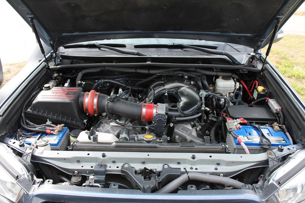

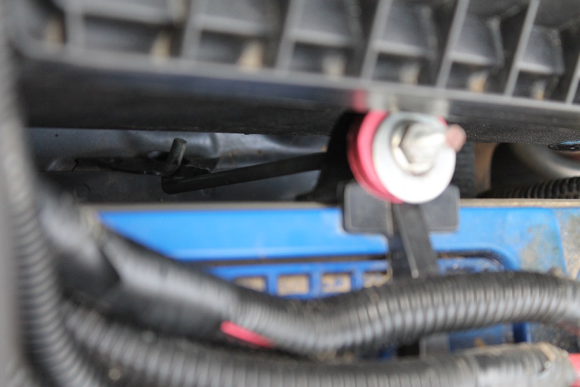

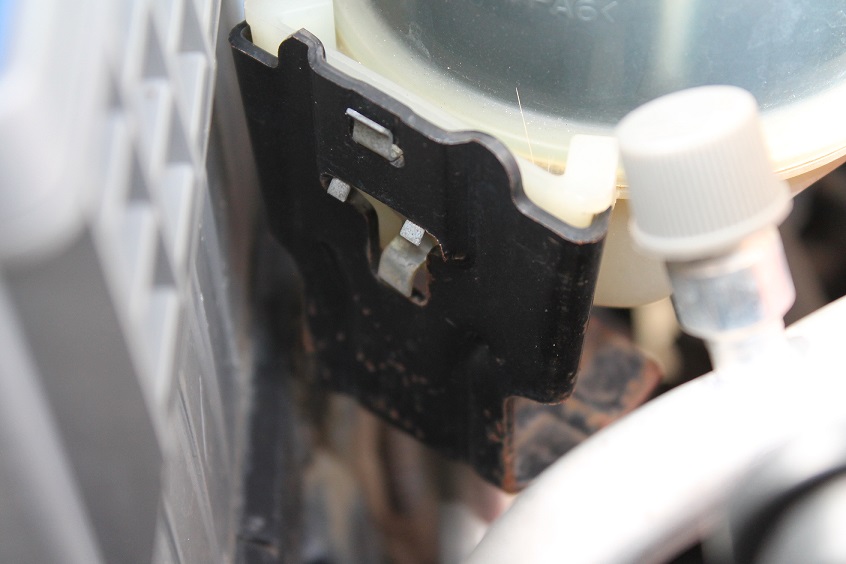

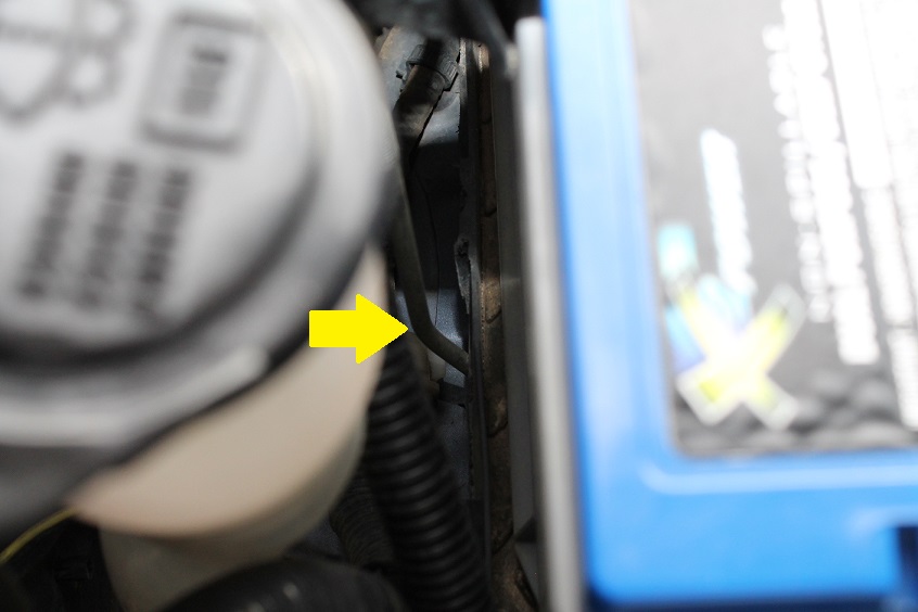

This is what I did with my secondary House Battery.
Attwood marine Battery Tray:
I didn't use the hold down included with the Attwood.
I modified this hold down to work in the factory hook slots already in the fender well.
I had to bend the front hook a little as the slot is under the tray about a 3/4". (yellow arrow)
I also modified the factory bracket for the power steering res and fastened it under the battery tray.
I threw some cheap non skid from harbor freight under the battery
