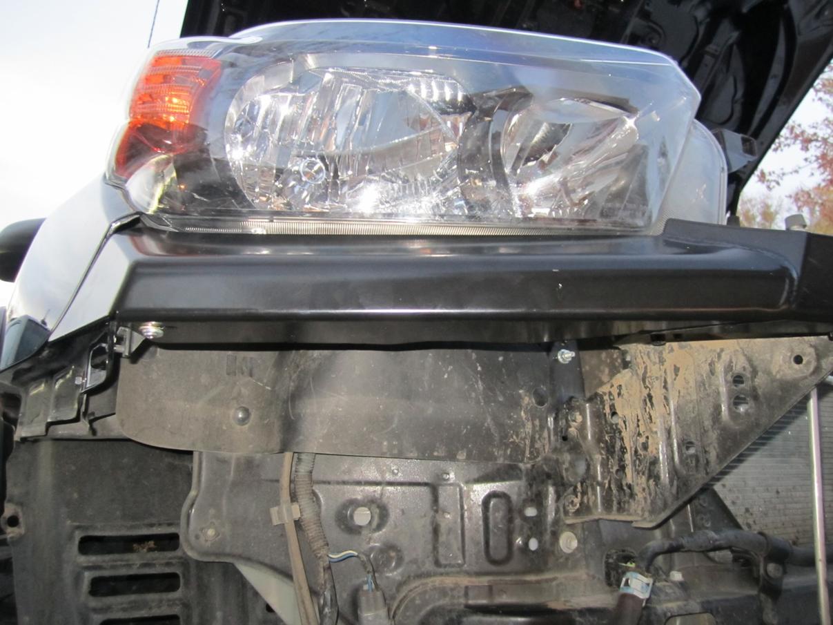

Do you guys know if the pieces under the headlights can be easily installed after the bumper is attached? I plan to paint those pieces to match the body color of my truck but I don't think I'll get them back before the day I plan to install the bumper.
It would be impossible to install them after the bumper was already on. They're actually kind of a pain to install and you need to squeeze in the area where the bumper would be to get to the screws. I attached a pic of the trim pieces that install before the main bumper. You can see the screw on the bottom left corner which you definitely couldn't get to if the bumper was already installed.

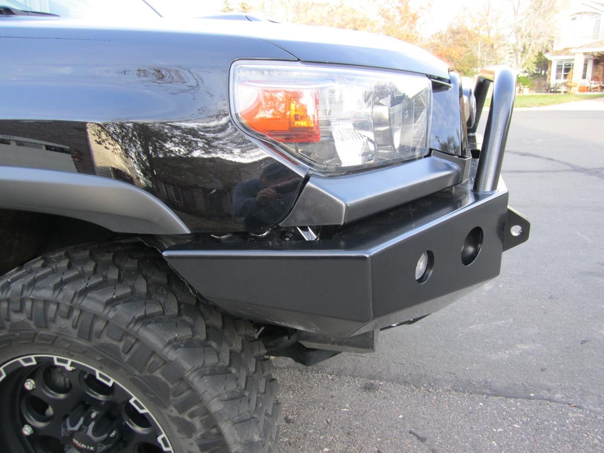

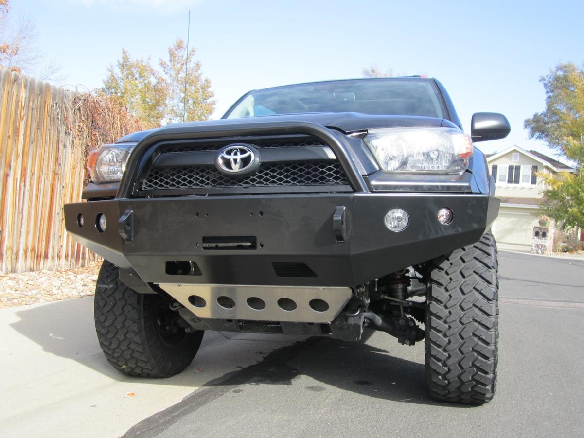

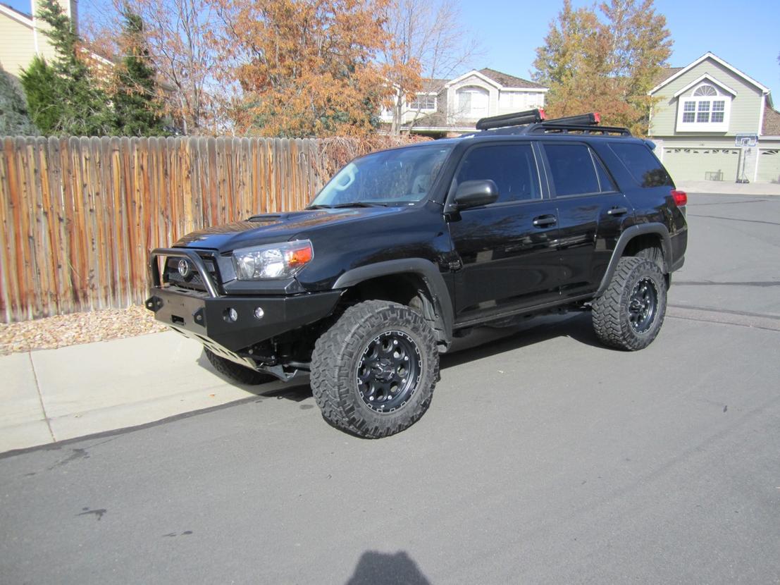

Heres some pics of mine installed. I opted for just the center hoop.

Question for those lucky S.O.B's who have the bumper installed :bigok:
How does the under-headlight-insert match up to the fender? in the two pics that sorta show the front view it looks like there is a bit of a hole between the SW piece and the fender. Looks like it may be a source of wind noise 9whistling) or dirt and water trapping.
I know Jim put a lot of thought into this, so I'm hoping it's just the angle of the pic, but any detailed pics of that area and feedback on how the body panel gap is would be appreciated.

The only wind noise i've noticed was the trimmed fender banging against the bumper... which only required me to cut it a bit more. I have not noticed any noise from the trim pieces.
As you can see in the picture, they are not absolutely perfect, but if you mess with the amount of washers that are between the trim and headlight holes or move the part around that stabilizes the trim pieces, you can dial in the fit.

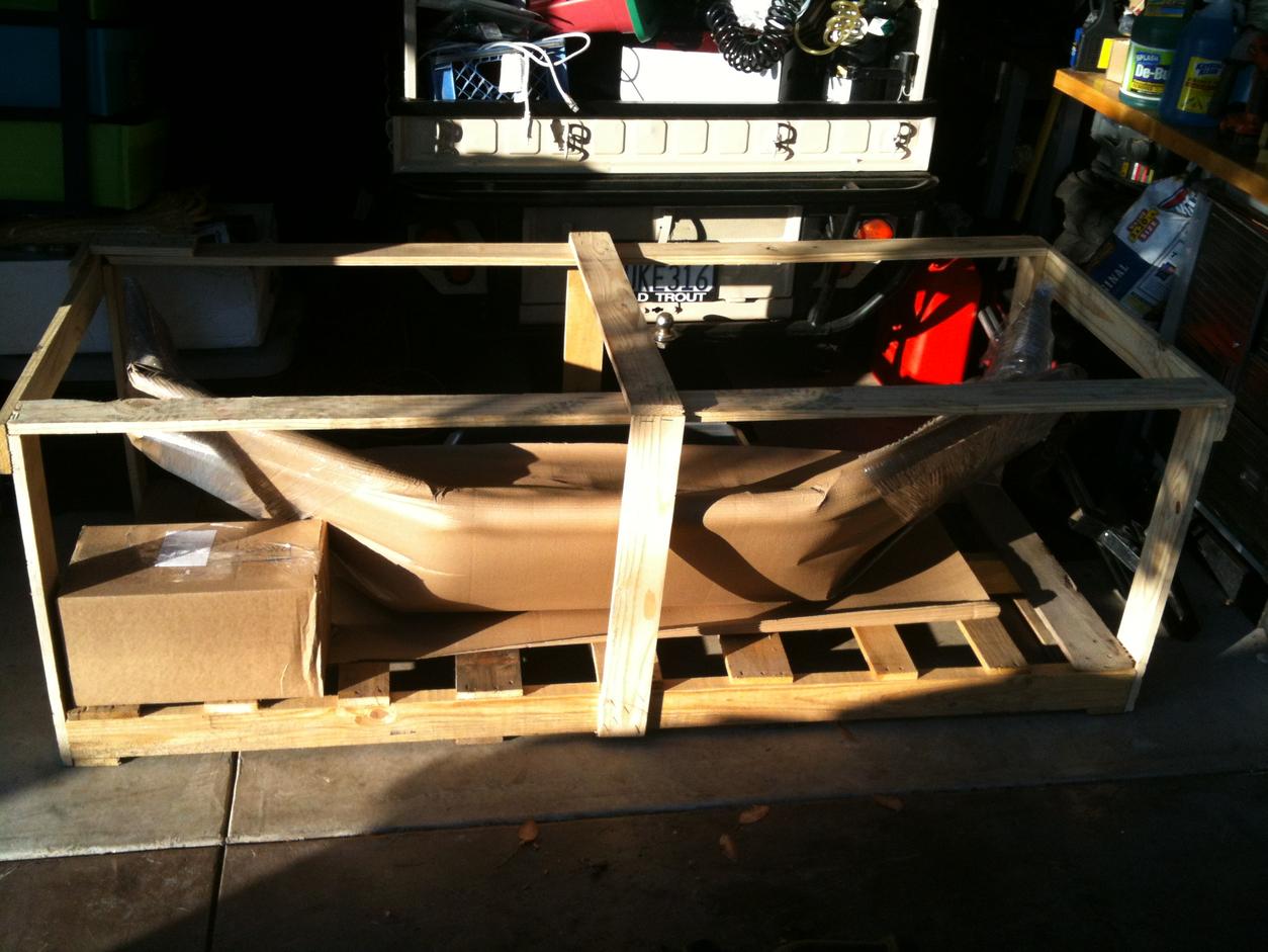

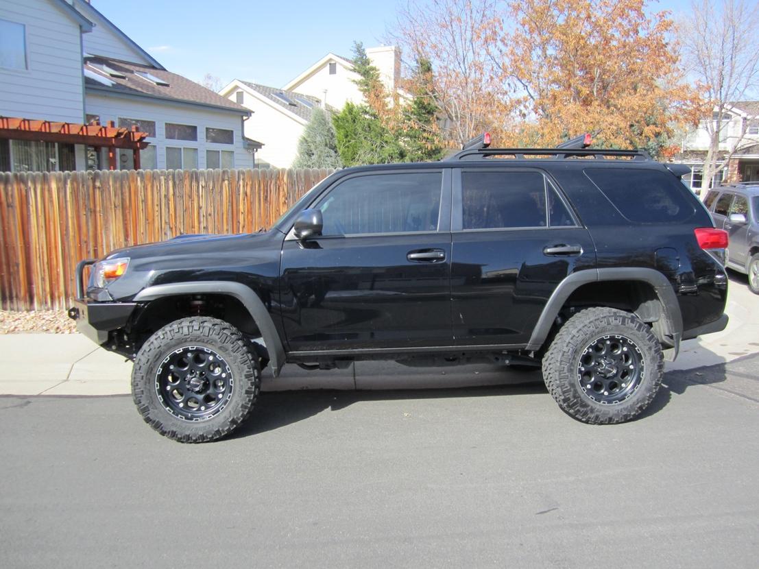

My SW front bumper just arrived today. It came at a bad time when I have a bunch of other things on my plate--I will not be able to install it for more than a week. Even so, it is now waiting patiently in my garage.
