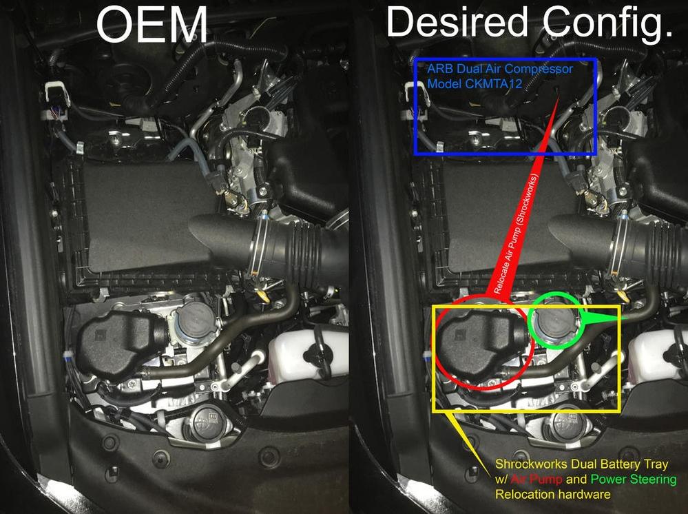

Design considerations:
-Aux battery: Odyssey 25-PC1400 (850 CCA, 65 Hrs at 20 Hr Capacity)
-Aux battery tray: Shrockworks with air pump relocator
-National Luna Isolator and battery controller
-Support all non-factory accessories via an auxiliary battery
-Ability to jump start from the auxiliary battery
-Support Warn Xeon Platinum 10-S Winch (311 to 465 Amps)
-Support ARB Dual Air Compressor (CKMTA12) with room for bracket
-Power sPOD Source SE with 8 channels for smaller sub-30 Amp accessories
-Support future accessories: Inverter, camper trailer anderson plug, upgraded sound system
Per National Luna, no fuses are to be installed between the isolator and batteries, to ensure the winch may consume high non-continuous amperage draws from the system. Per Warn, no fuse or circuit breaker is installed between the winch and battery.

Shrockworks dual battery tray is in...ARB twin compressor coming soon
This past weekend I installed the Shrockworks auxiliary battery tray kit with smog pump relocated back by the firewall. I'm planning to install the Bandi ARB twin compressor mount this weekend, which should fit above the Shrockworks bracket holding the newly relocated smog pump. I'm crossing my fingers it'll fit nicely. More soon with lots of pics and commentary.

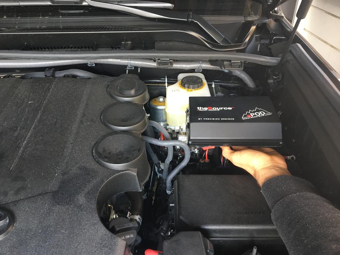

Also beginning planning on the location of the sPOD Source 8 channel unit. I am not a fan of any of the left/passenger locations, especially not when the air compressor and aux battery are taking up most of the space there and not a fan of mounting it on top of the air box. I'd like it to place it on the driver's side, behind the fuse box, elevated above the fuse box lid for easy access and plenty of room underneath for accessory cable management. I'll use L brackets mounted to the 2 existing threaded holes on the driver side wall. I will have some accessory lines route down, underneath the sPOD and back toward the firewall and then out to their various locations. For forward accessories, will route wiring down, to driver side wall and forward. The battery cables are too short so I will have to install new, longer wiring to route to the passenger side aux battery.

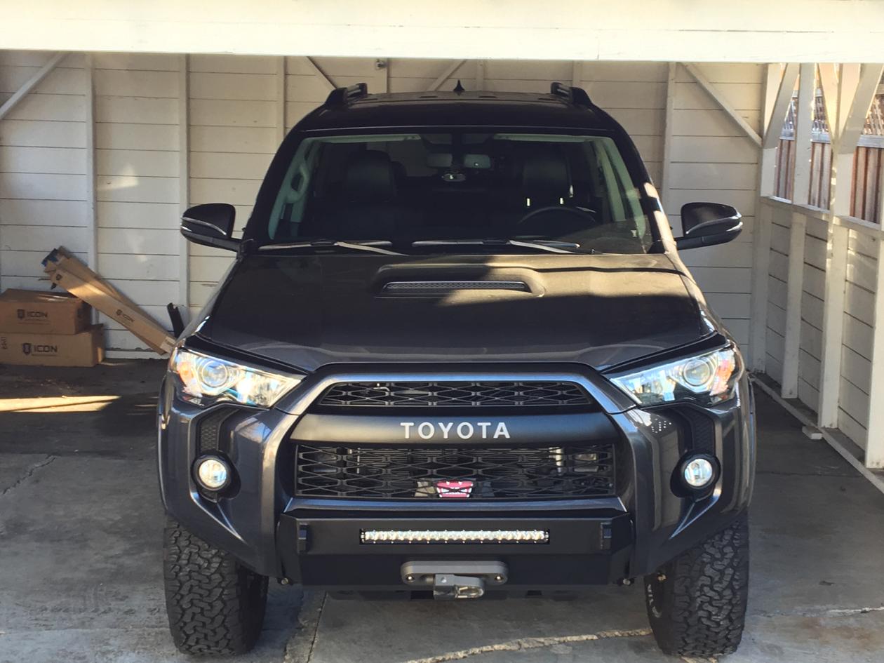

A quick update on the rig: I just installed the SS Slimline front bumper with 20" RI LED light bar (awaiting sPOD install) and the Warn Zeon Platinum 10-S winch (wired directly to the starter battery), which works great. Very impressive and simple operation with the wireless remote. I was super OCD on wire routing and protection. More coming on that soon in a detailed write up on my build thread.
A couple shots - how the sPOD will look and new bumper. Warn Epic D-ring shackles going on tomorrow with Daystar shock absorbers.

That looks like a solid place for the sPOD... its a good serviceable location.
I would mount it as high as you can so you can maintain as much space as possible under it.
