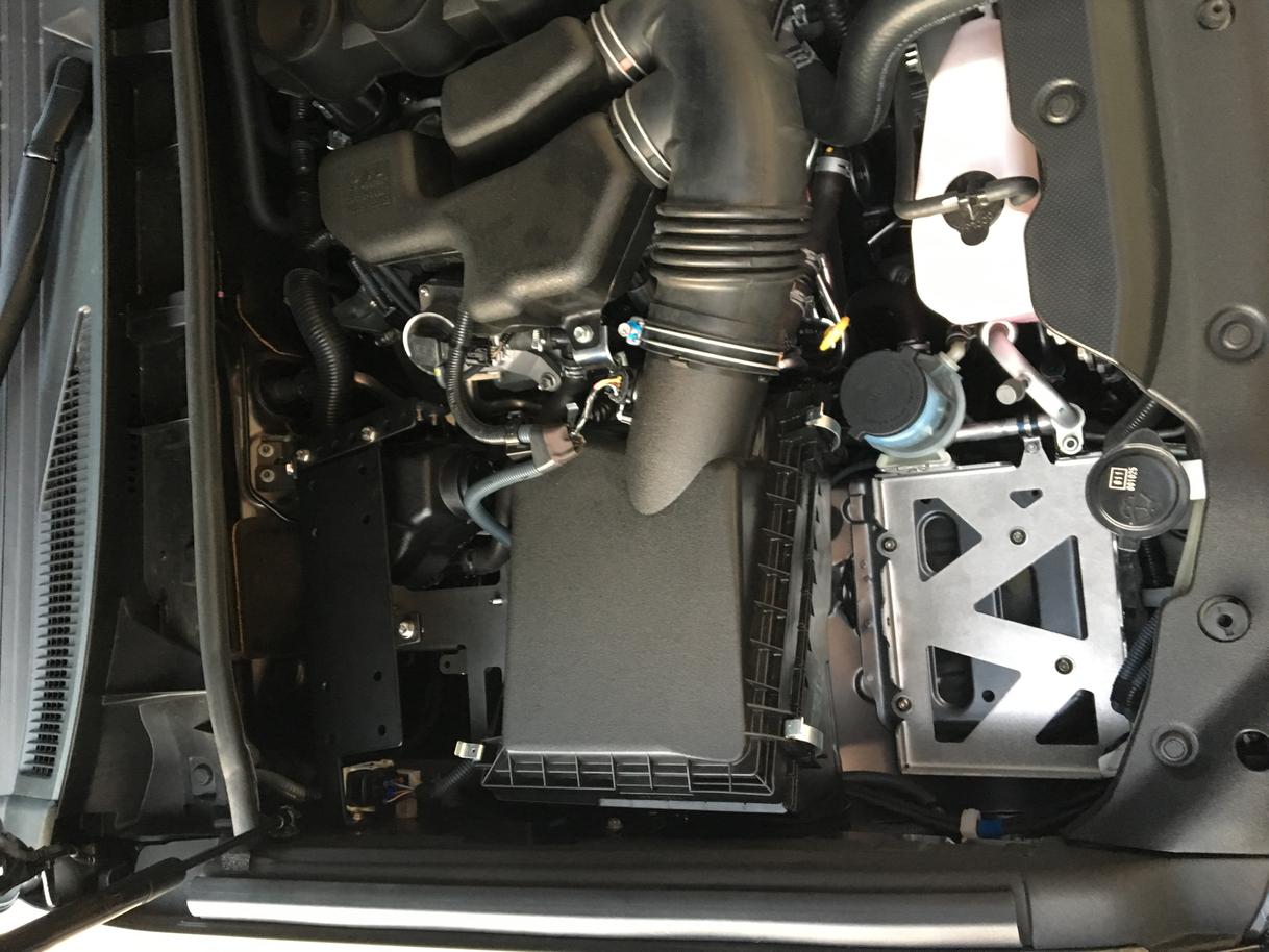

After finally installing the Shrockworks dual battery tray, I measured the dimensions of the tray and decided it should fit the desired Odyssey 25-PC1400 Battery.
Battery Specs: 850 CCA, AH - 20 Hr rated capacity - 65 Hours, reserve capacity @ 25 amps is 130 mins, 52 lbs.
Battery dimensions: 9.47" L x 6.85" W x 8.75" H
Shrockworks advertised max battery dimension: 10.1" L x 6.8" W x 6.9" H

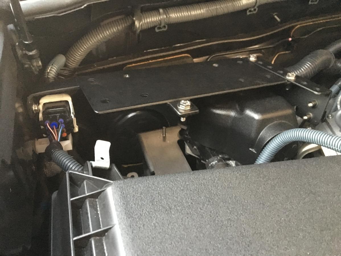

Confirmed! Bandi ARB bracket works with Shrockworks Dual Batt!
Hey guys I couldn't wait to try it out so right after work today I gave it a try and I can confirm that the [MENTION=125603]bandi[/MENTION] ARB dual air compressor bracket works with the Shrockworks dual battery tray kit. The Bandi mount clears the relocated smog air pump beautifully. I'm stoked!
Do you need a custom front leg? I see you used the shockworks tray in lieu of the mount I provided... Nice to know it fits beneath there with shockworks tray...
Do you thing you can get a water bottle under there to replace the oem bumper one (most people do with aftermarket bumper)?
Bandi mount
Hey Bandi! Your mount can host the relocated air pump just like the Shrockworks one? I had no idea. If so maybe I can just use yours instead and remove the Shrockworks one, or I'd be willing to buy a custom leg mount from you if you can swing it. I definitely need that leg mount in the middle for rigidity.
Which water bottle are you referring to? The one right next to the powering steering fluid reservoir? I thought the Shrockworks air pump relocator tray would accommodate a water bottle for only the FJs, rendering that section of the bracket useless in the 4Runner. Do you know?

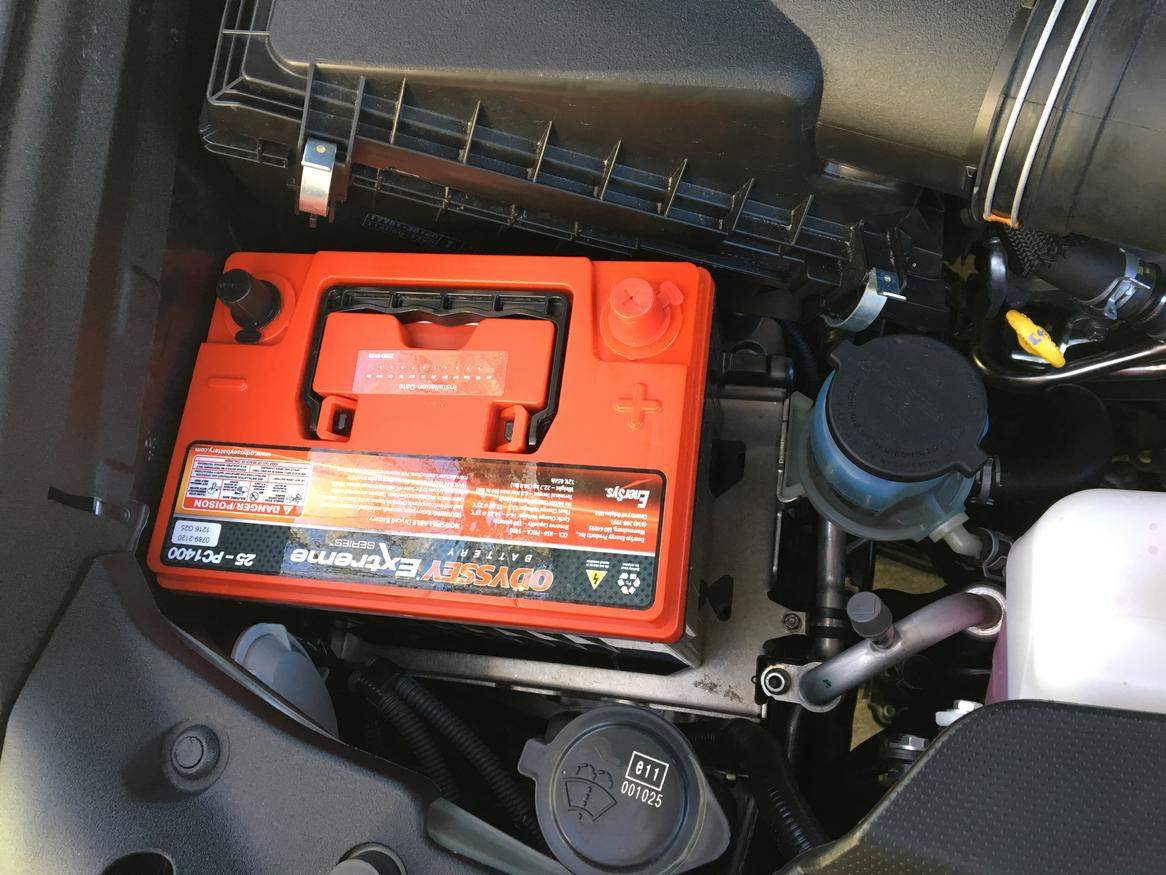

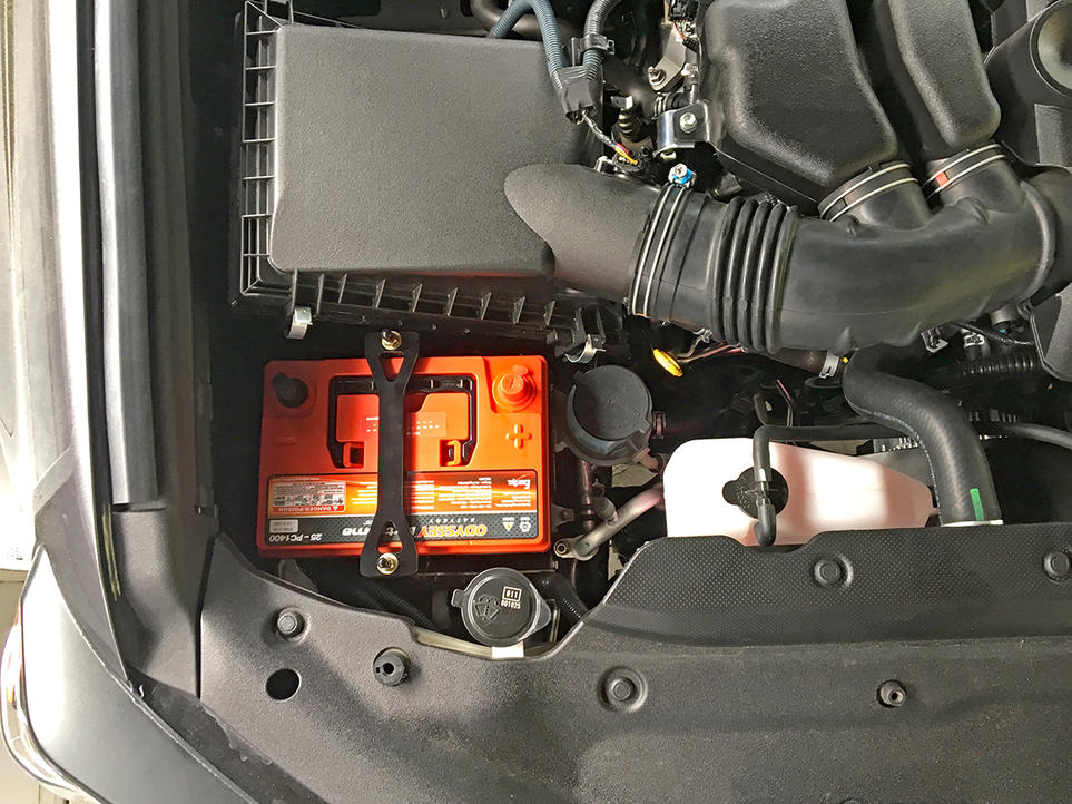

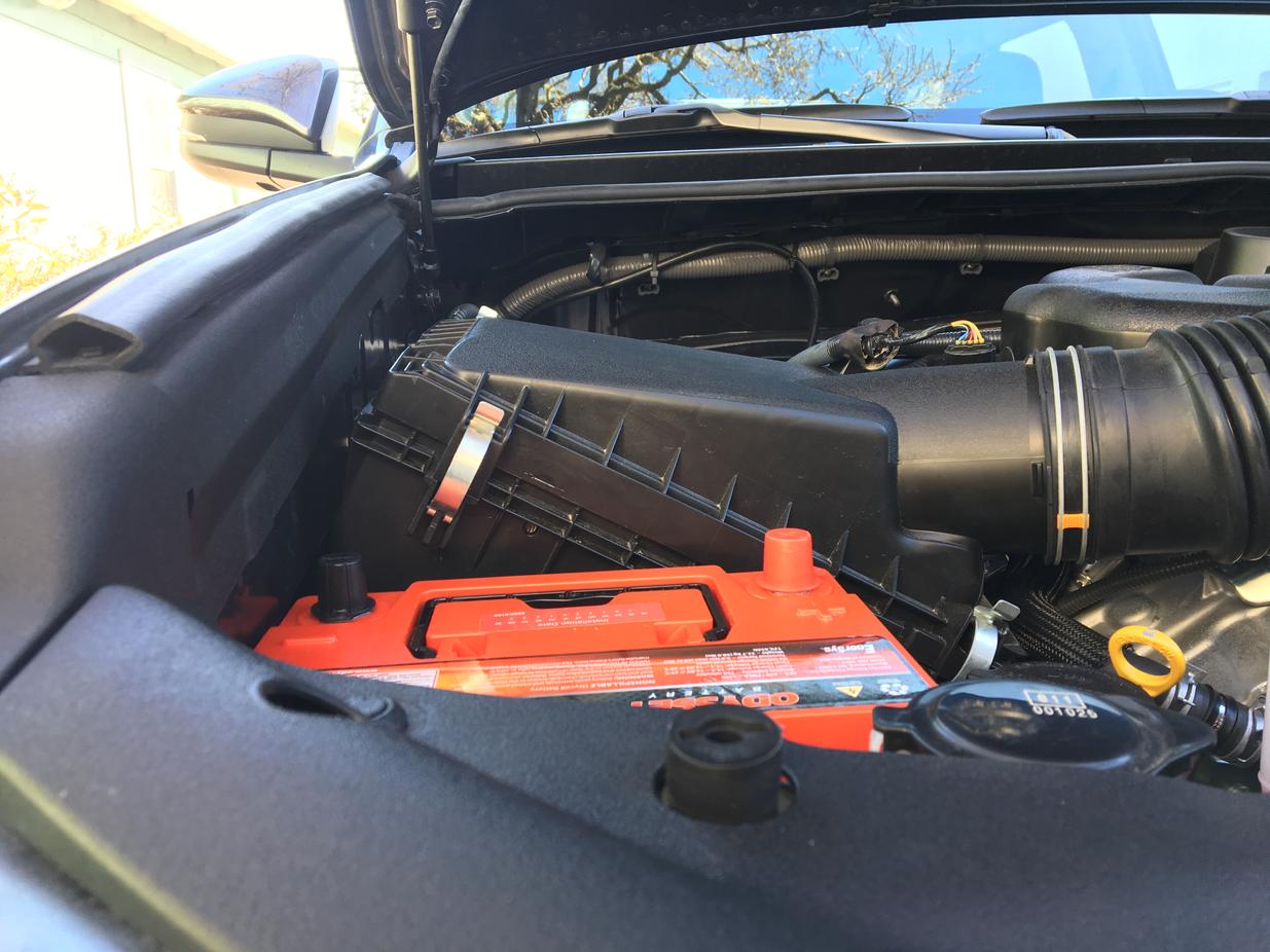

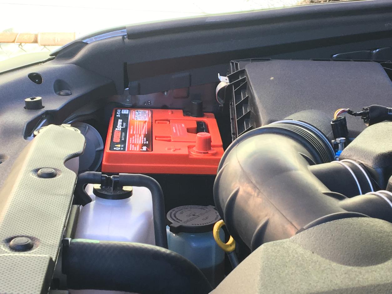

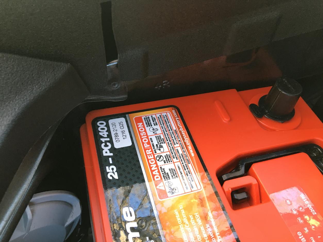

Odyssey 25-PC1400 fits Shrockworks tray
The Odyssey 25-PC1400 battery fits the Shrockworks tray with plenty of room to spare. I wish I had maybe ordered the next size up to see if I could fit it but at least it's easy to get in and plenty of space for air and routing wiring. It weighs less than advertised, which is cool, 47.6 vs. 52 lbs.
Actual Battery Dimensions:
9 3/8" L x 6.75" W X 8.75" H
Advertized Battery Dimensions:
9 7/16" L x 6.75" W X 8.75" H
Actual Weight: 47.6 lbs
Here are some pics of the fitment from different angles to give a sense of scale relative to components in the engine bay.
If you're wondering where the ARB air compressor bracket went, it's in for powder coating since I made some holes larger, along with a bunch of other brackets I made over the weekend for the sPOD, Isolator, and ARB rear diff breather.

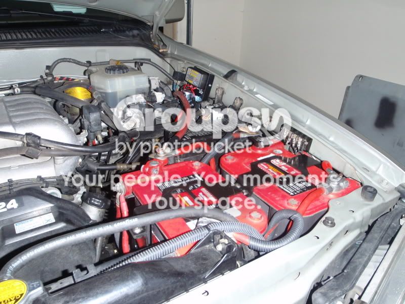

Looking good so far... I like the way the terminals orientate towards in the inside of the engine bay.
Everything I wire is like that... ill change a battery to make it happen too.
Every time I see a positive battery terminal sharing wall with a fender or front grill area I cringe because I can't help but think about getting into an accident where the body was hit hard enough to create an electrical short. Solid way to have an engine fire on an already bad day.
Even a loose battery tray might do this one in... No thank you...

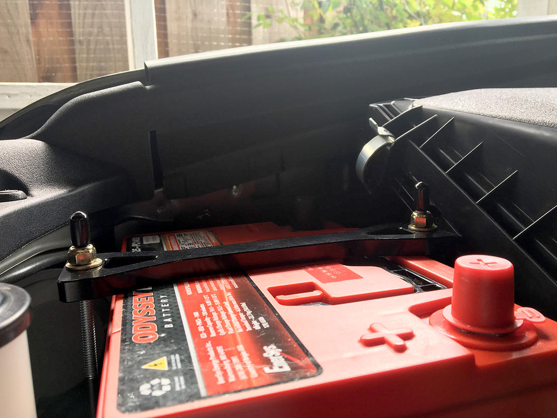

Have you got around to installing the Odyssey 25-PC1400 in the stock location yet? Great thread keep up the great work buddy.

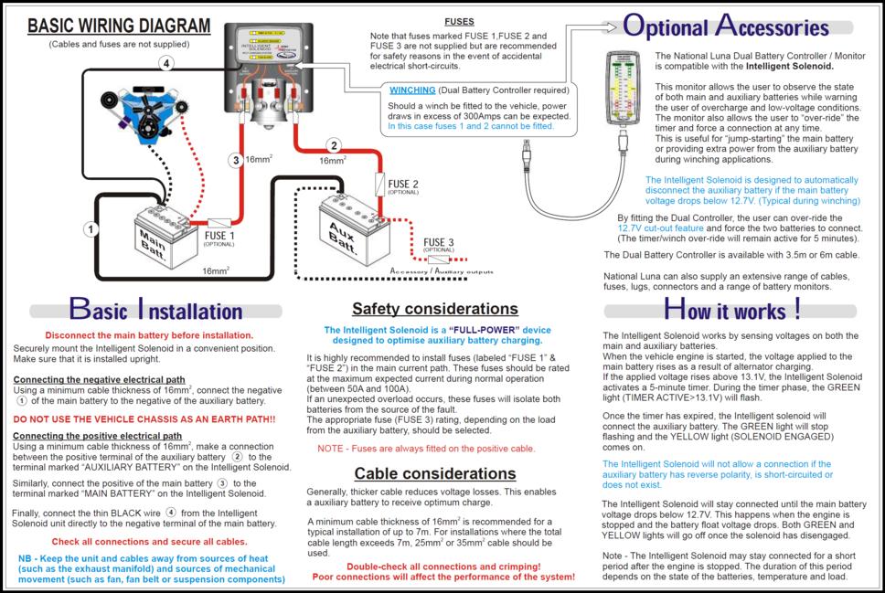

Here's the new diagram. I'll begin installing items over the next few weeks, then will estimate wiring lengths, will then calculate the wiring gauge needed based on those lengths and individual accessory max amperage draws.

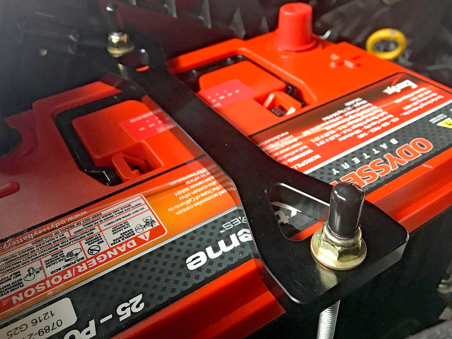

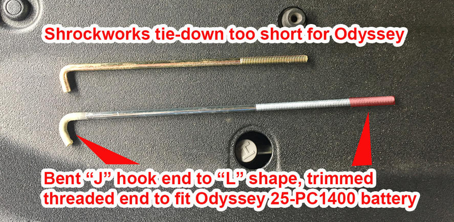

Odyssey 25-PC1400 & tie-down hooks for Shrockworks tray
I had a silly time suck customizing new battery tie-down hooks that would work on the Odyssey since the Shrockworks dual battery kit tie-down hooks were too short for the Odyssey.
I cut the new 10" hooks down to 8 7/8" total length, heated up the "J" hooks red hot with MAPP gas and then bent the hooks into more of an "L" shape to match the Shrockworks hooks and thus fit into those tiny holes on their battery tray. The "J" hooks don't fit into those little holes on the battery tray.

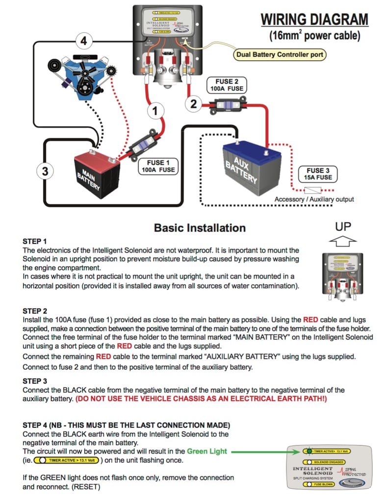

@N.Alvarez here are the instructions I had with my Isolator
[MENTION=144206]N.Alvarez[/MENTION] here are the instructions I had with my Isolator...
National Luna Isolator installation instructions
