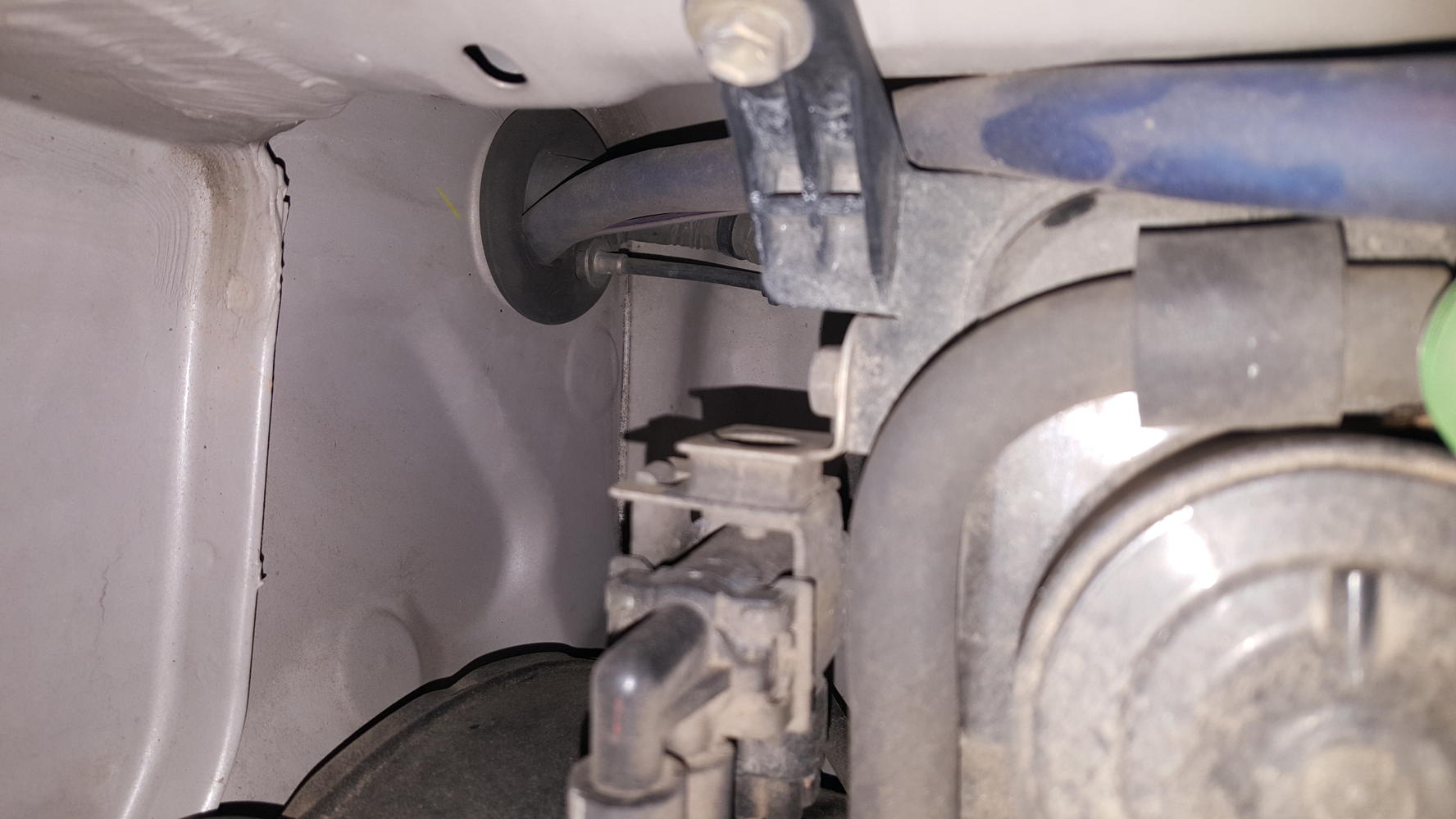

You can use the factory wiring hole in the firewall. I made a small "+" incision then pulled the wire through gently. I've had zero issues with dust or moisture coming through.
