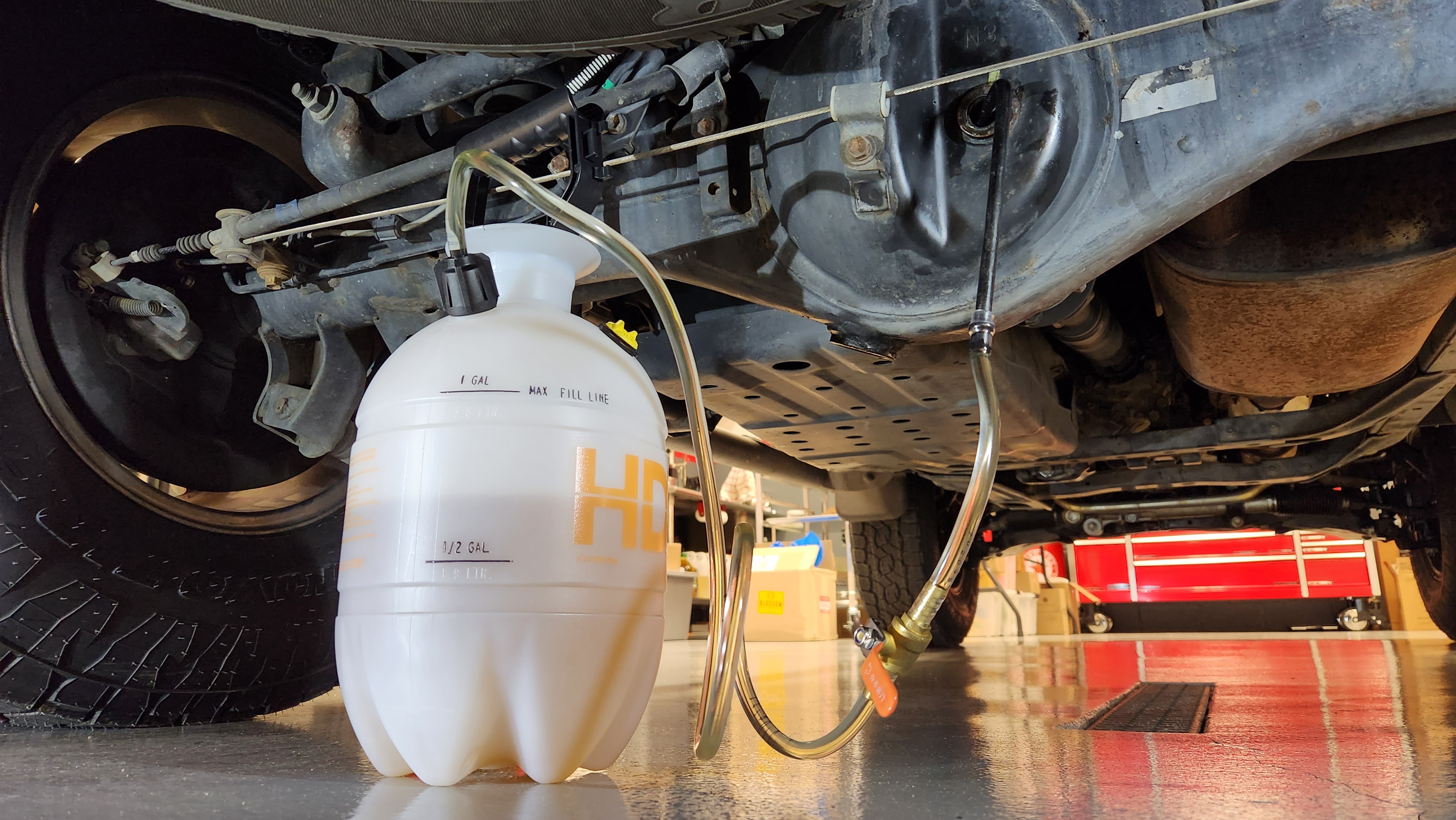

Diffs and transfer case fluid change using the new pump. Worked great. Seemed to pump decently fast as well. I kept the Mobil1 75W90 in the house so it wasn't super cold which helped.
Updated drain and fill plugs to Lexus parts for the front diff as well.
3rd post updated with video.
