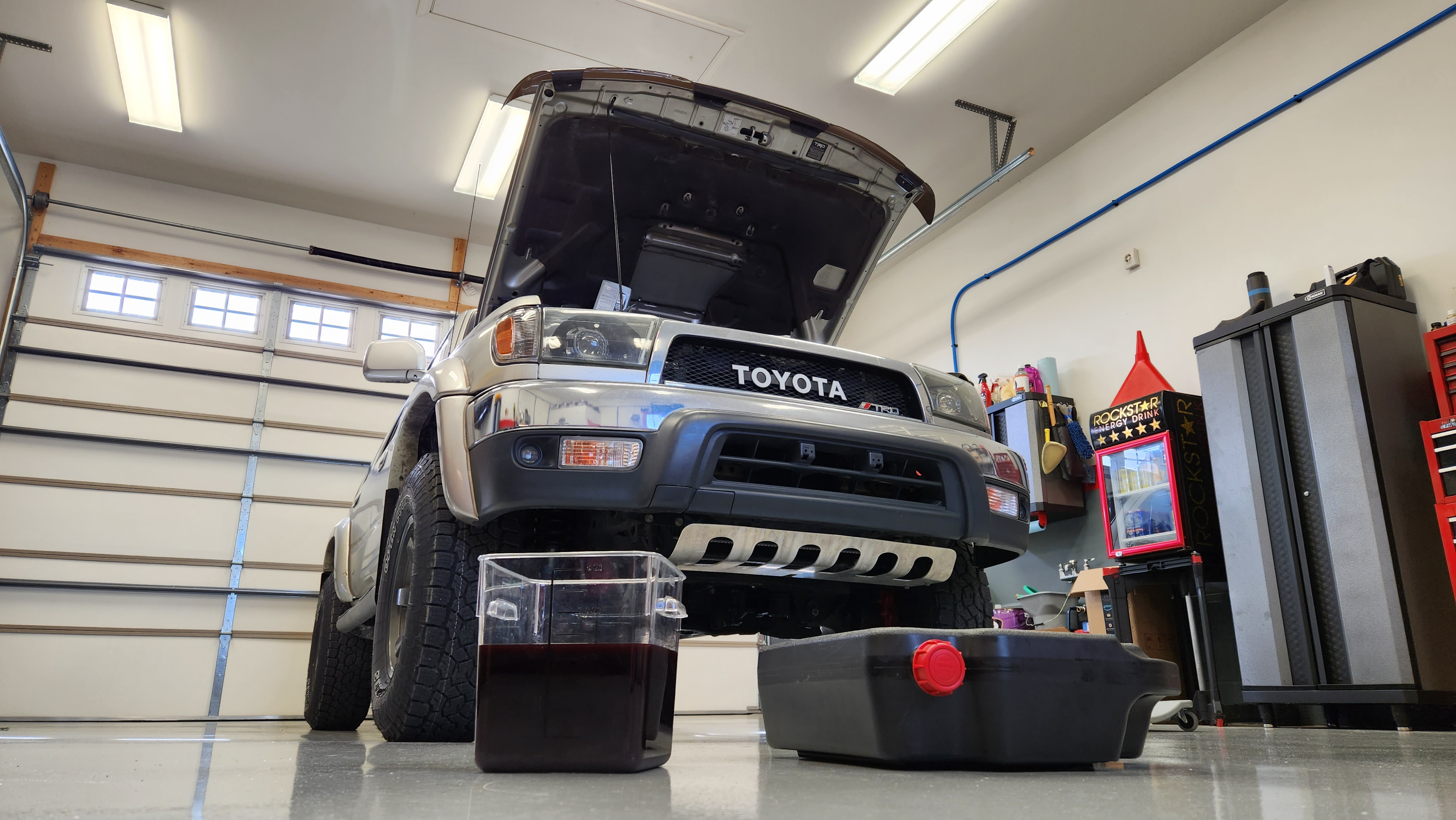

Just ordered about $50 in new bolts from the local Toyota dealer. If it was rusty or didn't come clean with a tooth brush I ordered a new one as I'm working through some disassembly now.

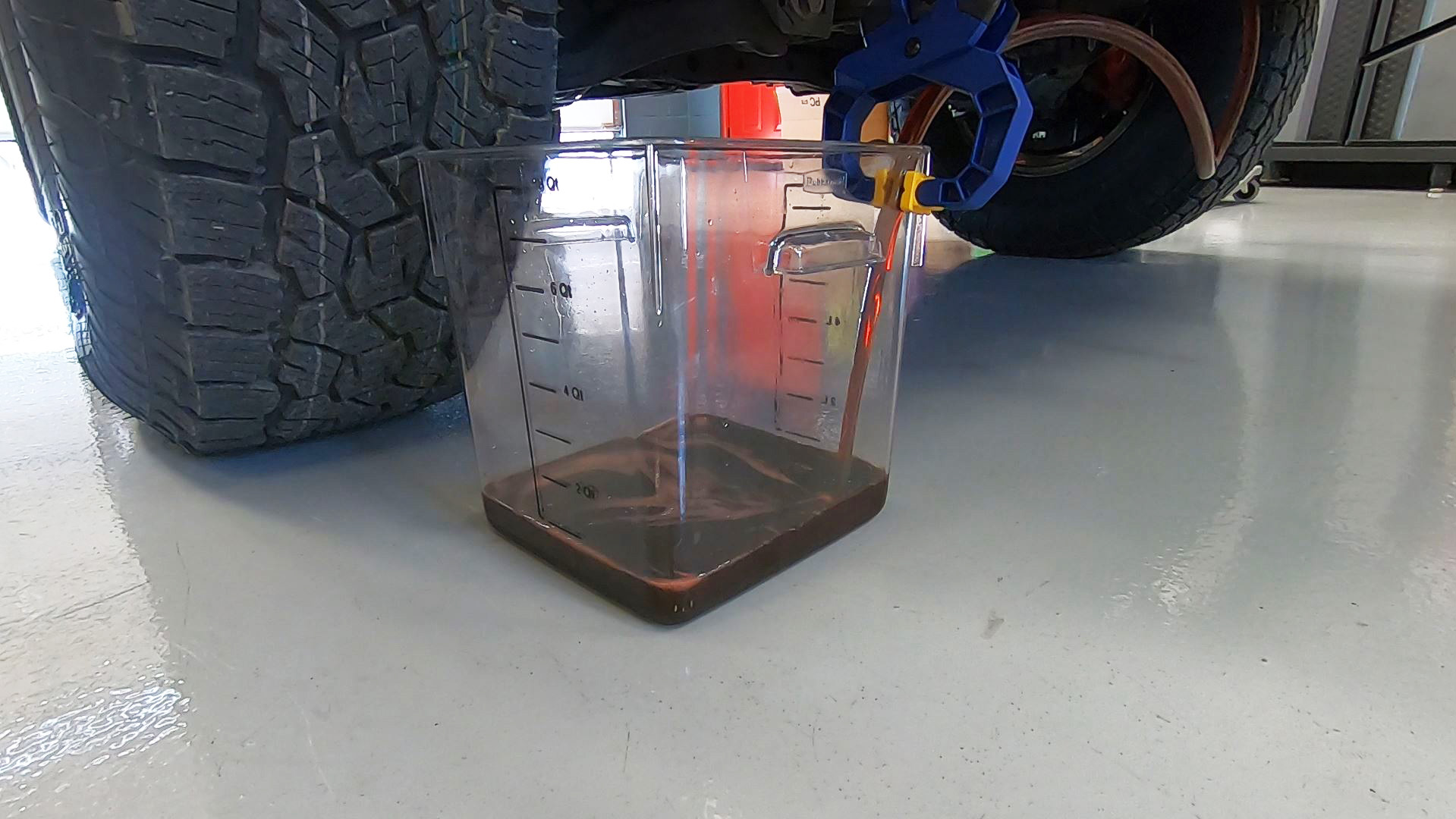

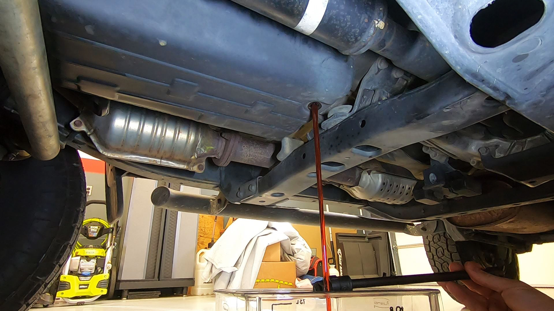

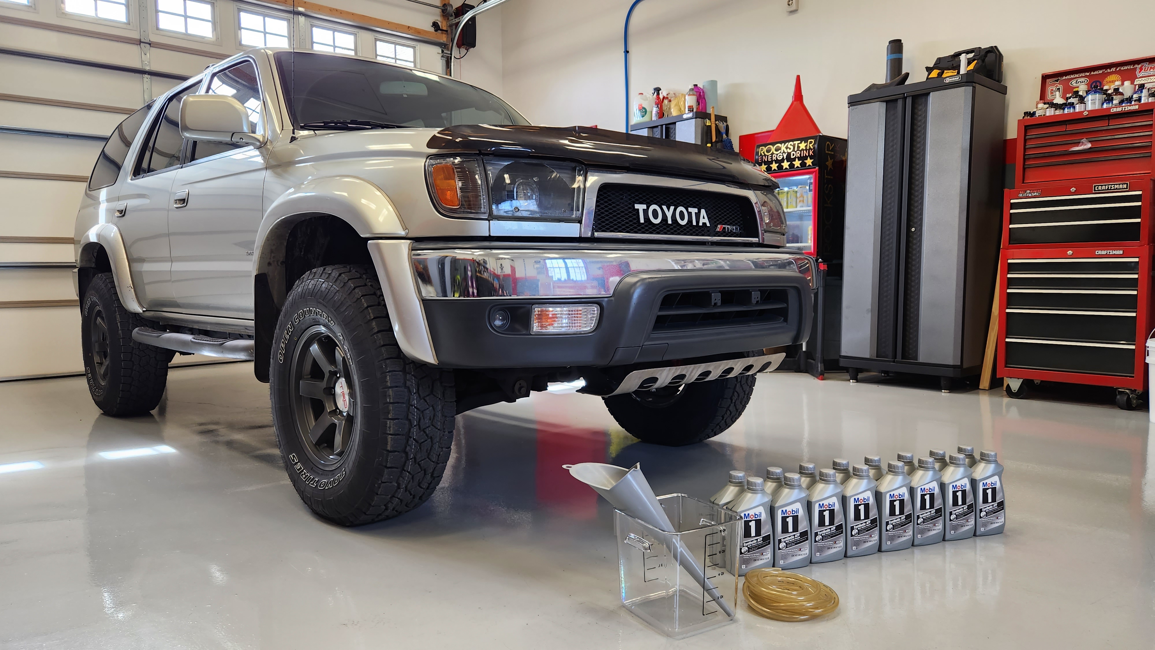

Also, got the trans fluid changed out and used some Mobil 1 Synthetic ATF I got on clearance at the local auto store. Was gonna use the Valvoline MaxLife but this Mobil 1 is what I put in 15 years and 100K miles ago and surprisingly it didn't look too bad and it was like $6 a quart. Win win.
Power steering is all that's left from a "fluids" perspective.
Vid in 3rd post.
