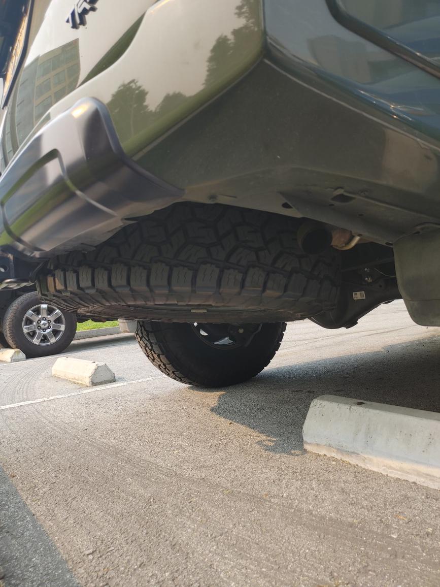

Can I see how this looks? How far down does it hang?
Tried attaching pics
