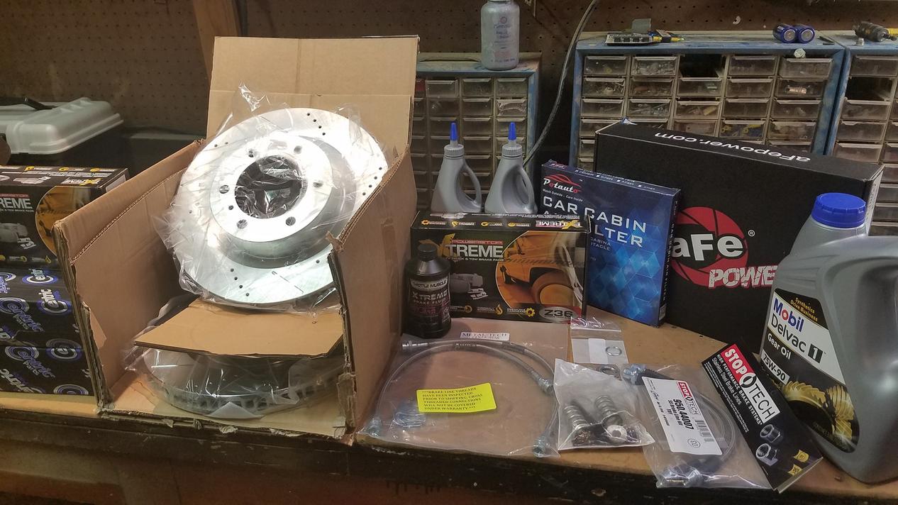

Started using some items ive been accumulating in preparation for Road trip to OBX North Carolina in September. Today was only the Rear and transfer Case fluid changed with Mobile 1 Devlac fluid.
Everything came out clean and light colored.
Magnet had some dirt come off on a white paper towel but no obvious debris.
The front will get done when I do the last minute oil change.
Next up is Brake system overhaul and stainless line upgrades in the rear

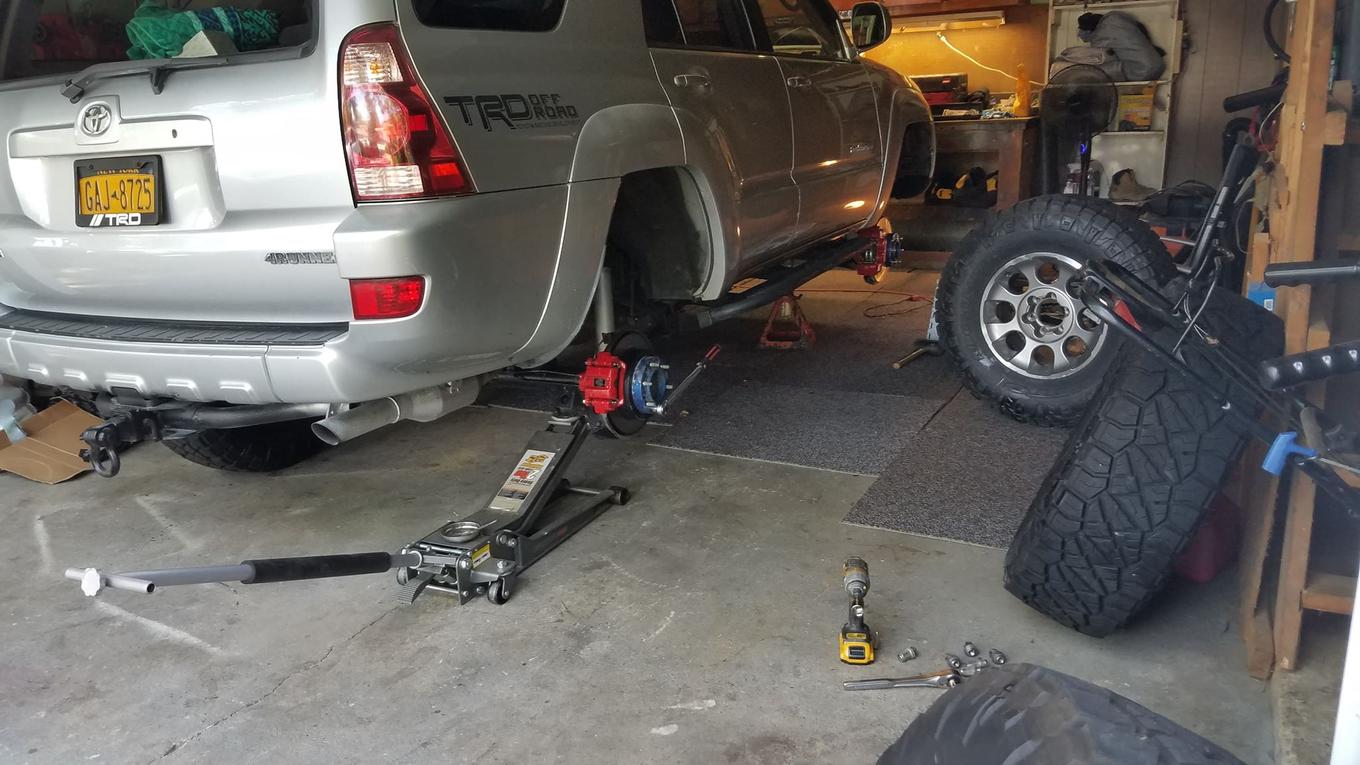

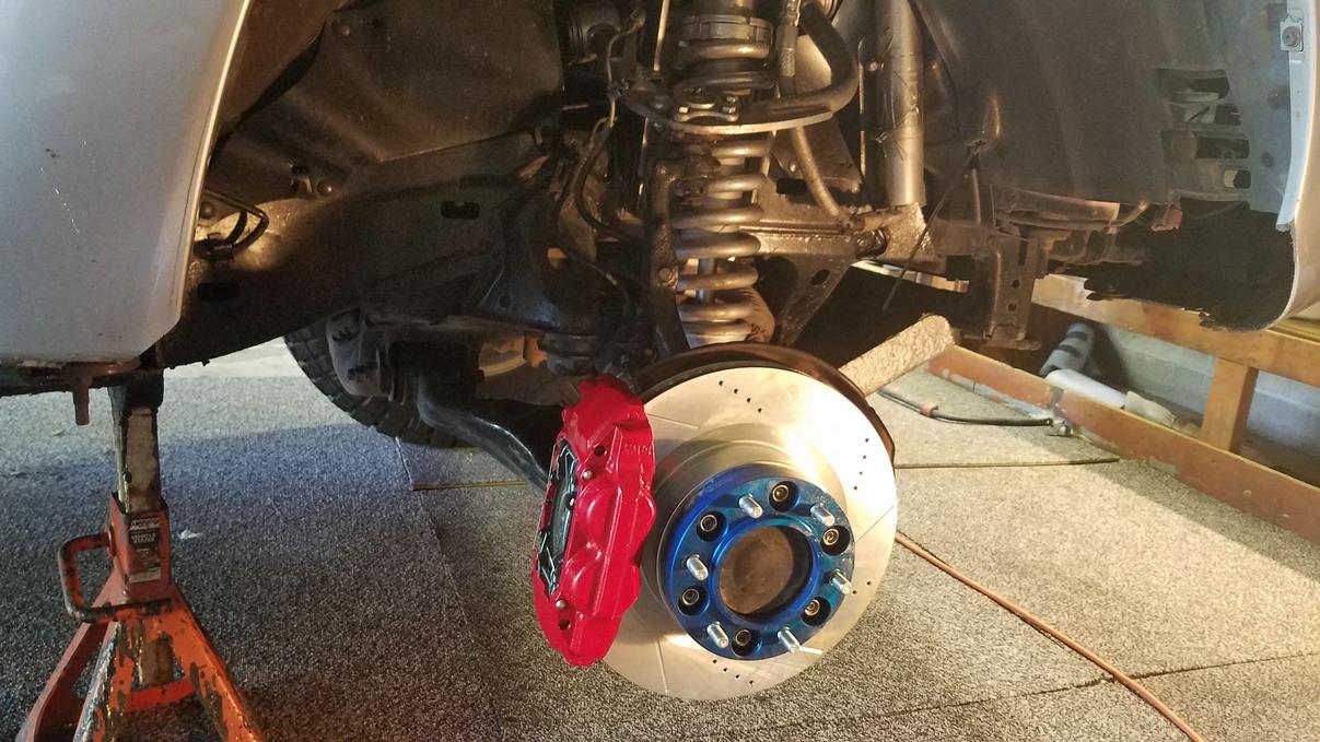

Worked on doing brake system overhaul this weekend. @ 142k
Front and rear Stoptech severe duty calipers
Stoptech SD pads and rotors/ rear centric premium rotors.
a Brake fluid flush and tire rotation

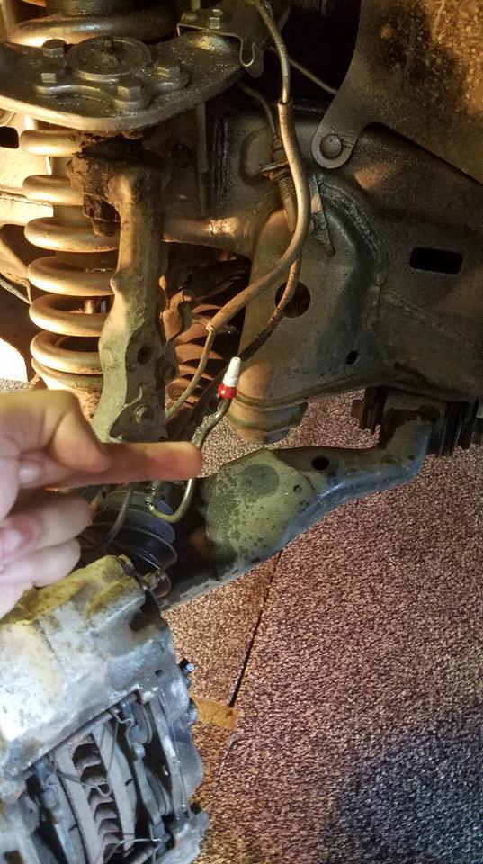

Of course I got to the last wheel, (drivers side front) and the steel brake hose from the caliper popped as soon as I touched it.
Found a line that was too long at pepboys but had matching fittings, did some "custom" bending and made it work. Stops like a new truck

Did you run into any issues with this or require any mods? Really considering the brake upgrade on the my v8. Also, would you mind sharing any links or part numbers to the specific stoptech gear? I am not having much luck looking for 4runner compatible stuff.
I feel like the truck stops better and smoother now then it ever did.
No issues that required mods,
only thing to note is to make sure when installing the brake pad hardware slider/clips on the rear calipers, they are side specific to the caliper and unlabeled. even though they look almost the same they aren't. The tiny tabs on one side should face away from the rotor, its an easy thing to miss. Also an easy thing to fix.
Also the Brake hose/line that goes from the front caliper to the fitting on the flex line is brittle and hard to deal with. Do yourself a favor and get 2 new lines while your there. They are cheap.
Drivers side - 47316-35250
Pass side - 47314-35330
Then put these on after it - CENTRIC 95044007 StopTech Stainless Steel
www.rockauto.com - Look for 5% discount code somewhere on this forum.
POWER STOP K587336 Z36 Severe-Duty Truck & Tow - Front Rotors and pads - Requires 17inch wheels <--- 5th gen upgrade
POWER STOP S6278 Performance Red Powder Coated CALIPERS- Front x2 - requires 17inch wheels <-- 5th gen upgrade
POWER STOP K240536 Z36 Severe-Duty Truck & Tow <-- 4th gen rear Rotors and pads
POWER STOP S2726 Performance Red Powder Coated<--- 4th gen Rear calipers
*When bleeding the brakes, have a friend with you.. pump the brakes until there leg cramps.. then pump more.. you basically cant pump them enough.. Bleed the line with the engine off, pump more, bleed Key on engine off .. pump more.. bleed with engine on.. pump more. Start with pass rear wheel, drivers rear wheel then pass front and then drivers. If VSC light comes on, turn engine on and dont pump for a minute and it will go off..
Hope this helps

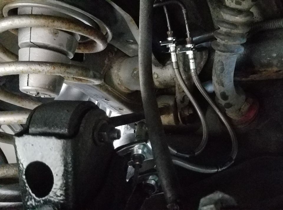

Added Metal tech extended Braided stainless brake lines for Upper rear between Body and diff and a fresh state inspection.
The brake lines definitely increased brake sensitivity and feel

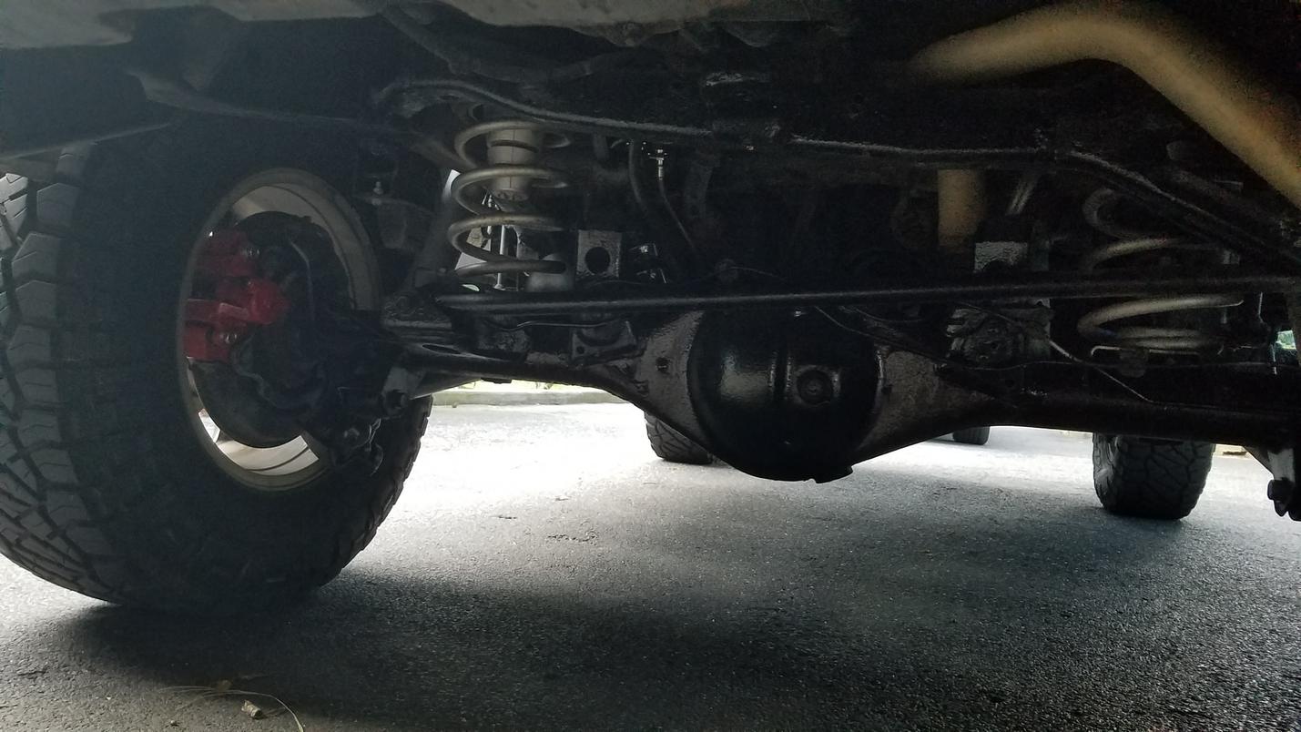

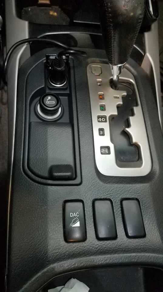

Installed OEM smokers kit for Extra Power port.
Also Reinstalled FJ cruiser rear sway bar to replace my broken one.

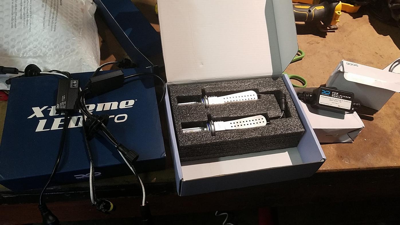

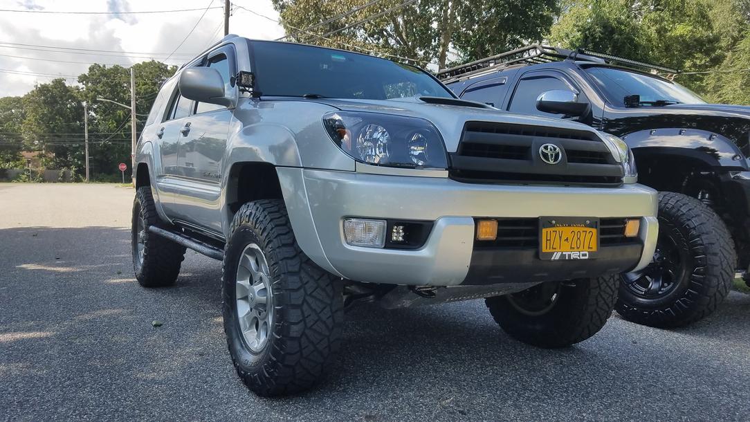

Got new headlight housings and installed the Xenon depot LED pro kit. They ae significantly brigher then the sylvania silverstar ultra's I had and you can adjust the individual bulb to fit the halogen style housing. Id say this is the best way to go until you decide to dive into the world of Retrofit's and HID's.
Very clean look too..
I didn't take any pictures because, I felt none of them really did any justice.
https://www.xenondepot.com/9006-Xtreme-LED-kit-pro-p/xt-led-9006-pro.htm

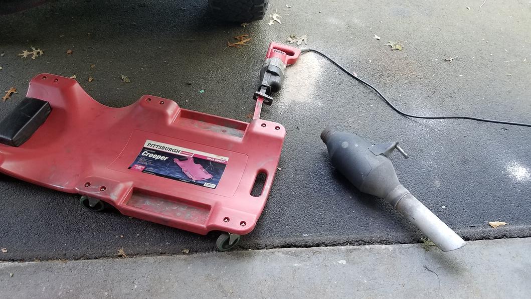

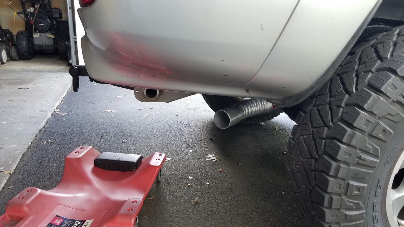

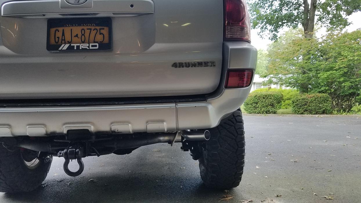

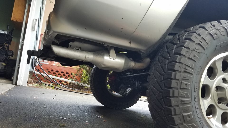

Also finally deleted the rear exhaust resonator. for 10$ I should have done this a long time ago lol.
