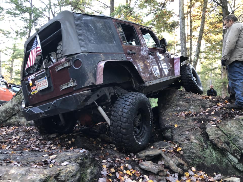

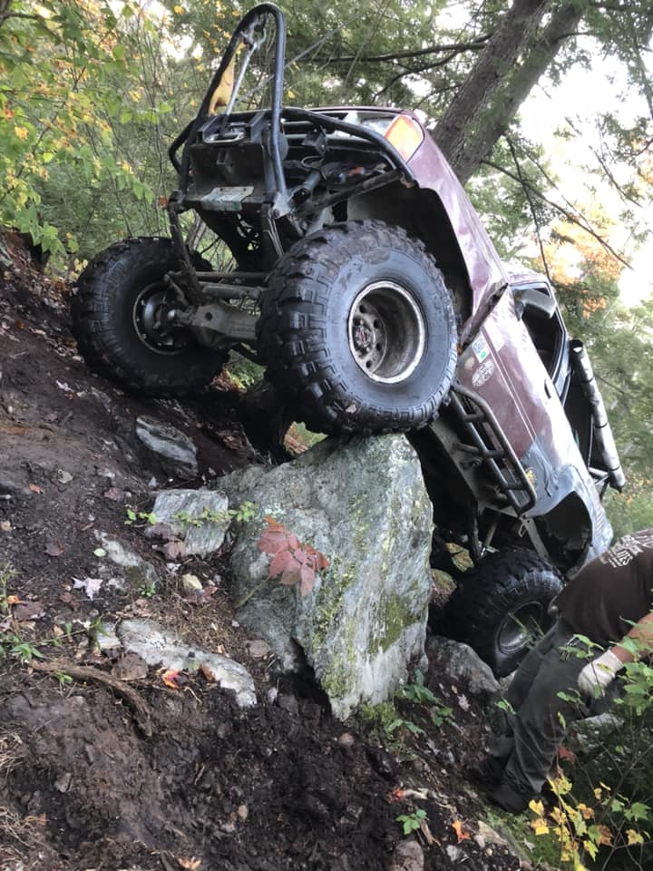

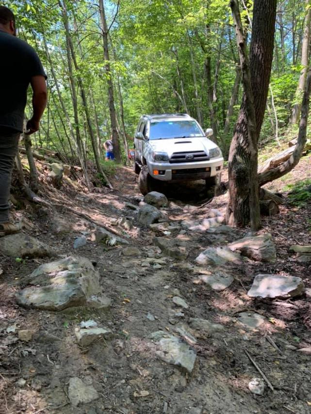

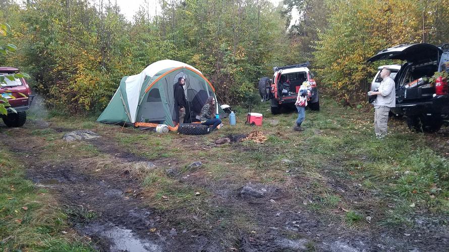

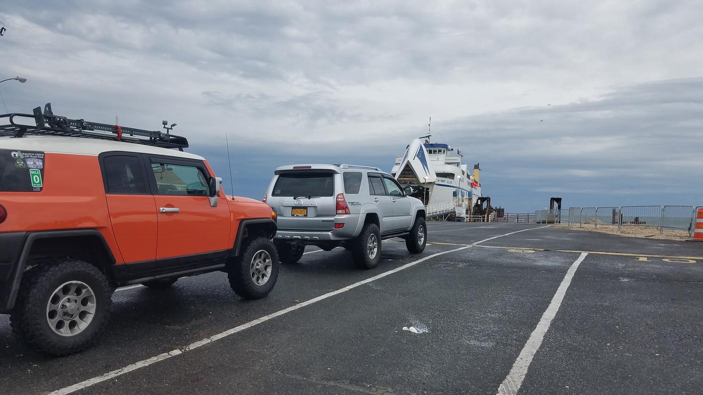

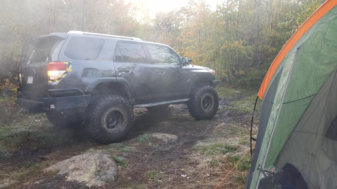

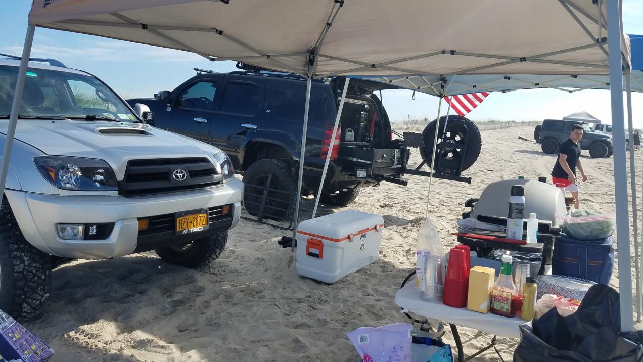

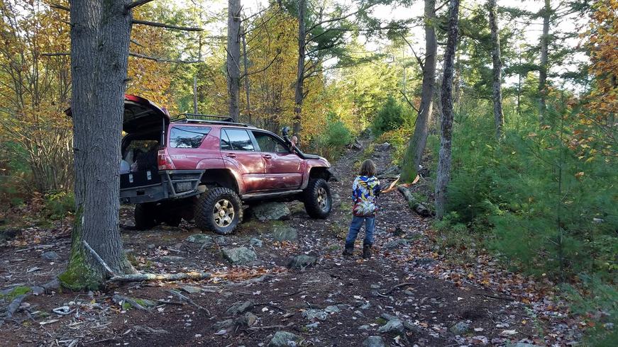

Took a trip over to CT by LI cross sound ferry then to Massachusetts over to the NEA4WDC brook ridge property for some next level wheelin and camping! Awesome time!

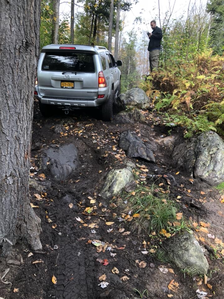

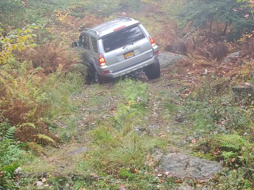

Unfortunately I made a rookie mistake of doing work to the 4runner the day before the trip, I rebooted a cv axle and in the process stretched an ABS line and killed my ATRAC for the trip. This made some obstacles many times more difficult then they had to be. However the truck still did well and it just forced me to learn how to run it without any assists.

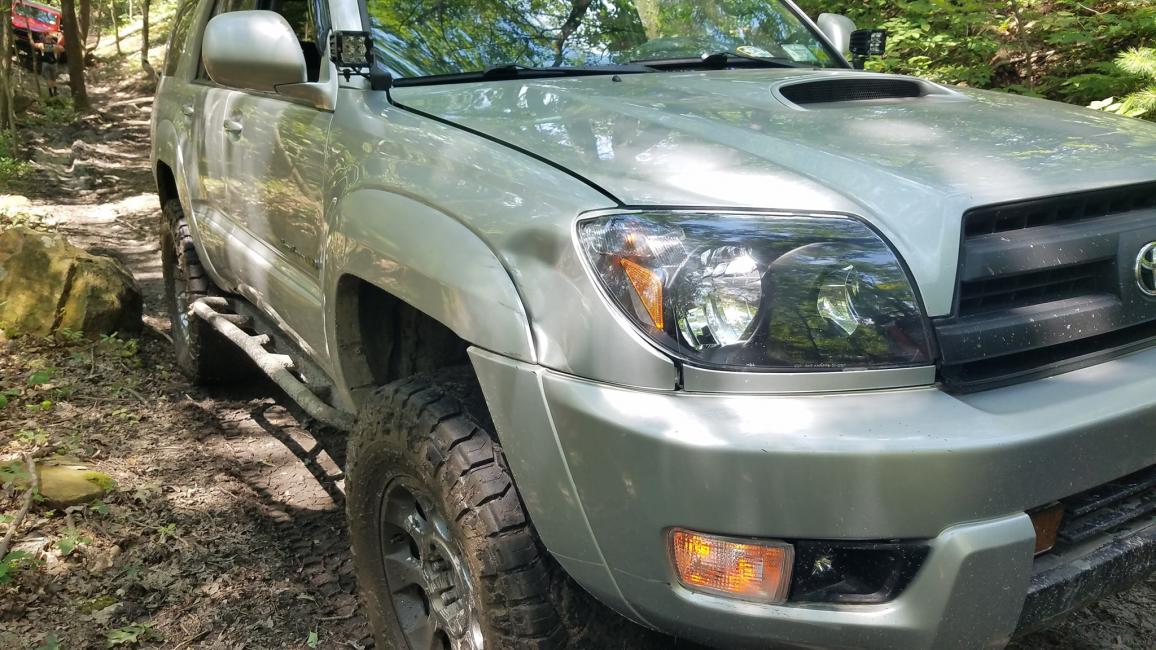

Damage report: while on a narrow off camber section of trail, I attempted to use the driver side tire to climb a large rock. without atrac, I needed more gas to climb it. Even while two footing the gas and brake it slide sideways from tire spin and into a tree stump just high enough to clip the bottom corner of the bumper. Nothing a few wire ties couldn't fix. Heres a few pictures
Some of the vehicles: me, another 05 4runner, 13 fj, 07 tahoe, first gen 4runner, 5th gen 4runner, Jeep on 1 ton axles with a chevy 6.2l swap

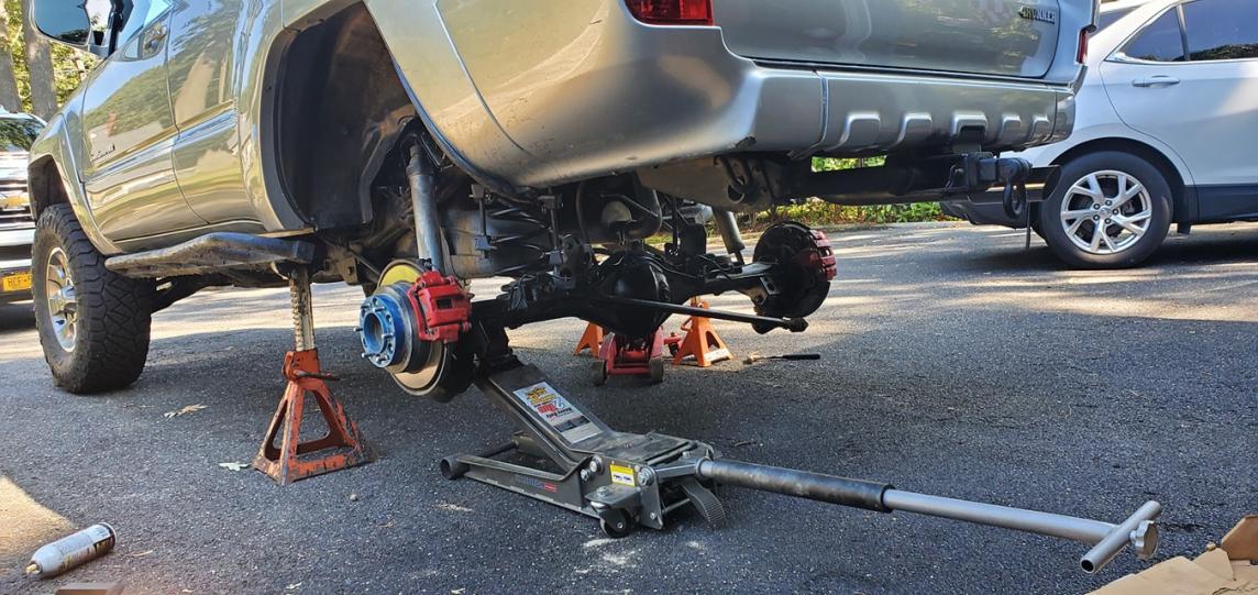

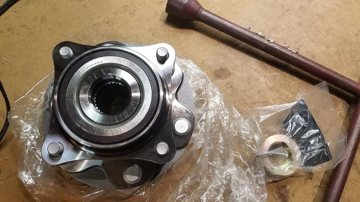

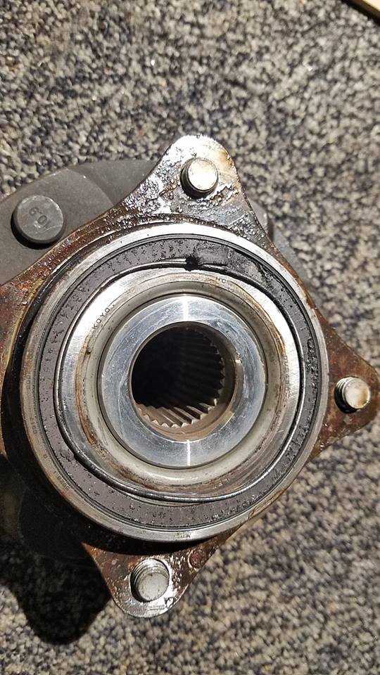

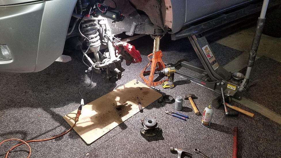

Now that I have resolved the issue here is what happened.
After Rebooting my drivers side CV axle for the second time in early October, I did the "Leave the abs sensor alone" method. which ended up being a bad idea.
When reinstalling the CV, it must of contacted the tip of the original sensor and broke it off into the sensor track. after putting it all back together, the debris from the sensor took out the rest of the sensor and melted into the hub. This triggered all the lights ( VSC ABS TRAC).
I first replaced the sensor since it was easiest. Which did nothing except break apart from the old debris still being there.
I then replaced the harness to rule that out and it was on sale.
Then I replaced the hub assembly and saw the magnetic strip that the sensor read was destroyed from the debris..
Now all lights are off and this is annoying issue is done.

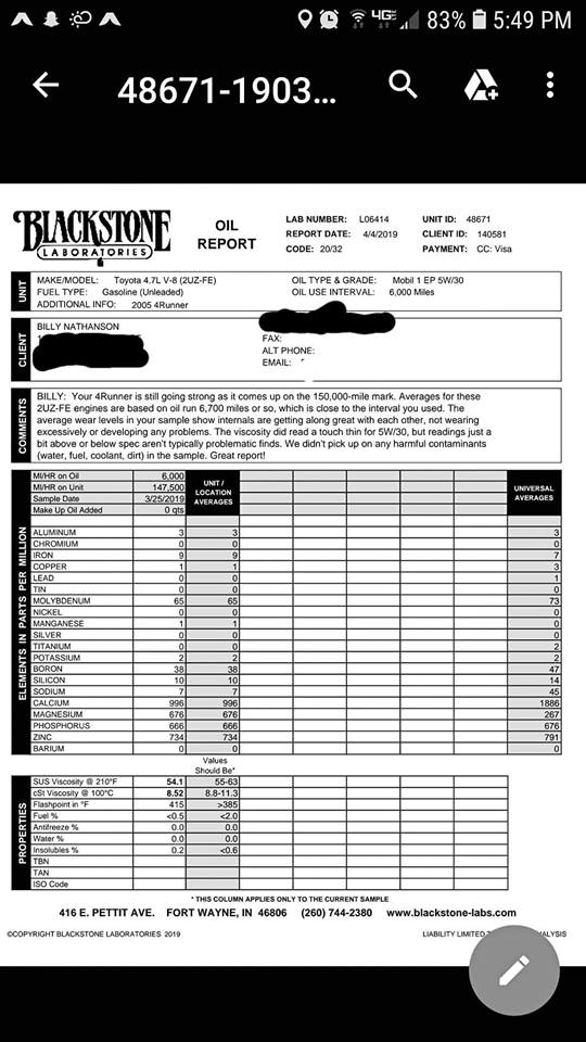

Recently changed the oil and did the black stone lab test.
This oil change was from October of 2018, which included a 1600 mile Fully Loaded up road trip up through Vermont, NH .. Up Mount Washington into Maine then 2 separate wheeling trips in Mass and PA and an entire Winter of daily driving.

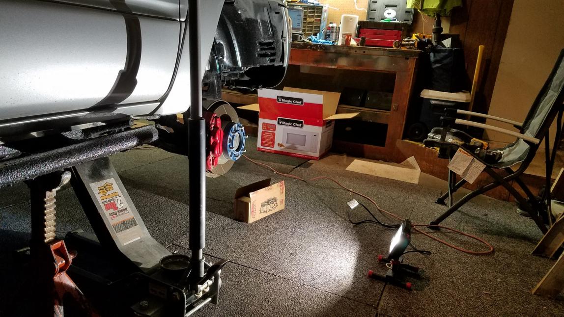

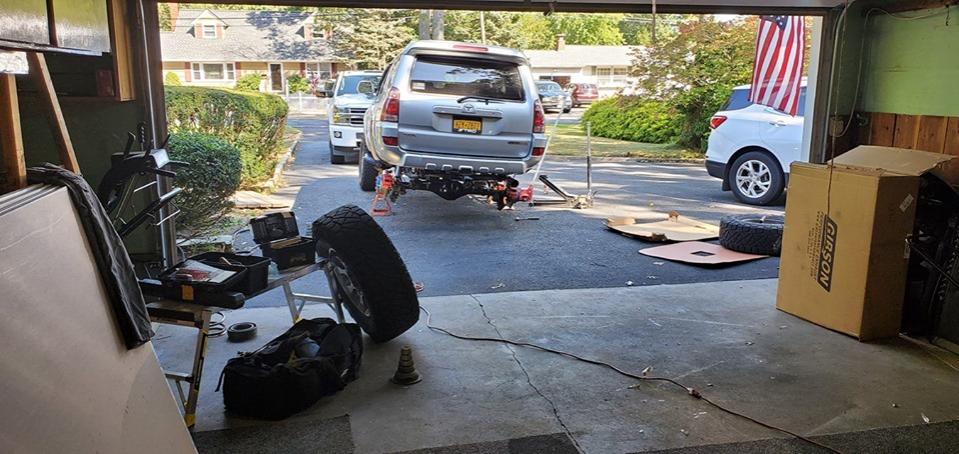

-Rebooted and greased Passenger side CV with SDHQ boots for second time. First set lasted about 5 years. These are original OEM cv's with about 150k on them. I hate doing this job but it saves about 300 bucks from buying a cvj or oem axle.
A few things to Note:
*REMOVE THE ABS SENSOR FIRST CAREFULLY, AND GET IT OUT OF THE WAY
- Do not fully remove the 2 LCA bolts until everything else is loose too.
- Turn the wheel fully towards you before attempting to disconnect outer tierod.
- The C clip on the end of the CV is a pain in the ass and theres no good way around that
-The clamps slide off when tightened on the diff side. A ziptie holding it helped.
*The CV notches tapped with a screw driver and hammer made it easily removable.

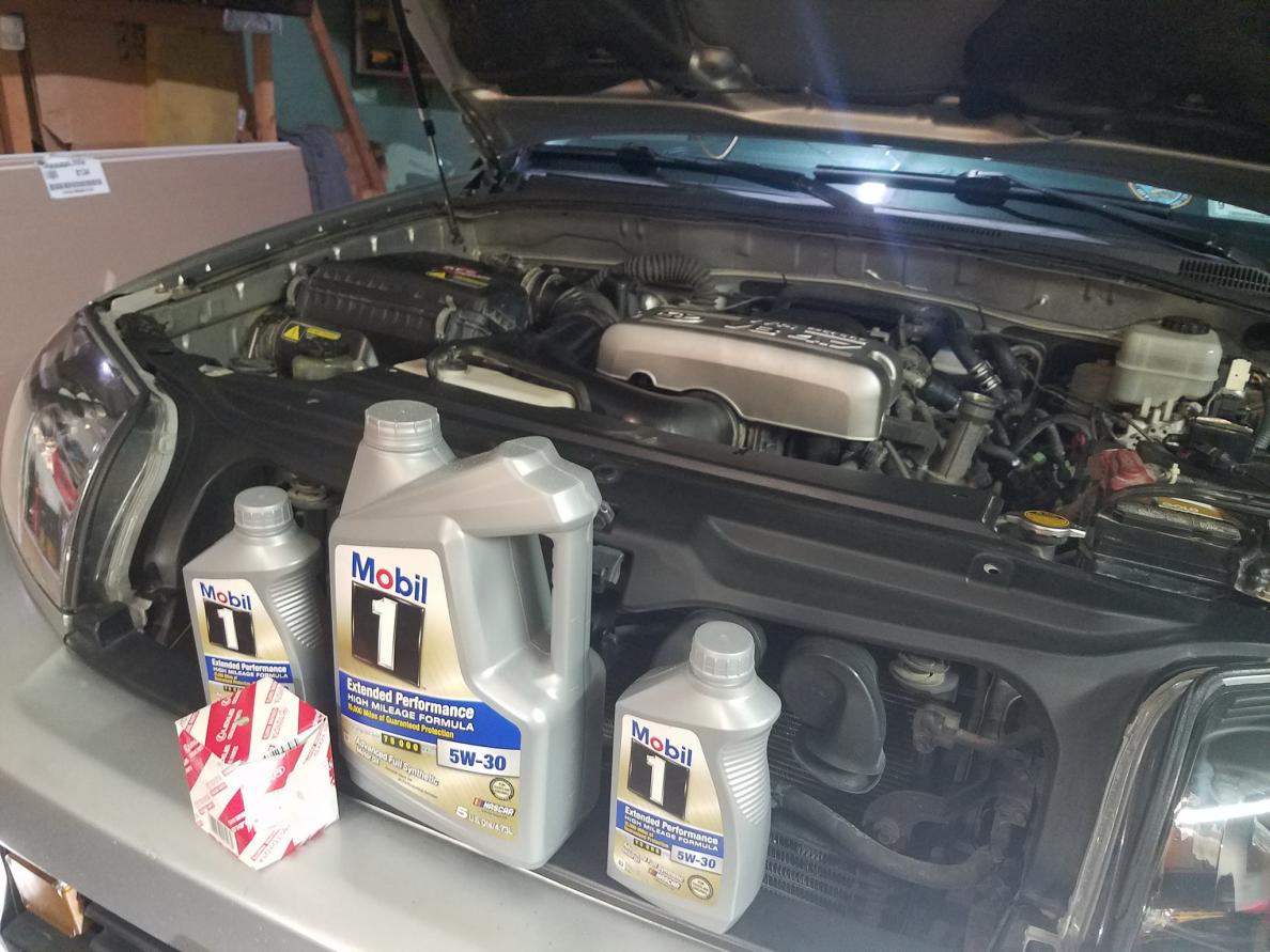

Have a Road trip to Maine planned this weekend. Getting some much needed mods and maintenance done in preparation for the trip over the last few weeks.
-Fresh Oil change mobile 1 high mileage extended 5w30 w/Oem filter
-Rear diff fluid change with Redline Heavy Shock proof 75w90
- Cabin Filter changed
- Freshly cleaned Pro dry S engine filter
- Greased drive line
- Rotated tires
-Replaced steering wheel clock spring due to airbag light staying on and throwing airbag code.

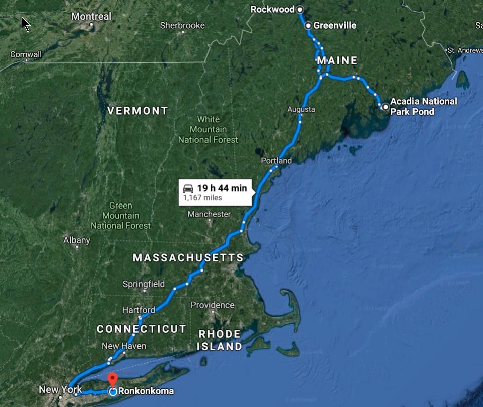

Another successful on and off road trip in the books. About 1500 miles total travel from LI to Moosehead lake in Maine, then over to Bar harbor and Acadia National park. About 150 miles of off road exploring on logging roads and trails. Truck performed flawless.
-Durobump front bump stops were a notable excellent upgrade before the trip.
Avg Mpg- 17.4 GPS and Pump Math calculated
