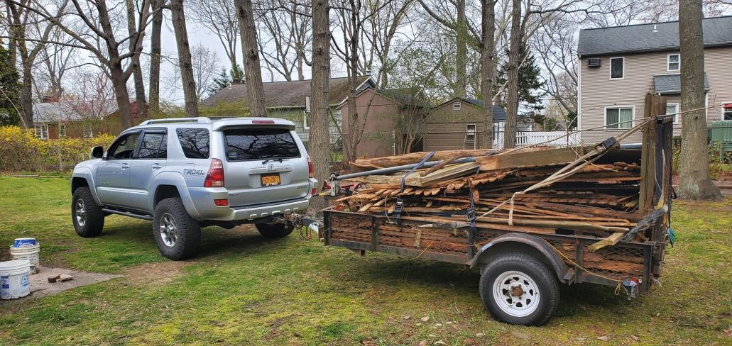

Putting it to work during the quarantine here in NY. Cleaned out about 3500lbs of debris from the depths of my yard. No issue at all.

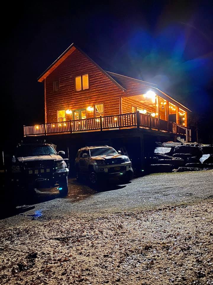

Quarantined in the North woods of Maine for a while.. 500 mile trip Averaged 18.3 MPG..

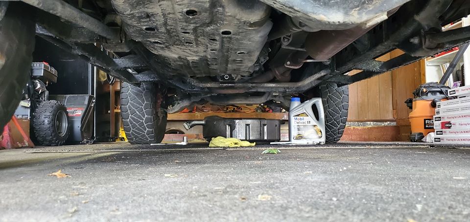

Truck has a fresh detail
-Changed Transfer case fluid with Mobile 1 devlac HD 75w90
-Cleaned throttle body
-Cleaned air filter
-ReTapped all skid bolt holes with 15MM stainless
-Repainted skid plates
158,600k

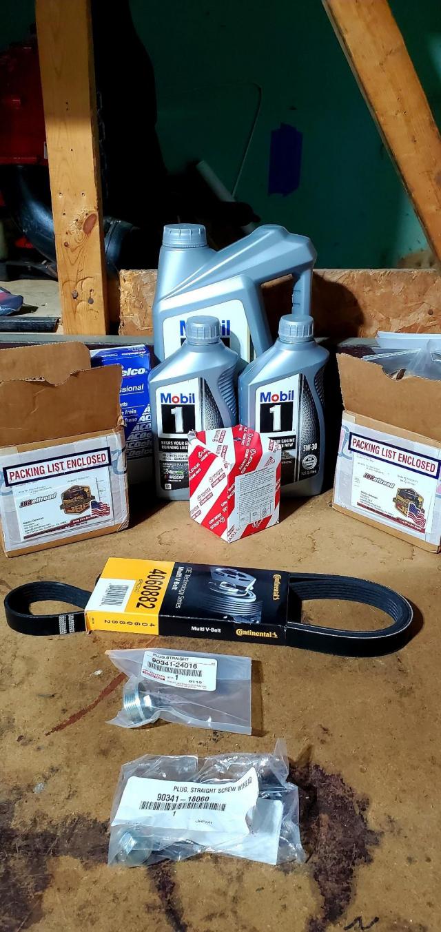

Annual Spring refresh-

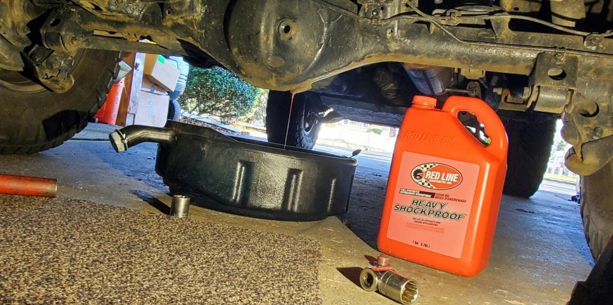

Changed Rear diff fluid with fresh Redline HD shockproof
Need to do-
-Clean up frame
-Front diff fluid change
-New Upper Balljoints
-Grease driveline

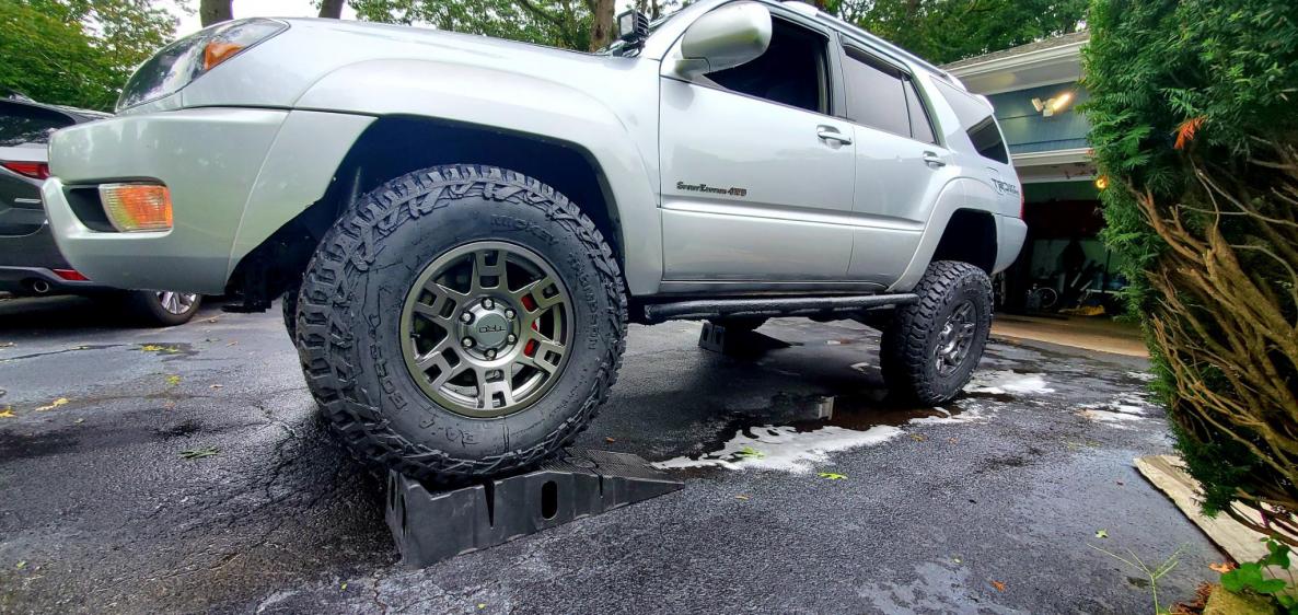

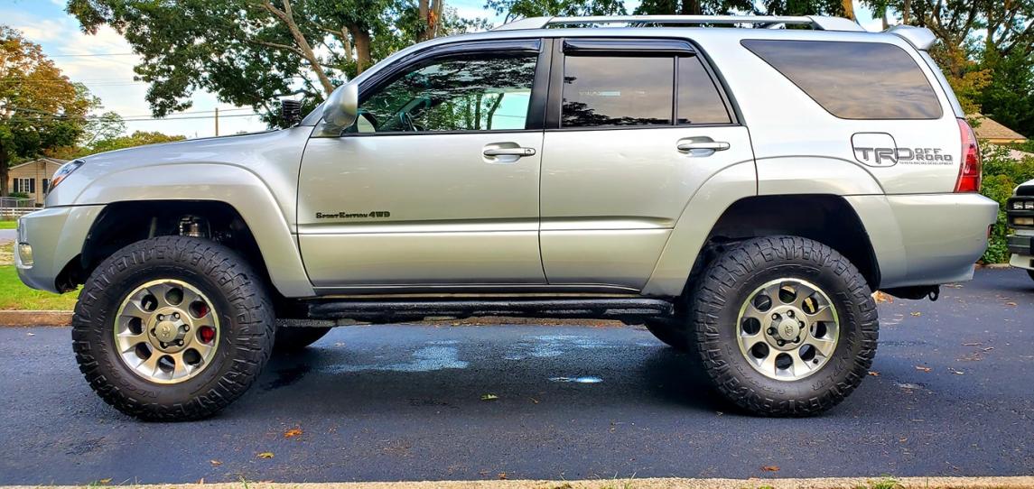

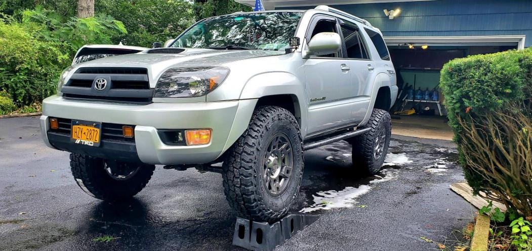

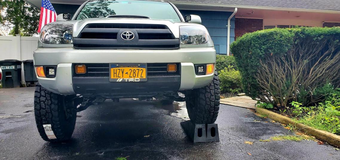

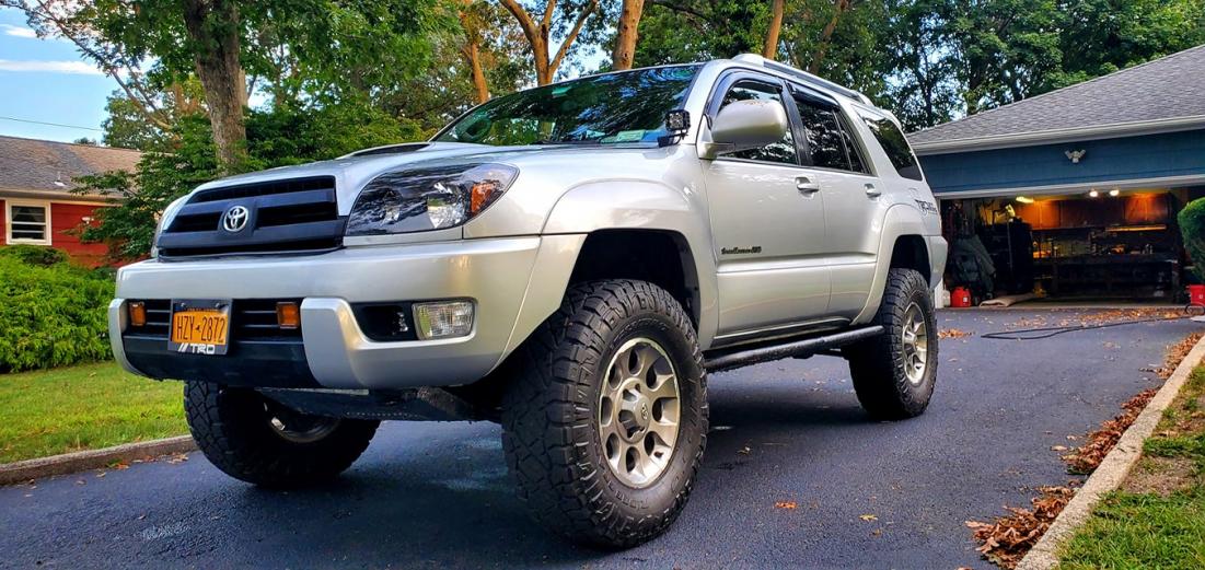

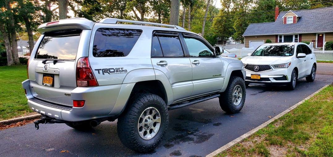

The 4Runner is Officially on 35's @ 162,321K
Upgrades and Refreshments!
-Mickey Thompson Baja Boss AT 35x10R17's
-Genuine TRD SEMA edition Gloss Gunmetal Wheels
-New JBA HD Upper Control Arm Bushings
-New JBA HD Upper Ball Joints

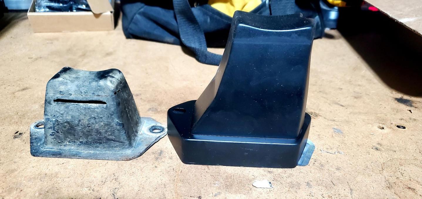

-DuroBump Rear extended Bumpstops
-Seat Jacker driver's seat mounts
-Silver Rhino Washer Bottle Relocation Kit
-Serp Belt replaced
-Front diff fluid changed to Redline HD shockproof
-New Lexus Front diff drain and fill plugs

Looking good dude!

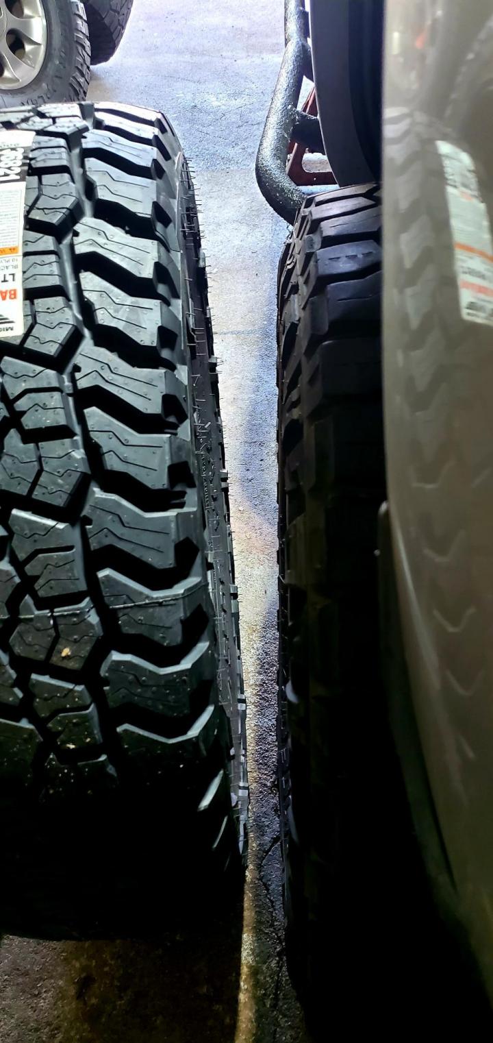

I see your wiper tank and it reminds me I need to do mine lol. on hard left turns mine will contact and then abs will kick in because it doesn't like one tire trying to stop haha. Also limiting turning at full stuff
Looking good dude!
Thanks!! Yeah im loving the new tires.. the washer tank seemed to be an issue for alot ot Toyota's going to 35's.. so I figured why not, it was super easy.. However, make sure your not in a rush and empty your fluid tank before you just start pulling the spray pumps out... ask me how I know LOL.
Yeah haha that's part of the reason I'm putting it off. I put a whole gallon in like a month ago lol
What's happening to the trail wheels now that you're on the pro wheels?
Looking really good!
I'm looking to purchase the same wheels. Did you have any issues with them fitting? I see you have spacers. Did you try to run them without spacers?
Wheels fit great, I did not try without spacers, but I believe they would probably work.. I like the slightly wider stance with the skinnier tires.

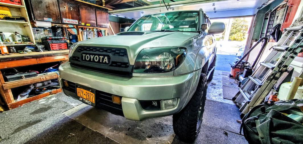

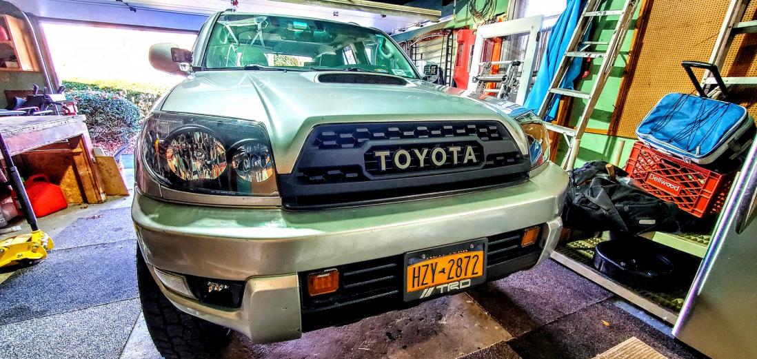

TRD Pro Style Grill upgrade!
