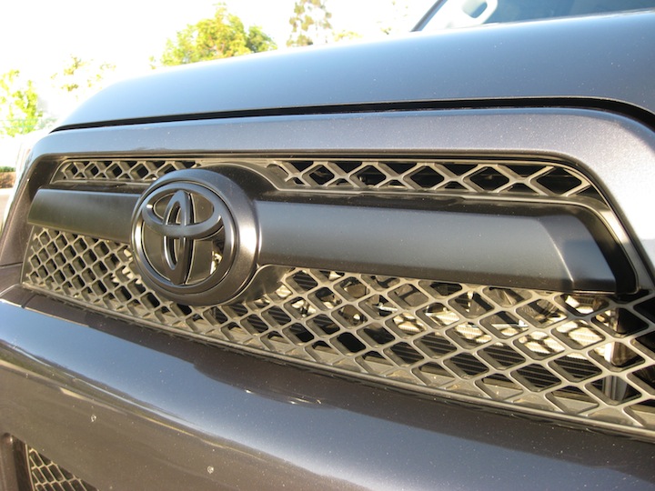

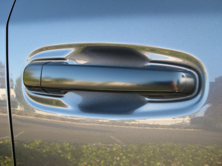

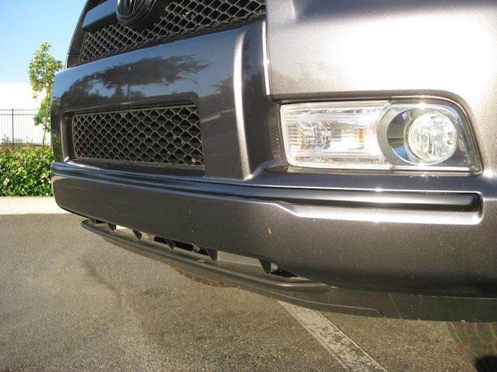

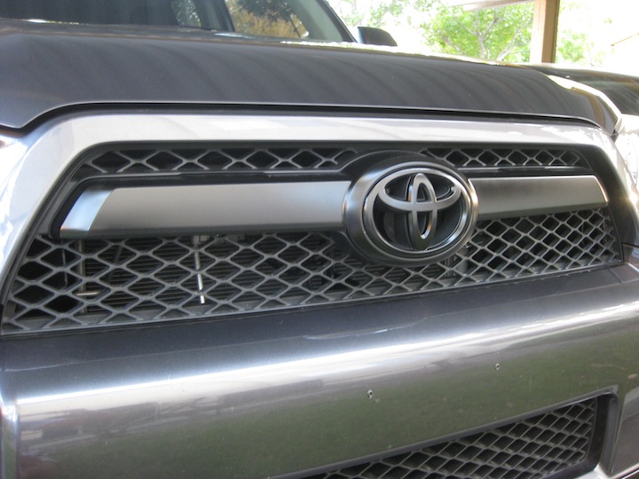

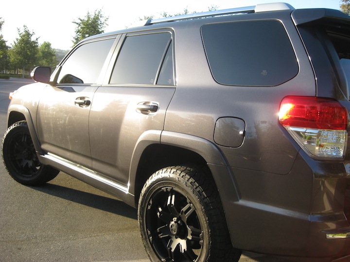

Continued with some of the mod projects today. Debadged and blacked the chrome. I only had time to black the front emblem/grill and chrome strip, and the door handles. Rear chrome strip is definitely next (leaving rear emblem/garnish chrome). Not too sure if I will black the rocker strips and roof rails cause I might get sliders and a new rack.
Big thanks to doodman for his awesome writeup!

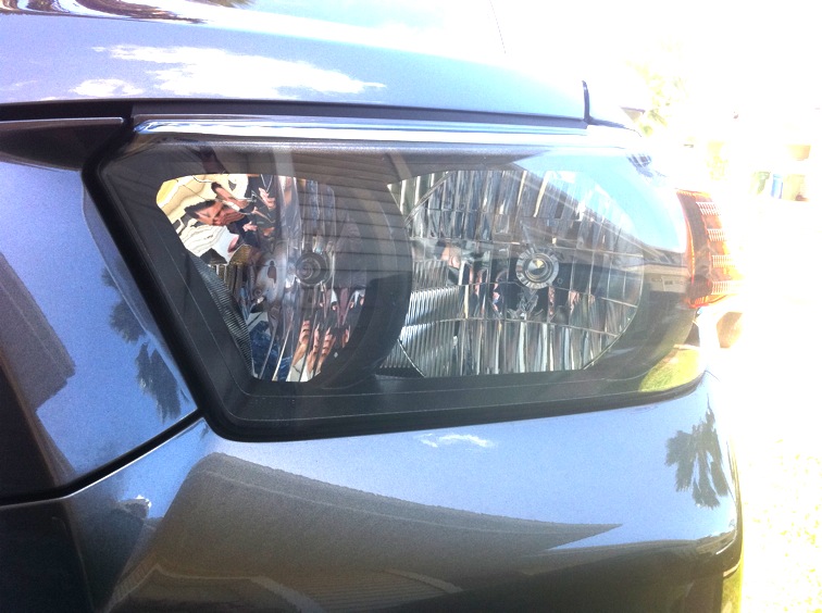

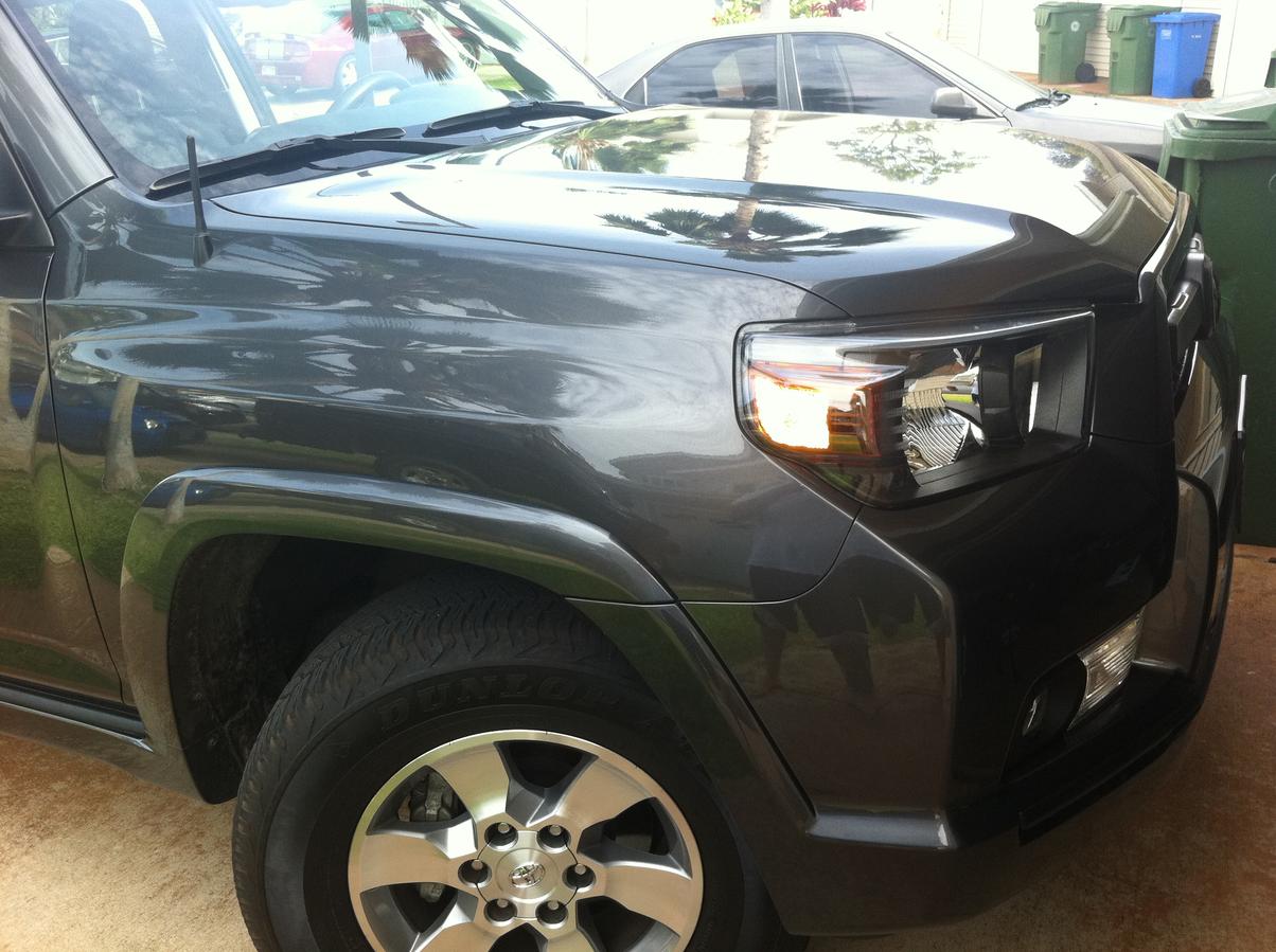

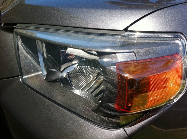

I finally got a free day and took the front of the truck off to get the last of the chrome pieces and take my headlights apart. I was super nervous about rippen them apart but I love the results. I used krylon that is close to the mag grey, looks awesome.
^^ that's the only pic!? I think you're the first on this forum to black the headlights (with the exception of philsey, but his are in a league of their own). Post more pics! i think more members with SR5's and Limiteds need to do this mod! good job!
Please give us more! A front end shot and maybe a headlight alone shot would be great. Been curious about the possibility of this mod.
I did this mod on my 09 Tundra. It is pretty easy to do but very nerve racking sticking your headlight in the oven. I'll do it to the 4runner once it warms up a little outside. Still in the teens here.

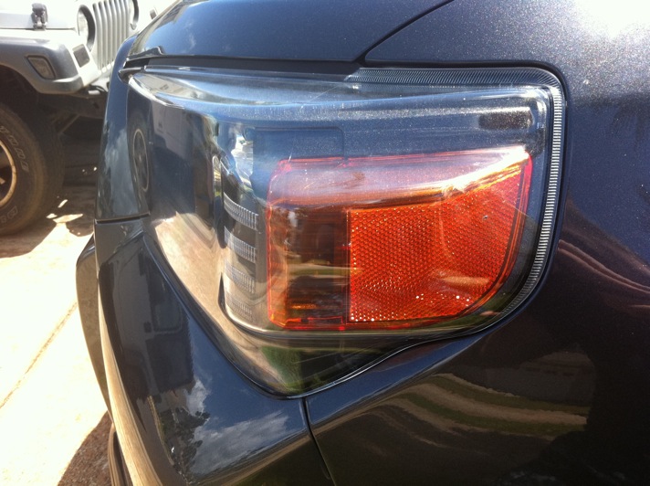

Here are some more pics. I can't stop looking at these lights now. FAVORITE mod so far.
