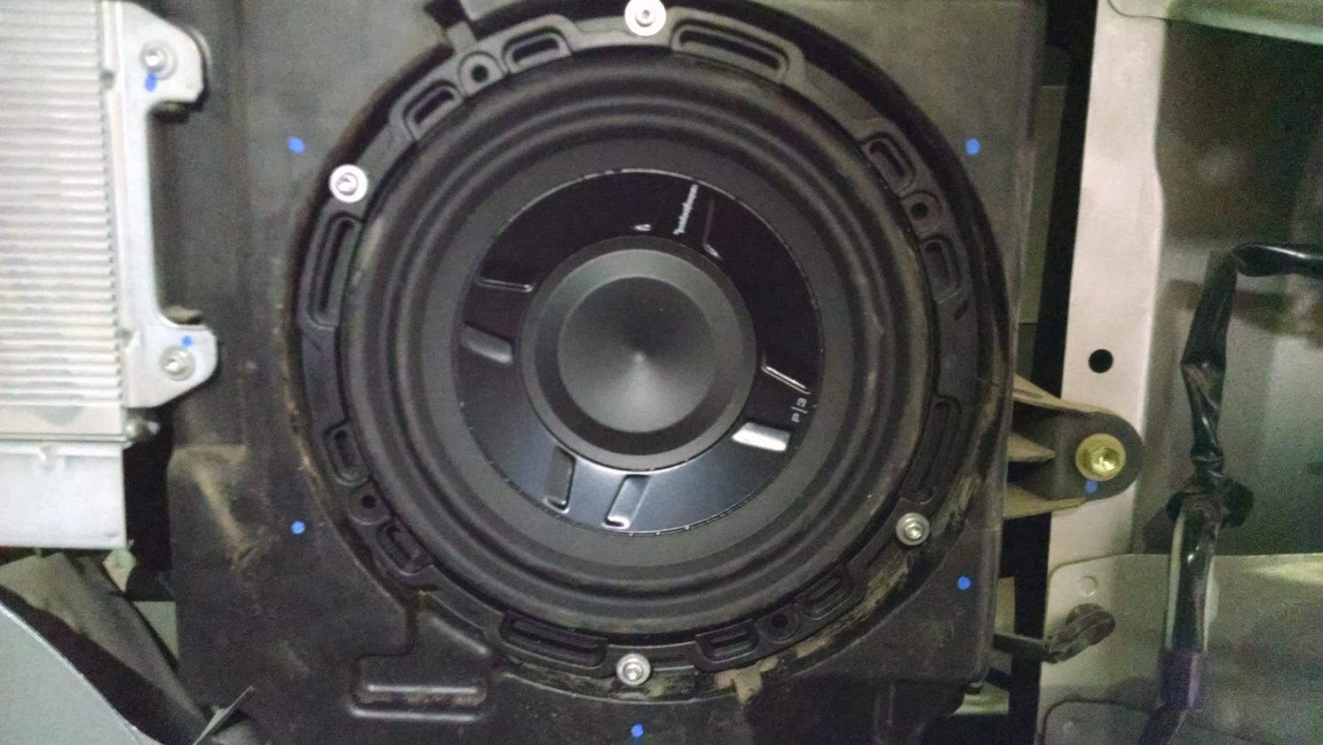

The holes for the new sub are not exactly aligned. I just drove new ones throguh the plastic as needed. Seesm to be holding up so far.

As stated already, this subwoofer is the SHIZNIT :thumb3: Not only is it shallower than the OEM subwoofer, it's also mondo heavy and SUPER easy to install.
The holes don't line up and I didn't bother with screwing through new holes. I simply used the factory screws to hold the sub in place by the outside perimeter. So far the sound is awesome. OEM speaker cone was COMPLETELY torn 360degrees!
***Note: I used the EWD to figure out the POS & NEG wires from the amp to the sub. However, the EWD does NOT show you how the wire colors at a connector located on the left of the amp. They're basically using a short extension to the sub and didn't maintain the same wire colors. So, pay attention to the color and polarity. ****
I took a pic with the LED headlamp, so the quality is poor but you get the idea.
So now I have Rockford Fosgate speakers all around (minus the dash center and the tweeters) being driven by the OEM HU. This will satiate me for a while until I find a Scion FRS HU.
EDIT: I'm sorry for the stupid large size pic, not sure how to reduce them. Sure mucks up the viewing of this thread though
