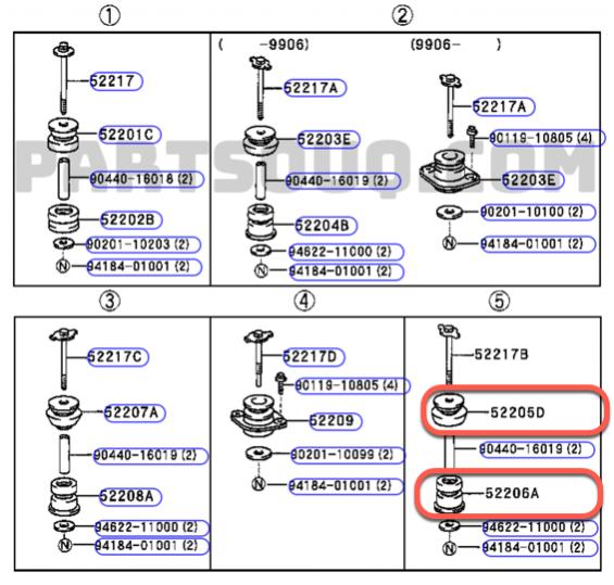

Does this look correct for upper bushings/mounts? Going from front to back on the truck:
#1: 52201-35090
#2: 52203-35200
#3: 52213-35011 (replaces the discontinued -35010, I think)
#4: 52207-35040
#5: 52209-35010

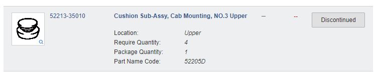

For #3, TPD says that 4 are required. Is that wrong, and only 2 are needed?
yep that looks correct to me, not sure where your seeing 4 required? everything on the Qty Required shows 2 for me?

Yes, when I put my VIN in at Toyota Parts Deal, it shows 4 required for the discontinued part number for top bushing #3. Figured that was wrong, thanks for confirming... think I'm finally done asking questions now.

if you look @ the same diagram for a 2000 you will see the updated parts. I don't know why they show the parts for a different VIN but restrict the parts to your VIN, they just do it that way. it's stupid and confusing.
Is that why PartSouq and Amayama aren't linking these part numbers for my '96?
Japan-Parts specifically shows these 2 bushings as "not applicable" for my VIN.
