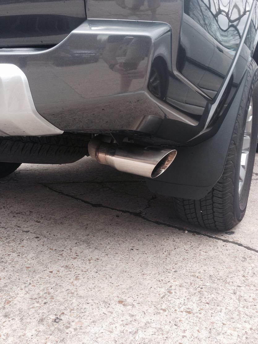

This is easy to install on any exhaust system. Any decent muffler shop can fabricate a 90 degree bend and install it at the end of the exhaust, with your tip of choice. I would look for a dual wall, semi insulated tip for under the body fender.
This is a good idea too. As several people have said here, it brings the tip close to the wheel where it's less likely to drag and sends the fumes away from the tail of the truck where they get sucked up the backside. If the back window is open, exhaust will come in with any tail exit exhaust.
I just installed this last night. Fits perfect and sounds great.

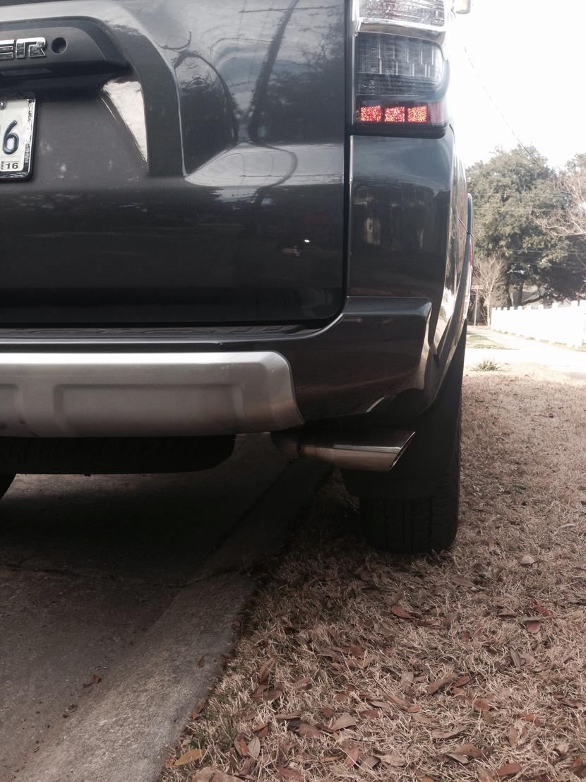

Side exhaust exit
