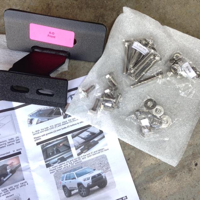

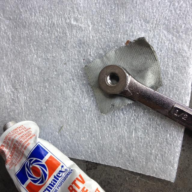

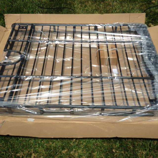

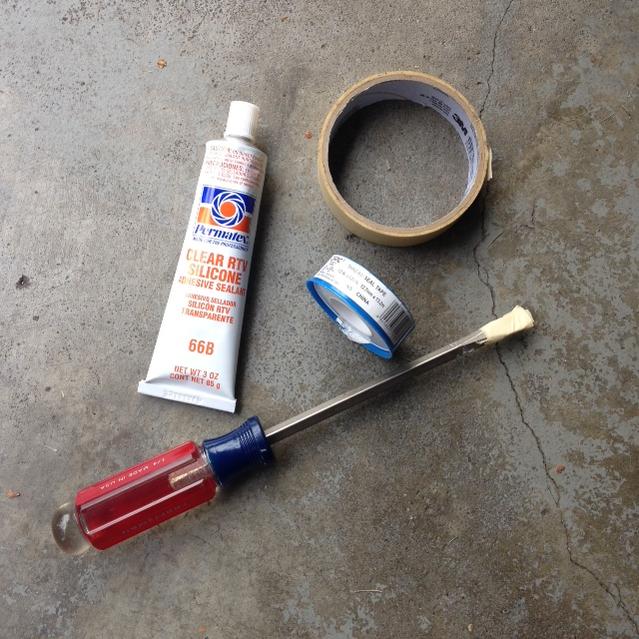

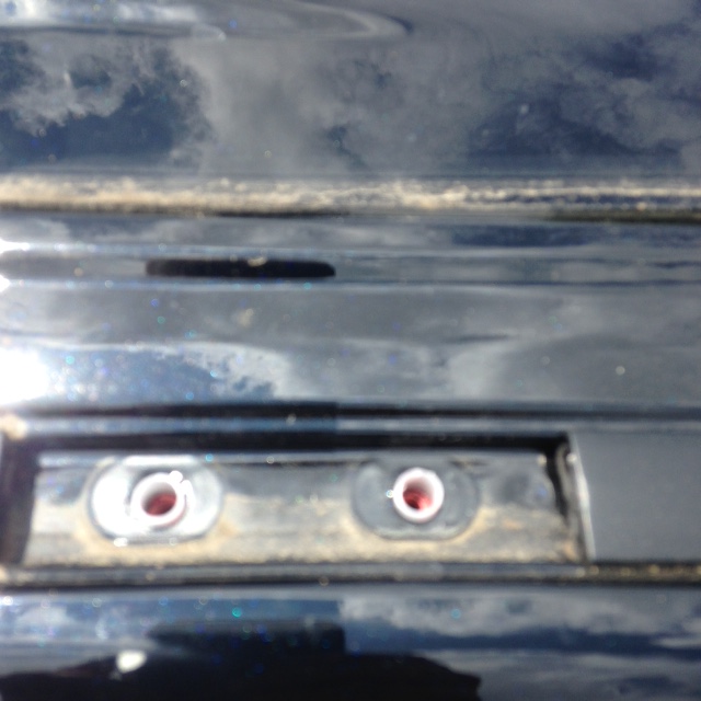

The rack arrived today, got it on by myself in about an hour and a half. Biggest pain was getting the 8 mounting bolts that mount the basket to the brackets. There is not enough room under the rack to get a good purchase on the washer/nut so it was a bear. Easiest way I found (and Im sure there is probably an easier solution and Ill feel stupid after someone posts it :lalala: ) is to use some 100mph tape and a box end wrench to hold the nut. I found that a small dab of RTV to hold the washer on the wrench worked well. That is the only way I could get enough reach to get the nut under the short little bolt that goes down through the basket into the bracket.

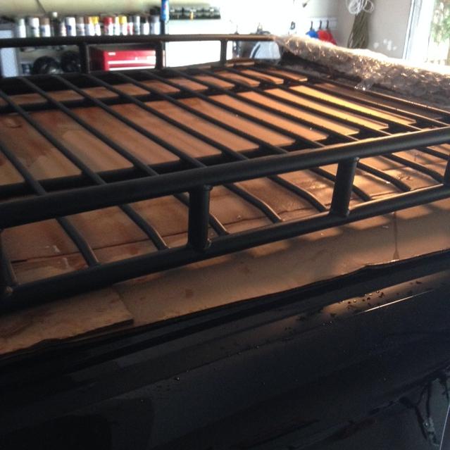

Was able to mount the rack by myself by using the packing cardboard on the roof to prevent scratching. The rack itself is easily lifted by one person, just place (don't drag) it gently on top after the brackets are on.
As others have suggested, plenty of RTV and Teflon tape wrap on mounting.
Instructions were stupid simple and easy to follow. Baja did a great job of making them very clear and easy to follow. All parts are marked well and manageable.

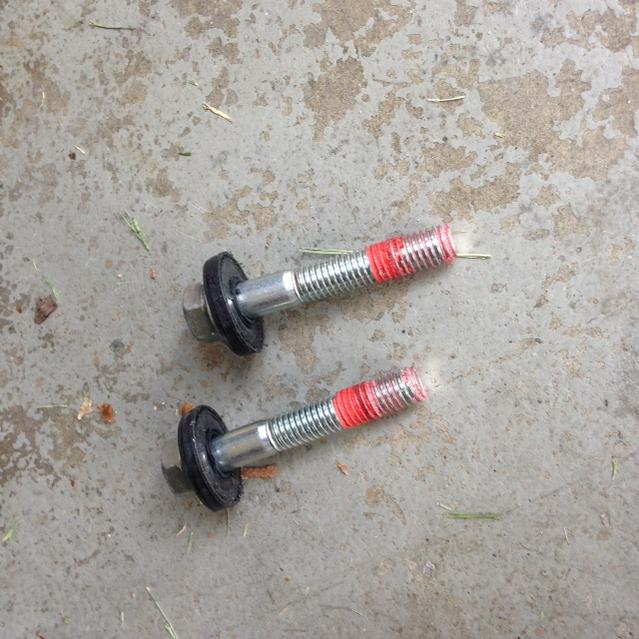

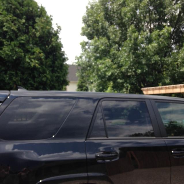

Stock bolts in the rails were coated (very little) with red RTV, easy to remove with a 12mm socket. Plenty of tape and patience on the removal of the rail covers made it painless.
Hope this helps someone out!
