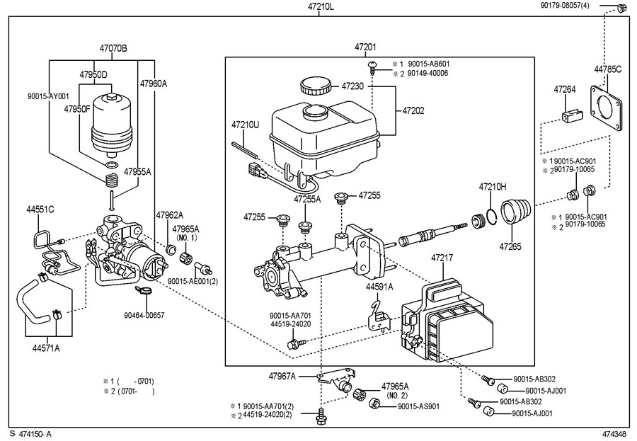

you may be able to rebuild it; however, I've never torn into one and I've heard [MENTION=66389]BlackWorksInc[/MENTION] say many times that they are not serviceable. the way the break down looks though it looks as if you can replace the failing componants it would just be a matter of bleeding the system when rebuilt and releasing any pressure in the system before tearing into it

According to Toyota they aren't serviceable items, but there is a 11 page instruction on how to tear them down and rebuild them in the FSM, yet Toyota doesn't want you doing that...
That being said, I tore down my old one to see how to diagnose these units more effectively and/or find more pinpoint methods to isolate issues in the assembly. I haven't really found anything of use in terms of diagnostics yet.
Most shops won't touch rebuilding them with a 10 foot pole and I would be wary of them trying in some cases. You could try and replace just the master cylinder portion yourself (assuming that's the only failed component in the assembly) which is 47201 in the diagram and will come with a new ABS Solenoid Pack/Module. At which point you've still got the old Accumulator Pump assembly, which seems to fail for some members over time anyways.
In my honest opinion, Toyota is probably on the right idea with just replacing the entire unit. They aren't very friendly to being taken apart and you're going to buy half the unit just for the MC portion.
My old Hydraboost unit failed because an O-ring in the MC portion failed, the only issue is that I can't get a new O-ring without ordering half the unit anyways, so I had to get a replacement unit.
