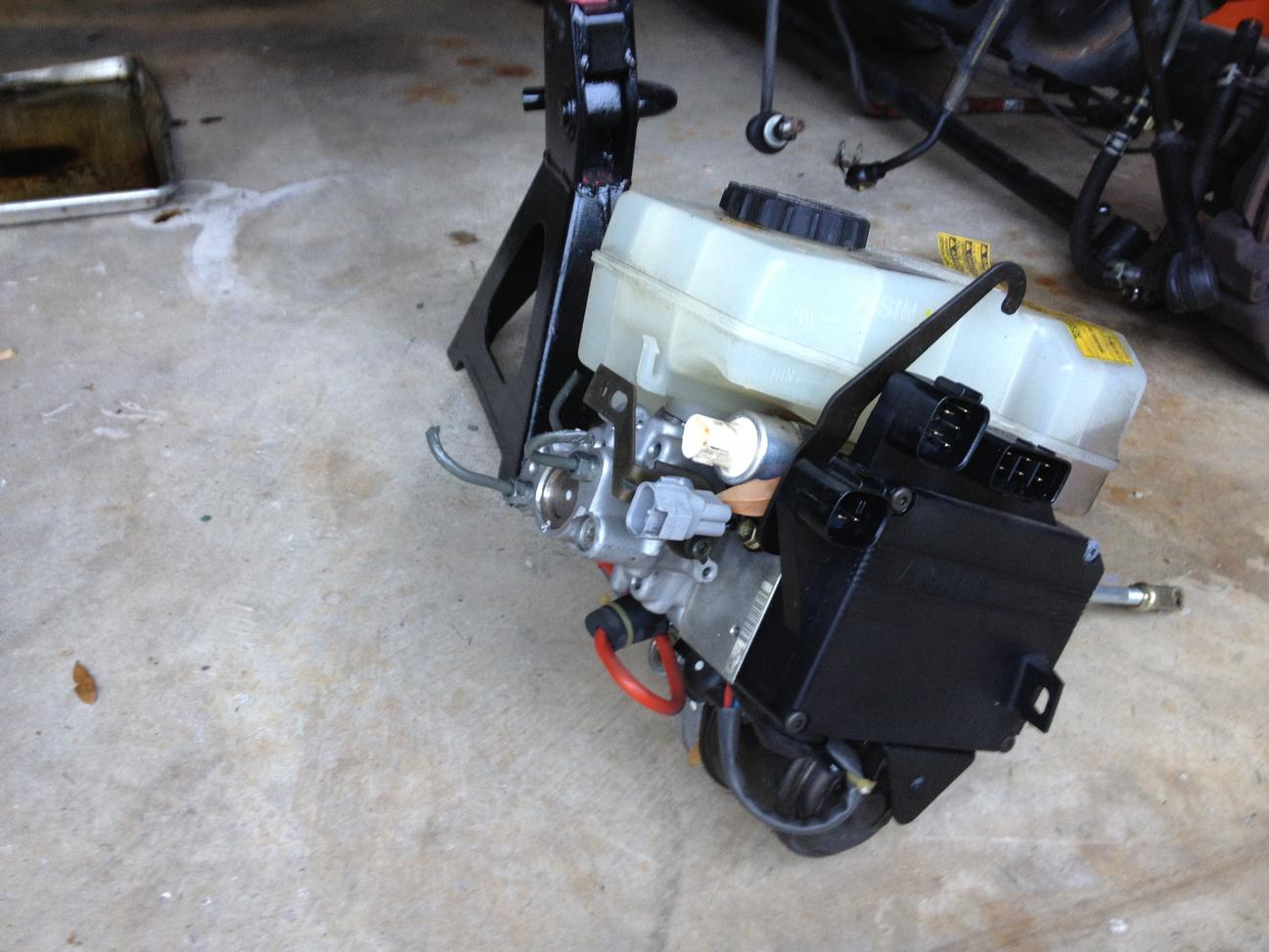

Here are the pics of mine....again its off an 03 w/112k miles on it....only difference i see from the sketch posted is the computer on the side which i believe is the traction control/abs module...not sure what the module on yours looks like

They have different connector/pin layouts. I haven't had the chance to tear apart a post-'05 unit and see if the valving/holes for the solenoid pack are the same so I am unsure if you can just swap modules. Hence why I said there might be a compatibility issue.
