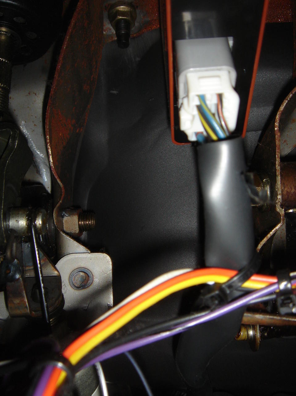

Fixed - cushion. Where does 47101a go? I noticed when I changed the brake booster, the spring came off and I couldn't find out where it goes.
can you see the diagram posted above?
it shows where the cushion goes.
the little nub will stab into the hole on that bracket.
I looked at my brake pedal this morning. The spring on mine, is on the right side of the pin. It connects somewhere near the left side of the steering column. You may need to remove the lower cover to see where it might hook to. Attached is a picture of mine, I tried to get my camera in as much as possible. Hope it helps.
Sweet, thanks bud.
