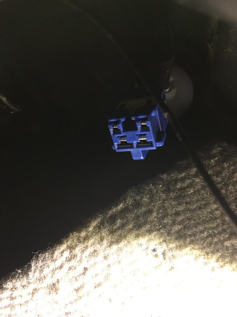

was too busy to stop at the dealer today. did unclip the brake switch from its harness and used a test light to check the power few through it. with the key off and the key on, same result: in the pic, the lower left and the upper right generated light. didn't see any loose wires anywhere under the dash. also, reiterating that the brake lights run with or without the switch even attached with the key on.

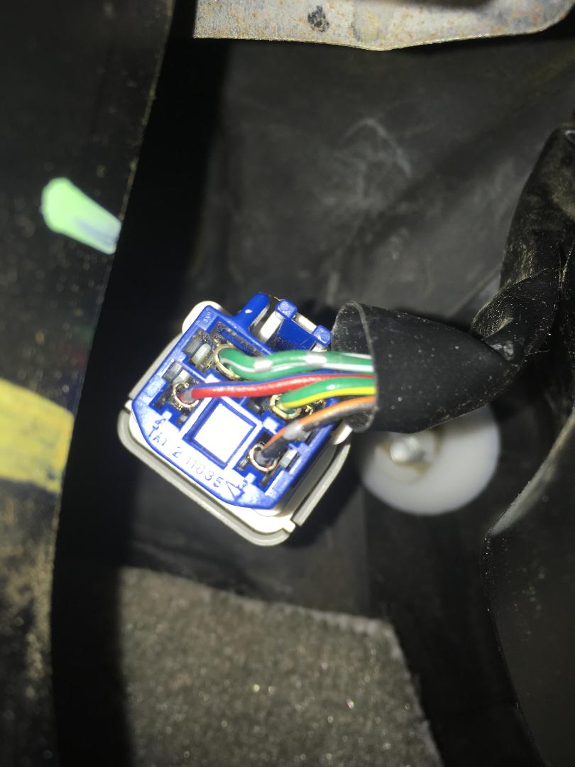

What did the other terminals do? Can you get a picture of the wires/color behind the connector also? Don't take it to the dealer and disrespect yourself sorry but you can do this yourself. Post the pics I think I have the same circuit set-up. I don't know what they're teaching you in college but a little electrical engineering should be a f_cking requirement!
using just the test light, the other two terminals did not light it up in any key mode. positives and grounds?
sure, i can post whatever pics you want! btw, i would not feel any negative emotions getting shop assistance. wouldn't want to pay much, and could possibly do the repair myself, but this diagnostic step is taking everyones time. we all want an answer!
