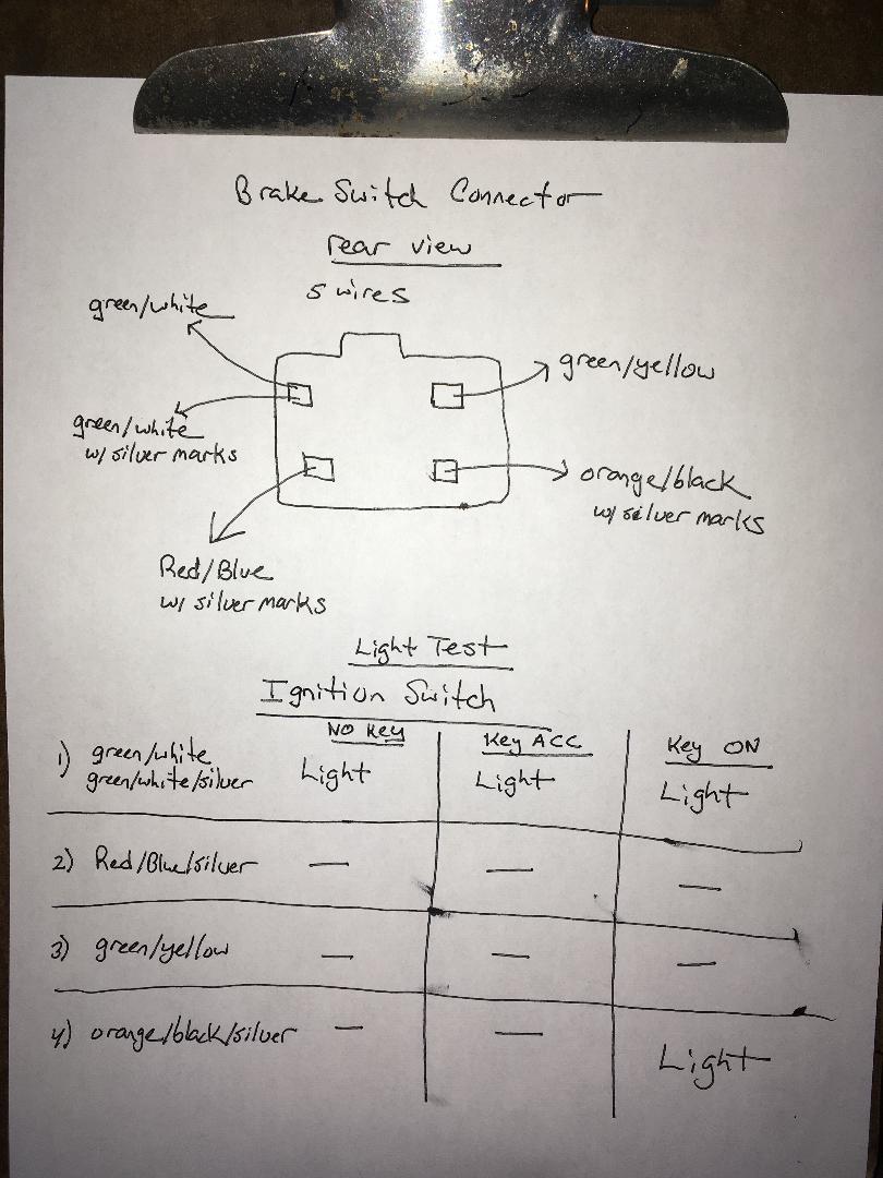

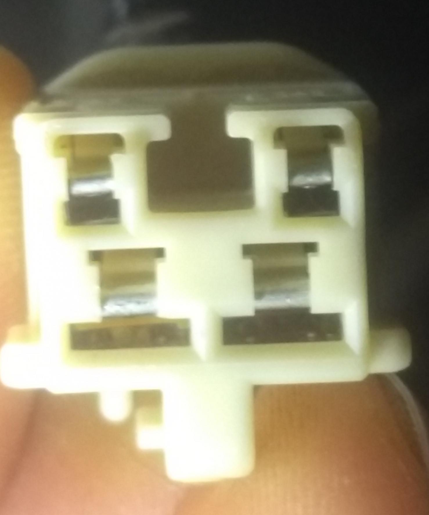

was too busy to stop at the dealer today. did unclip the brake switch from its harness and used a test light to check the power few through it. with the key off and the key on, same result: in the pic, the lower left and the upper right generated light. didn't see any loose wires anywhere under the dash. also, reiterating that the brake lights run with or without the switch even attached with the key on.
My connector is the same in layout but a little different in colors. Lower left is your constant battery power green/white wire. Mine is the same there. That is the only terminal that should get voltage with the key out and/or off or ACC. The upper and lower left should get power with the key in the on position. The upper right is the switch's ground, for my truck the wire is black. Yours appears orange black. You say that upper right is getting power/lighting up connected to ground. A good ground should light up with your test light connected to battery power. There's the problem. I would think you have an open ground.. to check connect your test light to battery power and touch to the upper right terminal, orange/black. It should light up if your ground is connected..

so, is the blue plastic connector replaceable (do the wires easily disconnect)? wondering if something is amiss there. thinking, power is always flowing through the connector to the brake switch (operate it without the ignition on). with ignition on, with or without the switch, power is bypassing the switch and going to the brake lights.

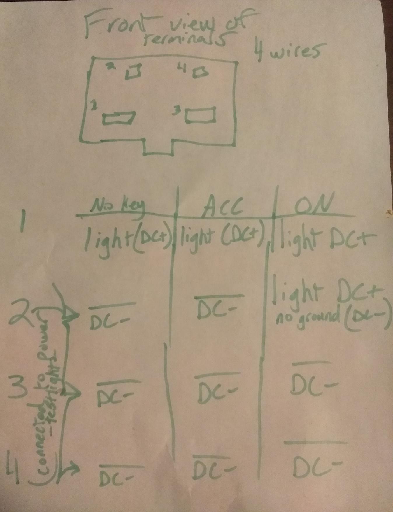

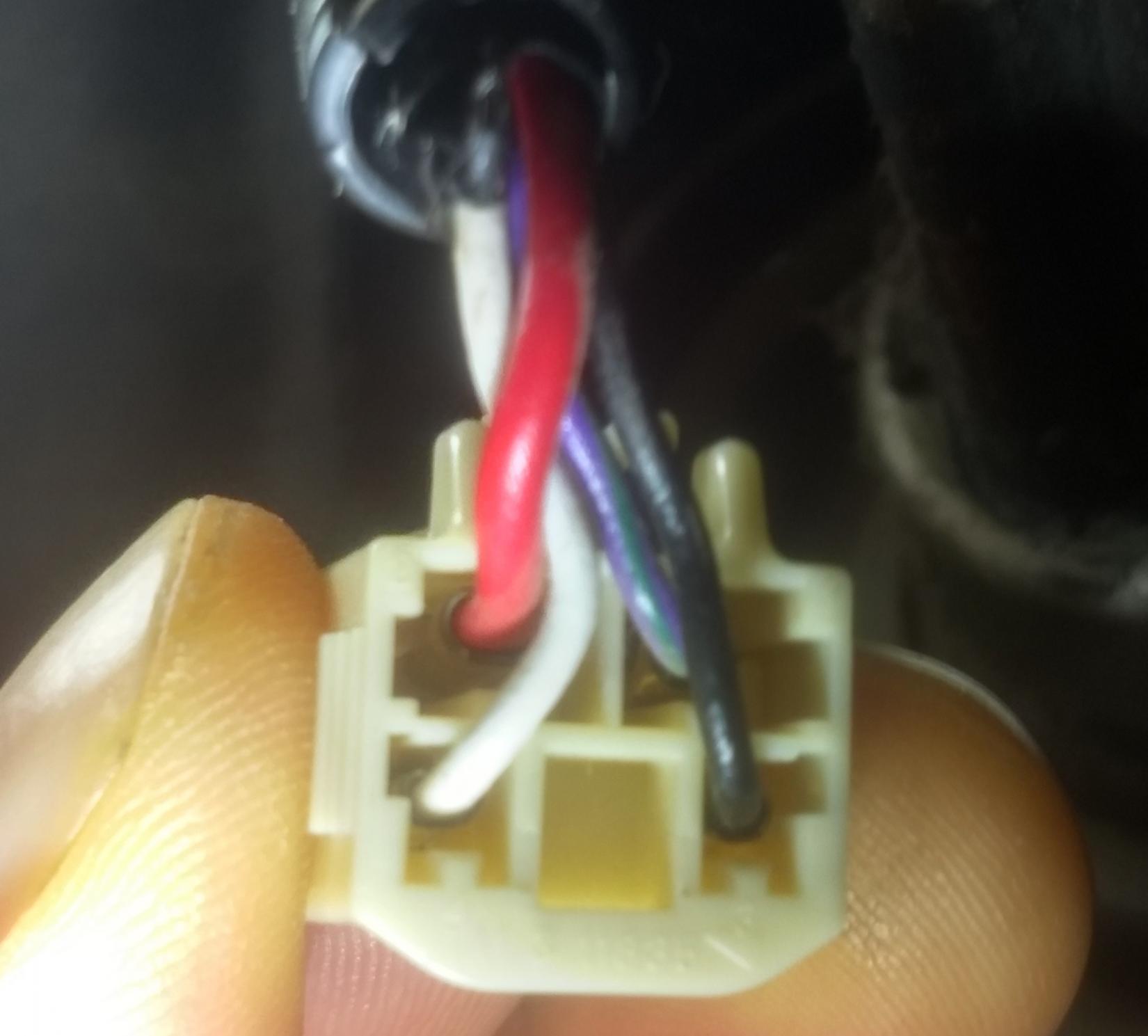

I made a chart for you in the same manner your mind works so I hope you understand it. Here is the correct way it should work. I don't know what that 5th wire is. The green/white with silver is unknown to me. Is that supposed to be there?? That's the constant battery power terminal (red wire in my photo #1).
DC- on my chart means test light illuminates connected to battery power indicating good ground connection..

what 4runner did you have? five wires are factory installed. owned since new, and nothing there has changed. maybe because of the factory tow hitch? the silver is markings on some of the wires, referencing something during assembly?

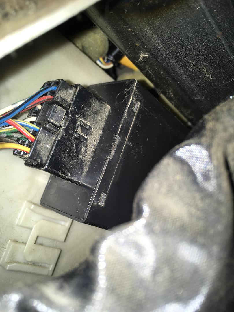

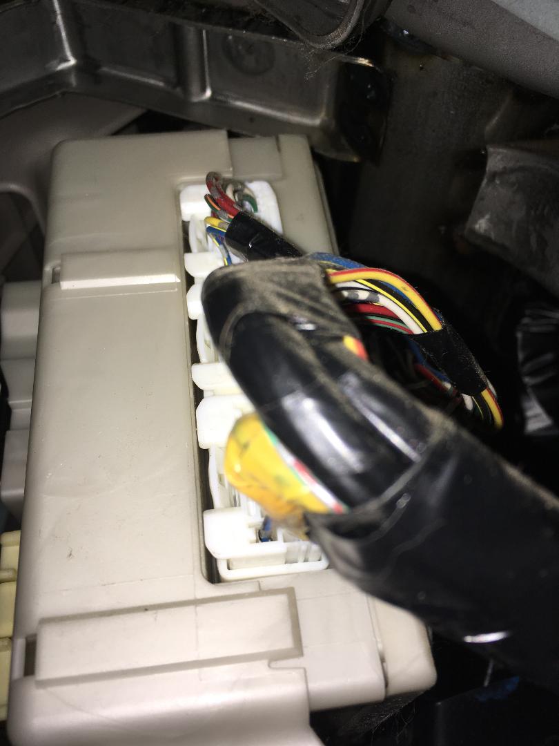

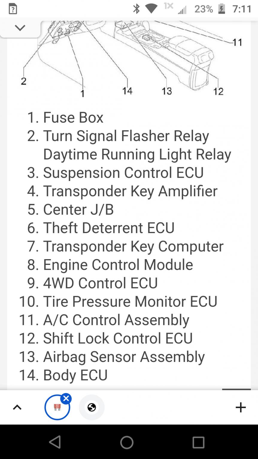

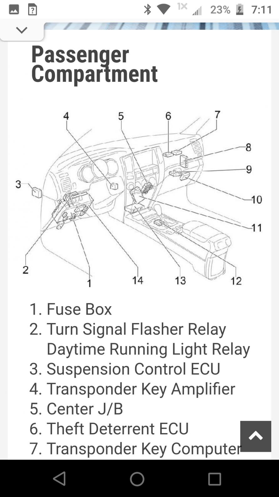

crawled into the footwell. took two pics. first is the backside of the fuse box, with the three harnesses coming out. the second, gray box, is mounted on the backside of the fuse box. it seems to receive one of harnesses. is this the body control module? looks like i have to remove the lower dash, unbolt the fuse box, then access the gray box.

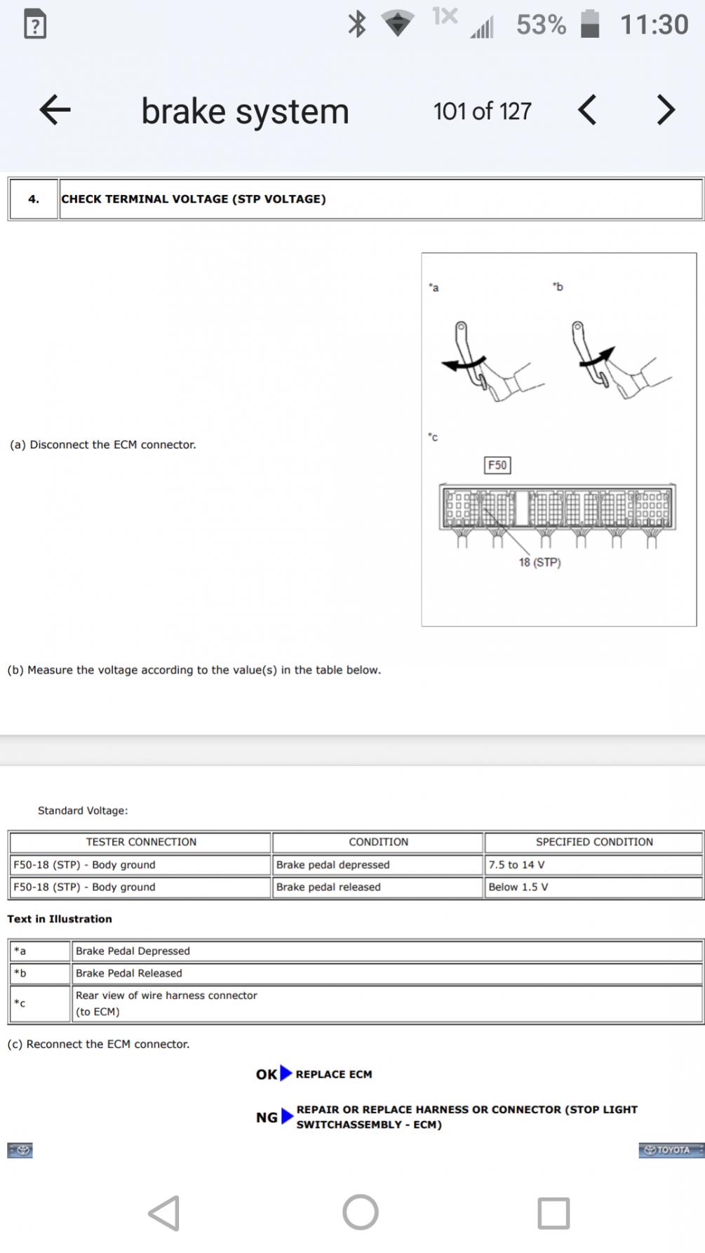

I believe the stop lamp circuit is an input to the power management control module not the body module. It's an input to the skid control module.
