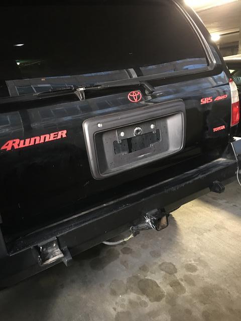

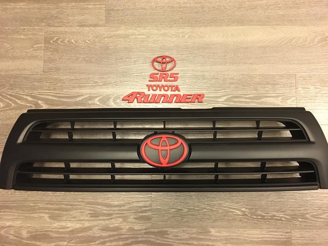

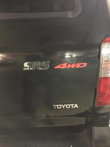

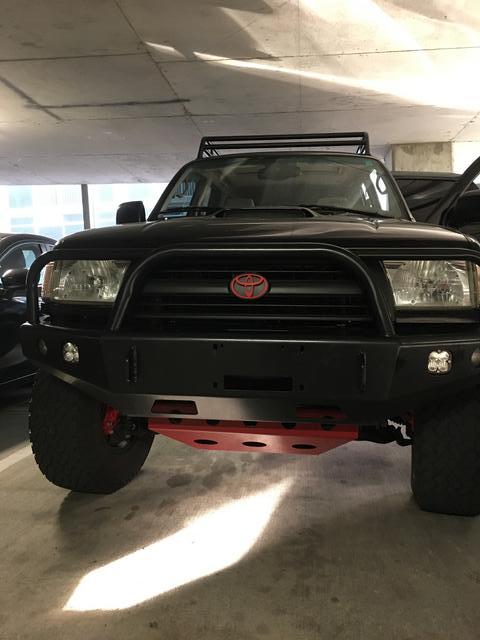

So the Black Pearl's front grill had some fading that had been bothering me so I started making a plan to clean it up. This soon turned into me kicking around the idea of adding some Matte red badging to the rig. After a trip to the store and staying up all night, I have a project I'm decently happy with.
Parts used:
100 grit soft sanding block
soap and water
double sided 3m automotive adhesive tape
1 can Plasti-dip black
1 can Rustoleum rubber coating Matte Red (Rustoleum version of plastidip)
Turtle wax adhesive remover
small scraper
I took my time and lightly sanded each piece so that it was roughed up and ready for coating. After sanding I would wash each piece thoroughly and let them dry for approximately an hour.
5 coats were applied to each piece with anywhere from 10-20 minutes in between the heavier coats.
This didn't turn out perfect, as some of the badges had some imperfections on them just due to old age, but I'm very pleased with how they look so far. I will post some pics of them on the vehicle later this evening once installed.
So I just got done installing the grill and emblems back onto the truck and I'm really happy with the look. I'm going to apply some clear coat over them now that I know I want to keep the color. I am by no means a professional painter so this was a learning process as I've never used these products before. Part of me already wants to pull everything back apart and fix tiny little details but I'm going to just enjoy the look for a little bit before redoing it to suffice my OCD. I am planning on also doing the license plate area in the same black that I did the grill in. Granted you don't see much of it with my tire carrier but I would like for it to look uniform.

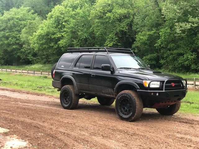

So after going to the Nashville off-road expo yesterday I was slightly disappointed. It wasn't as big as I had hoped, and everything was catered entirely to the jeep community. So instead of returning for day two, the GF and I decided to take the hour drive outside Nashville to Wooly's off road park. If you haven't been and you live around the area I highly recommend checking it out. The staff is super friendly and the place is a lot of fun. We picked a pretty bad day to go since it's been raining and was still sprinkling when we were there. If you know anything about the off road terrain in these parts, you know how bad the mud can be. Today was definitely a very muddy day and limited a lot of the trails that we could access. Even the trails we could get at, I was fighting the mud the whole time as it made the truck slide pretty much everywhere no matter what I did. All in all it was still an absolute blast getting out of the city and doing some wheeling for a bit.

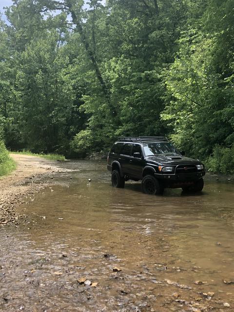

So far I definitely like them. They are super robust and give me a good level of comfort knowing they are there and will take a beating.
I haven't posted as much since I've been traveling for work quite a bit. However over memorial day weekend the girlfriend and I were able to make a short trip to the Tennessee dirt devil trail. These are super easy backroads with some fun river crossings. Nothing extreme at all but still fun and good sight seeing none the less.
