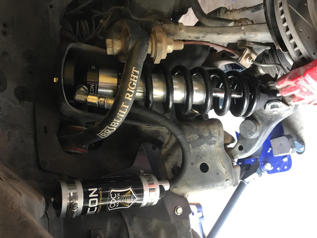

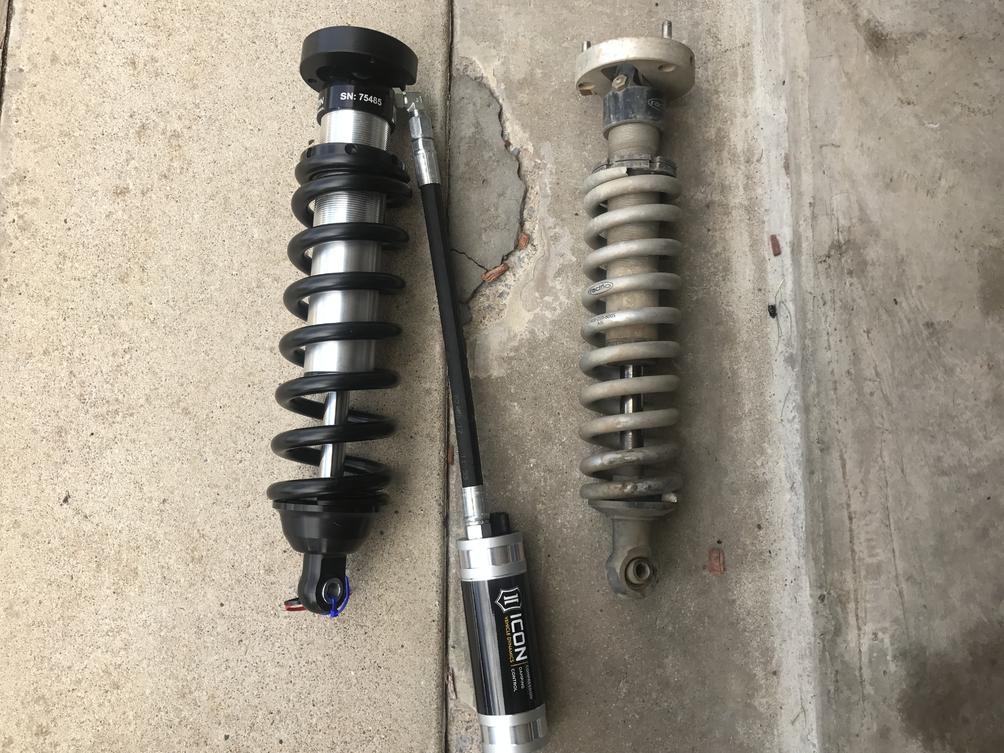

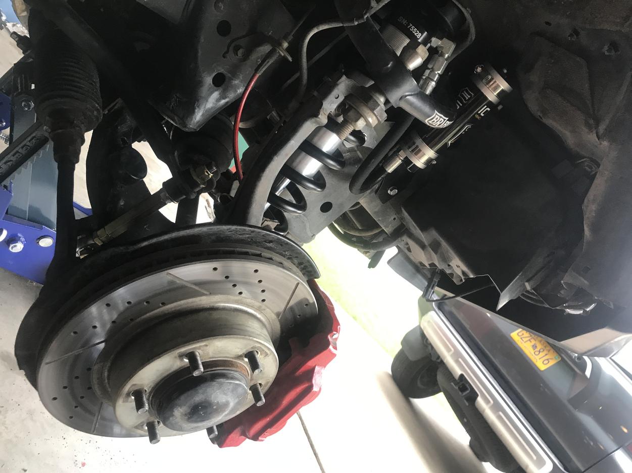

Out with the old, in with the new today. Finally arrived and I couldn't wait to get them on. They are in, but not completely in. Resivoir mounts aren't mounted. 39.5" to the fender well now. It's only set at 1.5". Holds the truck much better, but we'll see once all the armor gets put back on. Oh dear Icon, the next time I drop over $2k, do me a favor and throw in the $30 spanner for free. Holy things that I cannot say here...
I thought the exact same thing when I installed the coilovers. They're looking great in there, and I can't wait to see how your truck sits! I've really enjoyed how they ride on mine.

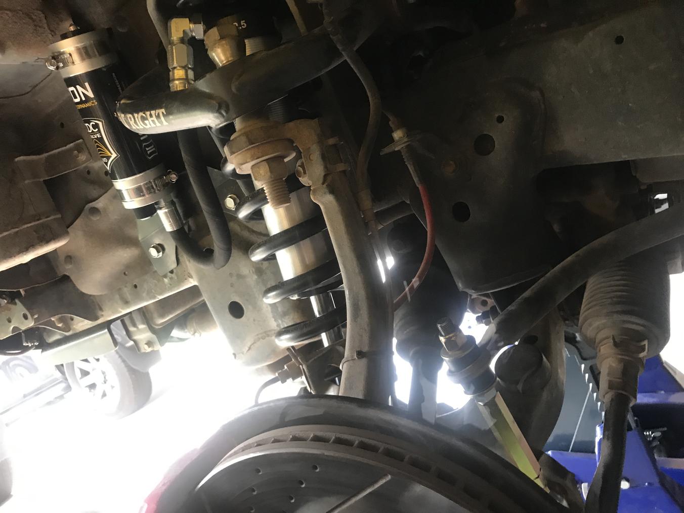

Finally all buttoned up with [MENTION=98153]MStudt[/MENTION] end links on there. Had a case of the dumb, and couldn't figure out how to put them together...:doh: Anyways it's all buttoned up now, got to order a spanner to adjust the drivers side. F you Icon for making me spend another $30. Going to go kayak fishing in the morning, come back and start taking the rear apart. Hopefully that goes as smoothly.
Sorry for the crappy pics, and PS I hate that it turns my pics sideways when I take them on my phone if I don't have my damn phone sideways.

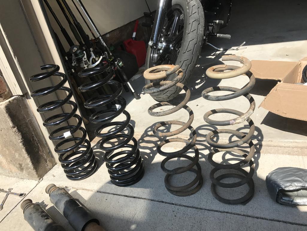

Put in the OME 861's today at 255,203. If all goes well I should have the mounts dabbed up and in for the 2.5 CDCV rears tomorrow. New springs and put the new sway bar end links on.

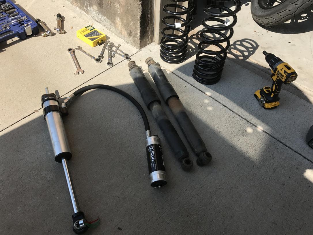

Look what came in today!!!!! Springs should be here tomorrow....then we just wait on the front coils to get here. I'm so stoked, really shocked at the size of the remote resi. There is my 30 oz yeti for comparison.

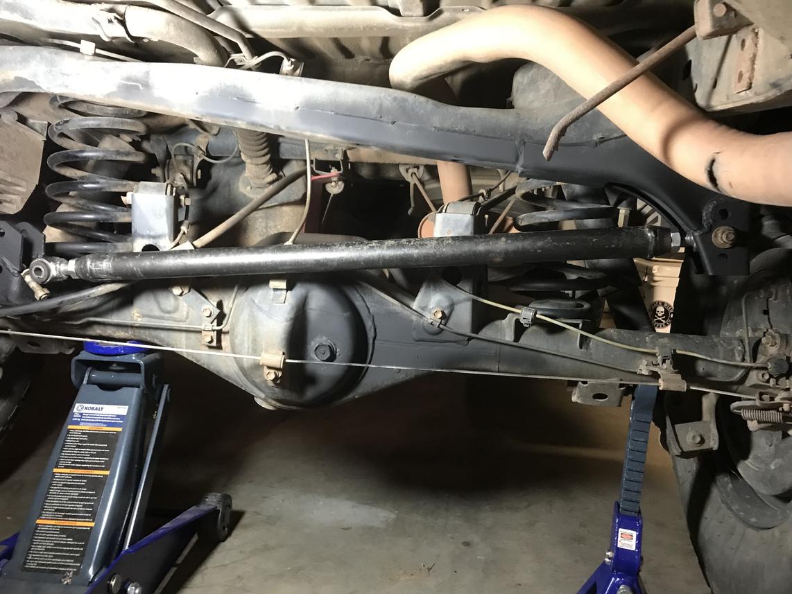

So last week I put in the raise/drop bracket from [MENTION=28464]eimkeith[/MENTION] and it went in great. Now the biggest problem I have run into is getting the axle re-centered. I am almost a half inch to the passenger side. My adjustable panhard bar is not making it any easier. It has become a real PITA. I’m open to suggestions at this point. I have the roof rack that I also bought from [MENTION=28464]eimkeith[/MENTION] all powder coated and sitting in my garage floor. Had the Icons in the front for a bit now.....still waiting to get the rears....12 weeks later. I owe yous some pictures of the rig updated and all. Haven’t been around much...between work and deer season I been smoked.

Now the biggest problem I have run into is getting the axle re-centered. I am almost a half inch to the passenger side. My adjustable panhard bar is not making it any easier. It has become a real PITA. I’m open to suggestions at this point..
Are you having issues getting your panhard bar holes lined up with the brackets or just adjusting the bar to get the axle centered?
If its getting the holes lined up, you could extend your adjustable bar to get the holes lined up then just readjust to center the axle.
If its getting the bar to adjust enough to get he axle centered, you can try a ratchet strap from the frame to the axle to try to pull it whatever direction needed.
what's your center-to-center measurement on the panhard bar?
Right now the bar is set at approximately 36 1/2". Sitting on the ground, bump stop edge to inside of the tire on the passenger side 2 3/4", and driver side is 2 1/4".
If its getting the holes lined up, you could extend your adjustable bar to get the holes lined up then just read just to center the axle.
So I had set my pan hard bar to 35.59" and could not get them lined up. I have flexed the sides, and messed with it. Cant get the holes lined up to save my life....I have tried the ratchet strap...it didn't want to budge.
I got this information from another thread and SS's panhard installation instructions but basically when the panhard is adjusted to the proper length, the mounting points should line up effortlessly at normal ride height.
This is what worked for me to get my axle centered:
1. On level surface with wheels on, I removed my panhard.
2. Loaded up my 4runner with my usual gear/load.
3. Drove my 4runner forwards & backwards a few feet then grabbed my trailer hitched & lifted up/pushed down several times. I repeated step 3 a few times to make sure my suspension was settled at ride height.
4. Adjusted my panhard so that the holes lined up with the mounting points so it could be installed without any force.
SS panhard instructions has a recommended length for a given amount of rear lift without a panhard lift/drop bracket. I don't have a lift/drop bracket but went through steps 1-4 to make sure my axle was as centered as possible & it turned out to be really close to SS recommended length.
Tried this.....I’m over it. F this thing. I broke a ratchet strap, thought I was going to drop the truck off the stands. With the lift and drop bracket it’s STILL at 37 1/4” for it to fit. It looks pretty center, but whatever. It can sit till the end of hunting season or if a magic 4Runner fairy comes to fix it, or I get a worthwhile offer on it. This thing has made me stupid frustrated.
