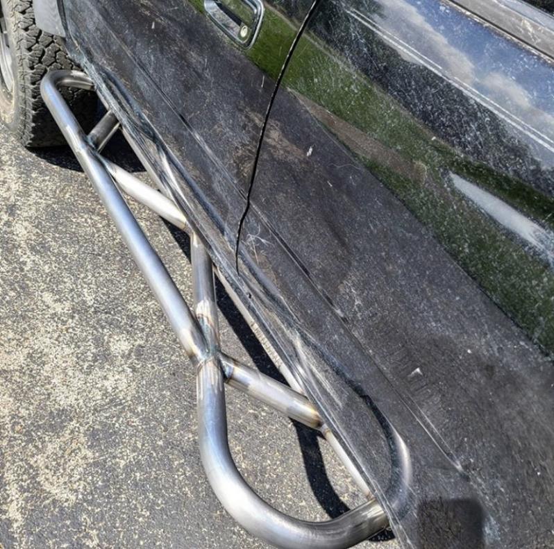

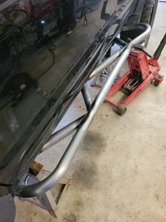

Adding sliders to the black pearl has been on the list of things to do for a while. Now that I’m not traveling as much and I’ve been spending a lot more time off road, I finally got around to pulling the trigger. I found a fabricator who had just started his own business after many years working for someone else. I was happy with the work I had seen from him from the other shop so we moved forward with the project. So far I’m super happy with the design and the quality of his workmanship! What’s your guys thoughts?

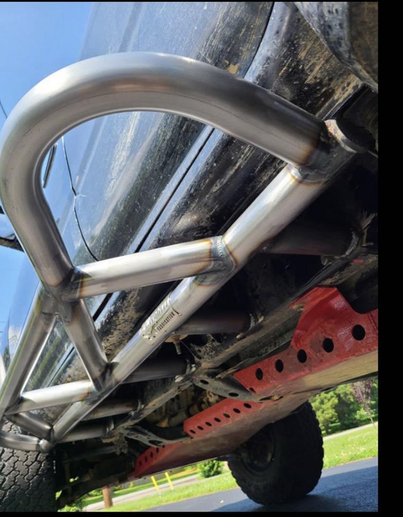

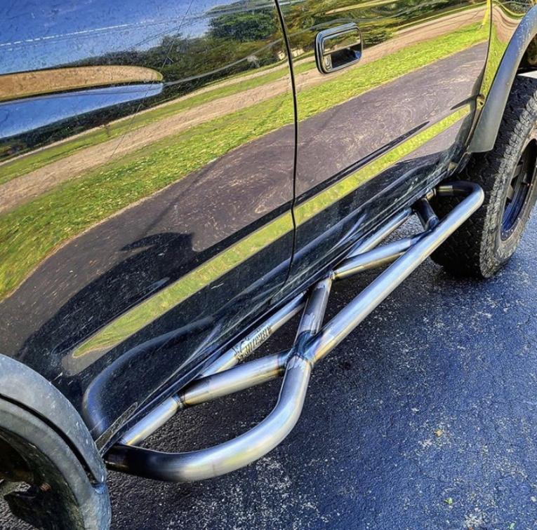

Some pics of the sliders finally on the truck! Super happy with how these came out.
2in .120 wall DOM
15 degree kickup
Tig welded
These things are a beast!
