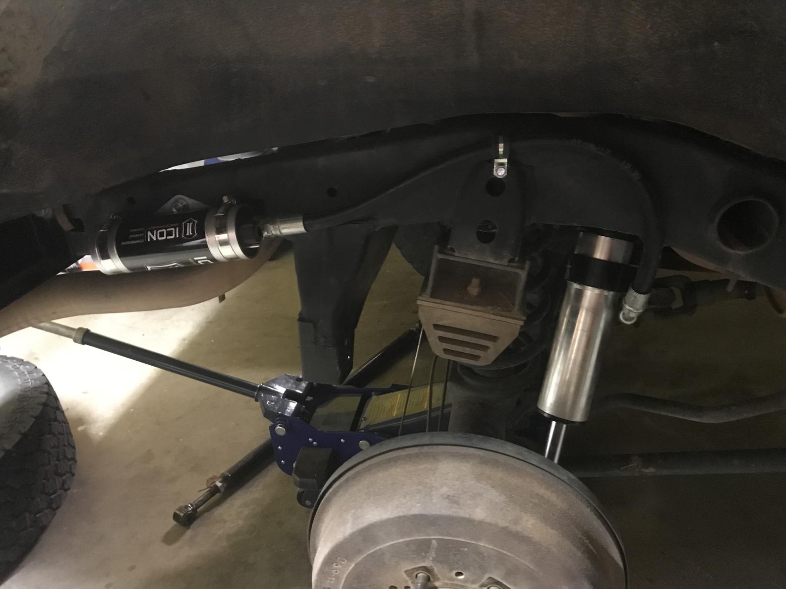

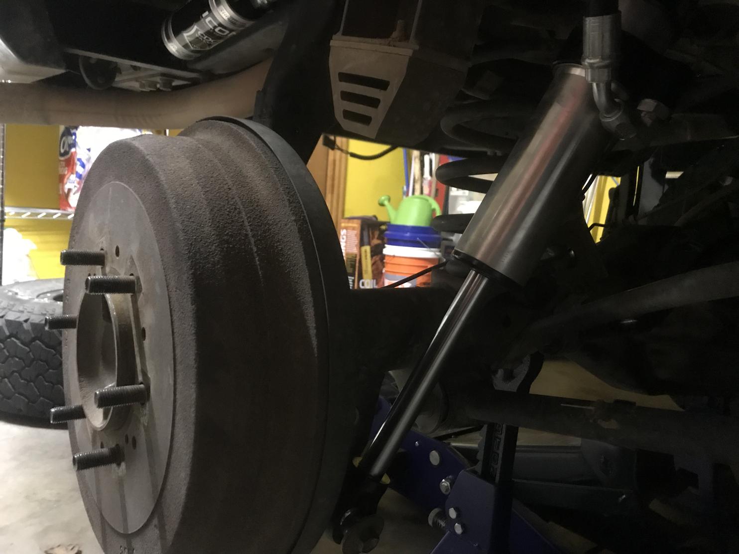

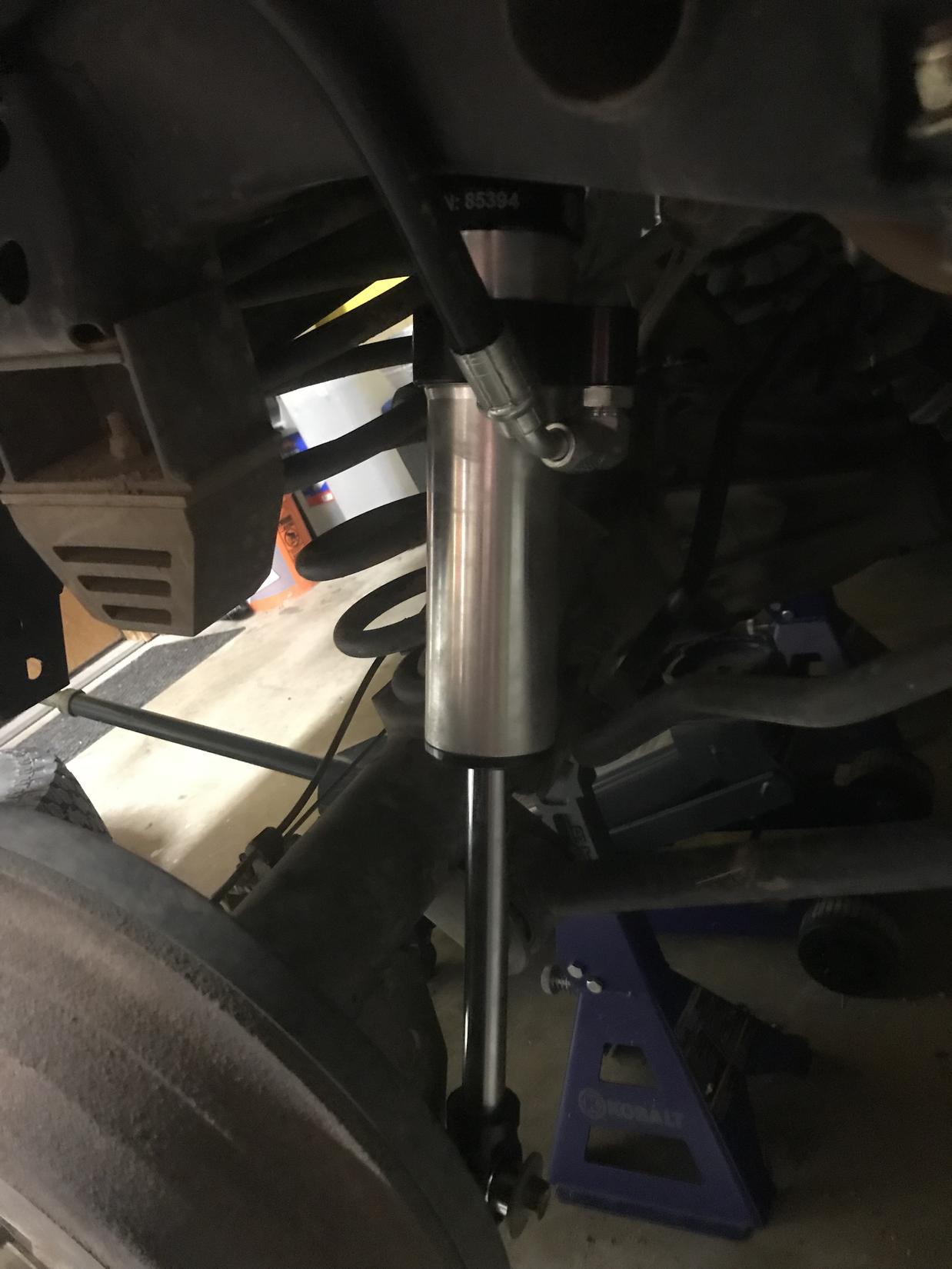

So I finally got the Icon rears installed(260,764) and got the panhard bar back under the truck. I have a stock one on the way....I am going to put the stock one in to tighten it up that much more. It feels pretty good to be back driving the 4Runner though. I am still playing with the stiffness of the rear shocks...trying to get it right for daily driving. They will need to settle though....so heres what I got.
