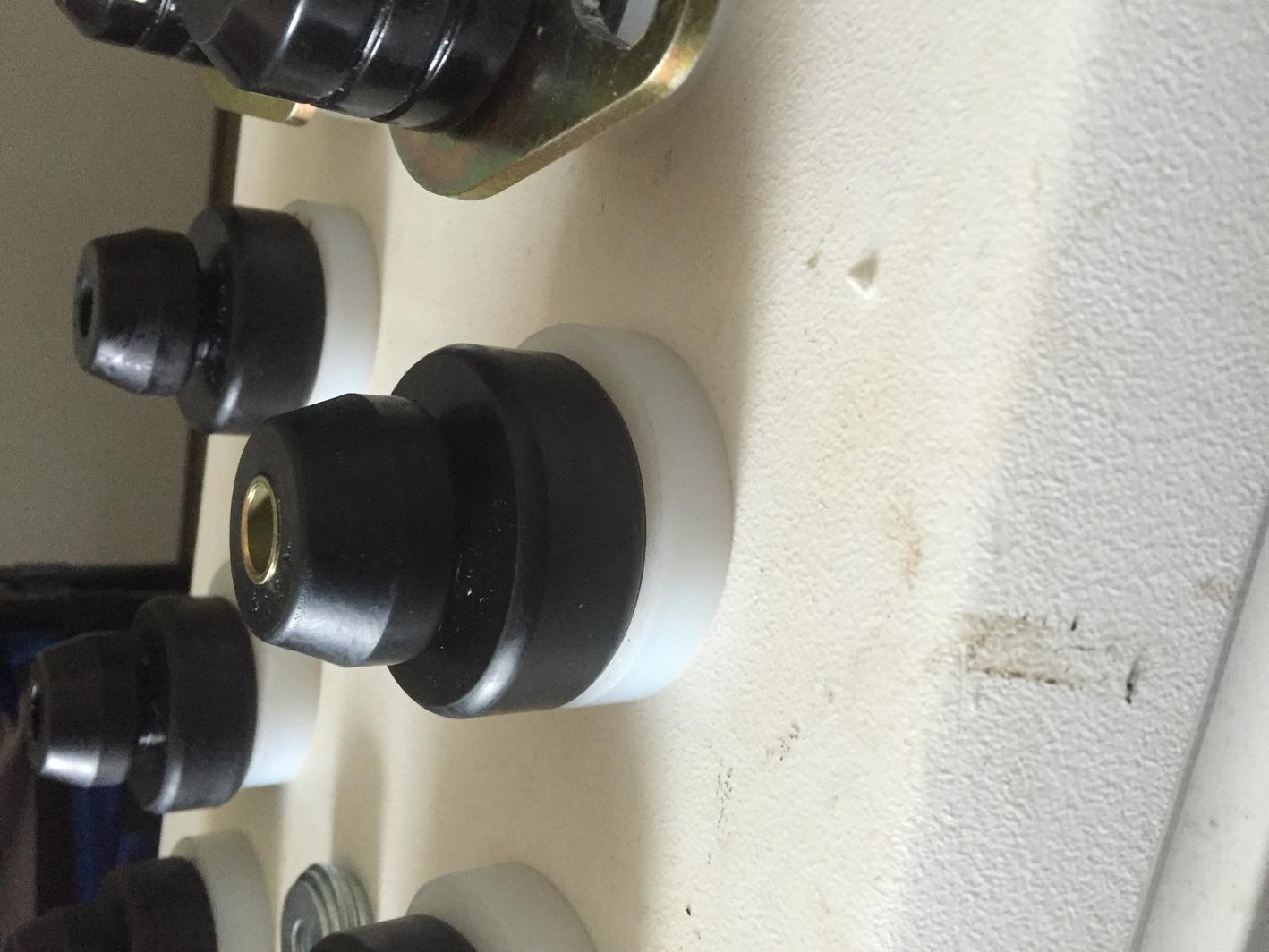

I have been sitting on this new bushing kit from 4Crawler for a couple weeks, as well as the 1.5" body lift kit from [MENTION=14772]shootmymime[/MENTION].
So I started the weekend undoing all the body bolts, and prepping to put the body lift on with the poly body bushings. Got the drivers side all apart, and the bushings put in the way I think they go. Ran into some issues, once I lowered the drivers side back down, the body wasn't even touching the bushing (bushings 3 and 4 from the front counting back).
I don't know if I am confused, or if I am just stupid. Was trying to get this thing together for this coming weekends trip. So if you guys have any suggestions, let me know please.
If there is anyone around me in Cameron, NC who knows whats up, I am open to help. Beer sounds like a fair trade no?
Oh and yes that .5" white block is part of the kit that 4Crawler sent me, not sure where it fits in to the body bushing kit exactly.

I ordered a 2" BL from 4crawler a long time ago, and I looked into the poly bushings. If i remember correctly they are considerably smaller than the factory rubber bushings. This leads 4crawler to send you a .5" Body lift when you order their bumper because they have to make up for that difference in height in the bushings with something other wise the tolerances would be to small around the tranny engine etc.
This however is not an issue when you order a body lift as well from them because they compensate for it when they cut it and send it to you without you having to think about it.
I'm not really sure what you can do in this situation but I figured I could pass on what I remembered.
