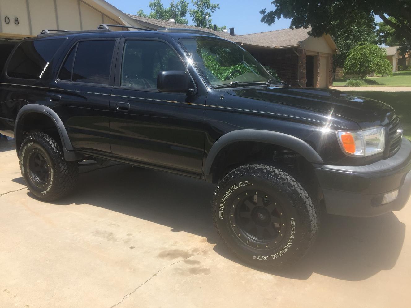

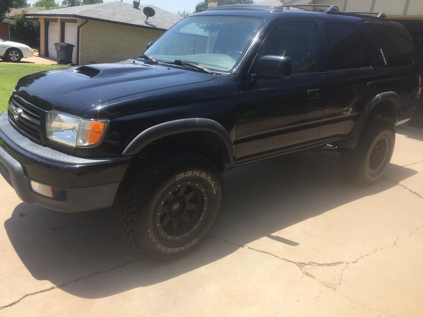

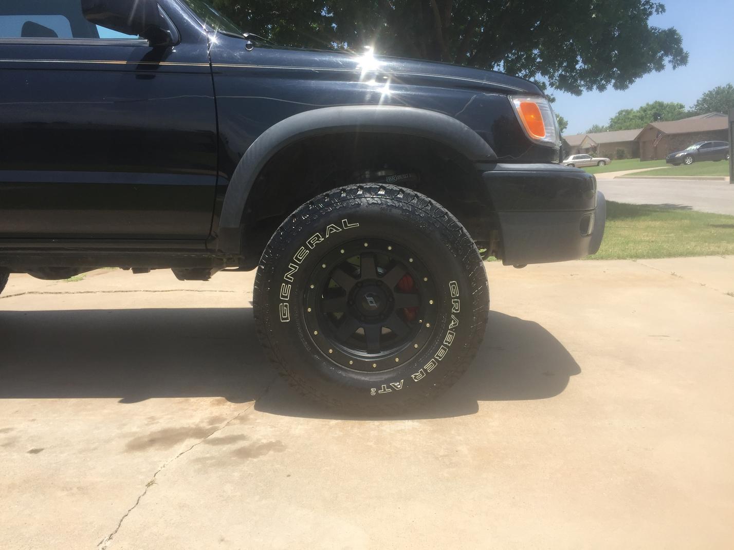

Well cleaned up...ish

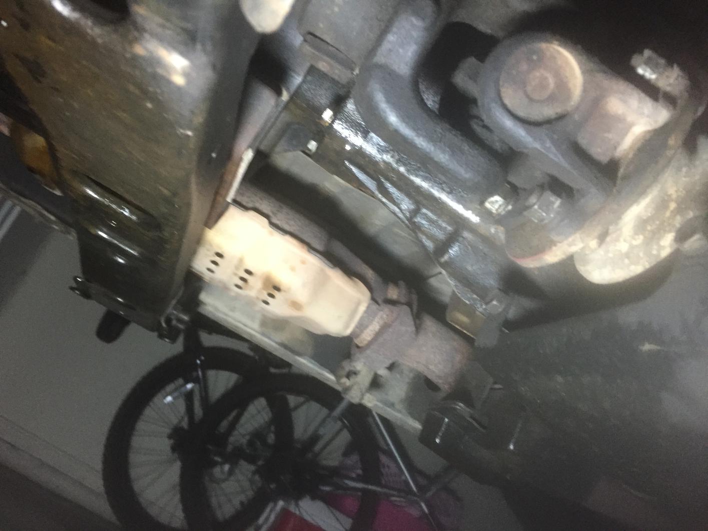

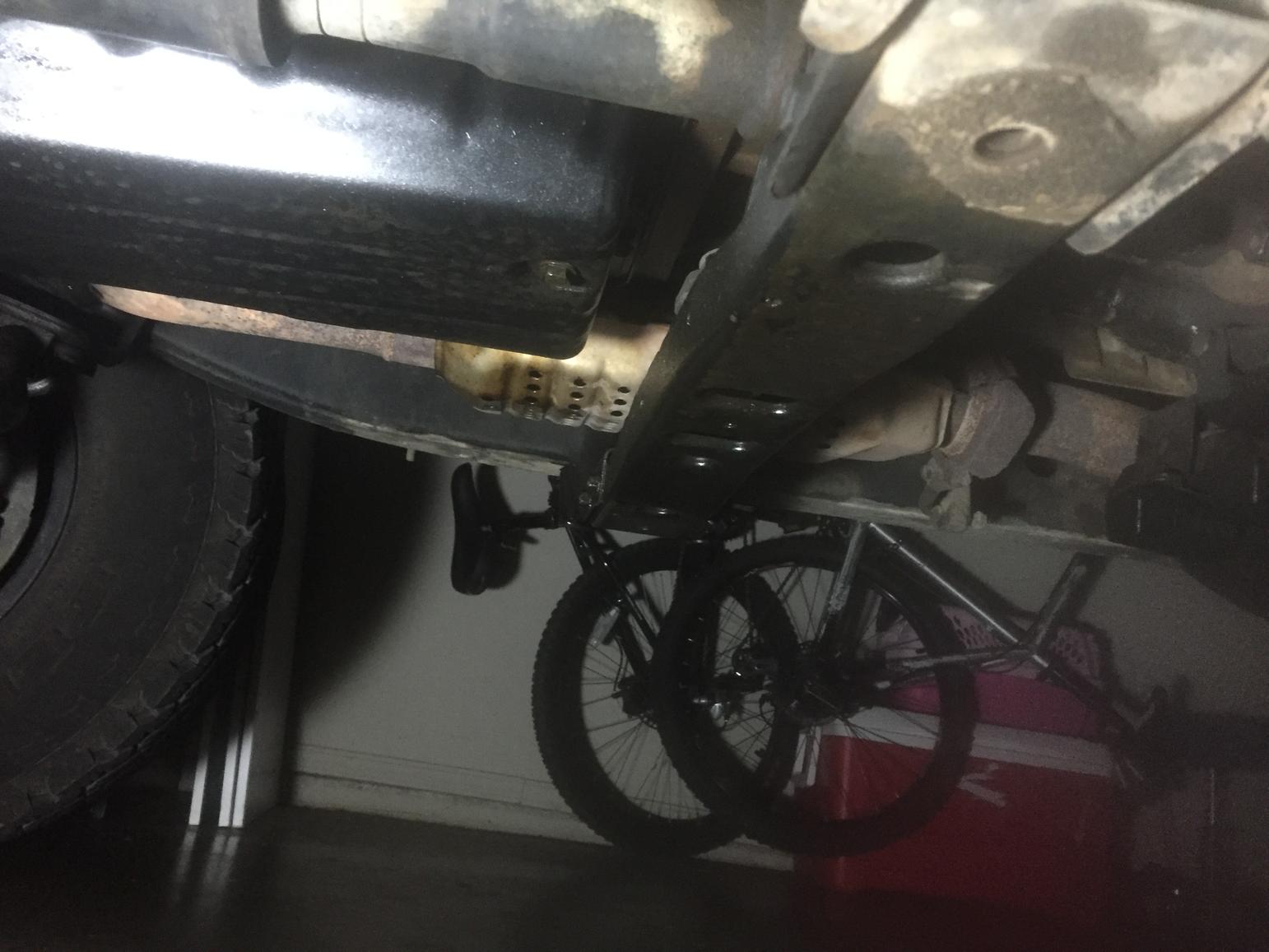

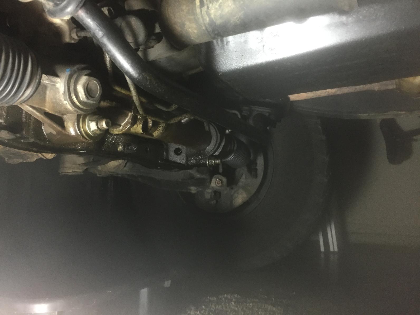

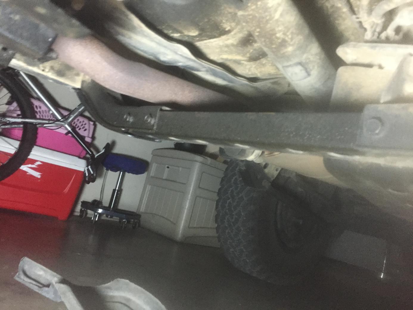

So I went to do my 245k oil change. I knew I had what had looked like the last time as a small oil leak from the rear main seal. Well now, its fairly wet from the steering rack, all the way back to the second of 3rd crossmember is wet from what looks and feels like oil, and is dark colored like oil. Could it be transmission fluid, it could, but if it was tranny fluid where would it be leaking from? I mean its even on the cat....
I am going to apologize for the bad cell pics in advance. Any input will help, what do you think [MENTION=92510]Ol'Blue[/MENTION], [MENTION=50342]JayRolla[/MENTION], [MENTION=65101]BrianSD_42[/MENTION], [MENTION=114863]4RunningDaily[/MENTION]? I know you guys have overcome some things with your builds...

Load the systems with the oil trace dye from O'R.
Drive it for a day aand get the black light out man. It will tell you asap what is leaking and pretty quick with no guess work. They sell the bottle of dye for 10 bucks and a black light kit with glasses for around 20 ish. Do that and you can pay me the rest of the dig cost for what ever a shop rate in your area is lol.
Try this first bud and see what you dind. You can put it in the Trans , engine oil, and ps pump. See what leaks and keep us posted.

Changed the oil, added the dye, and waiting for the it to cool. I am going to hit it with the black light here in a little bit. Brought it up to temp and ran it for a bit.
