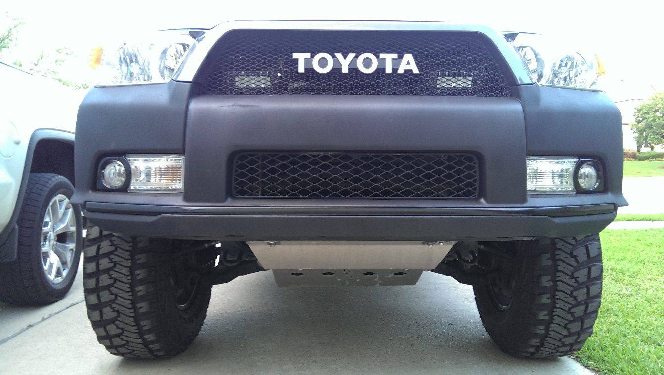

Bumper expriment

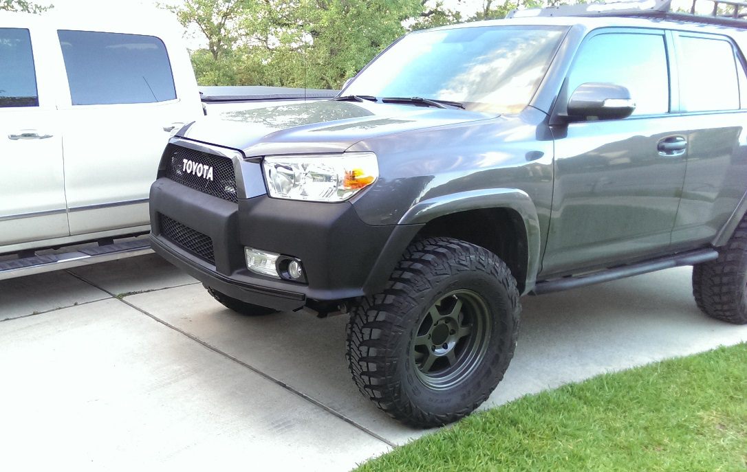

Nice mod. I have a spare 4th Gen front lower skin. I have to check it out on my 4th and see what I can do with it
Yes I too would like to see more pics and what was your method of cutting? Dremel? Did you mask off first or what?
I'll post/take some more pictures soon.
I used a jigsaw with a small 20TPI Bosch U101A0 blade.
http://www.amazon.com/Bosch-U101AO-4-Inch-Universal-Jigsaw/dp/B000R89YFC
Cuts it like butter. Taped off the lines and went slow and used a steady hand to create clean smooth lines. Used a sander to blend it a little on the edges...
I started out not really caring what it looked like, but now that it looks decent. I think I will go back and touch up the paint a bit and possibly clear coat it.
Cool thanks. Can't wait to see them. Yes I was thinking the same thing. If not just clear coat where you cut to keep from peeling or chipping away little by little. I've been looking for ideas on how this should be done with out dumping $1500+ in bumpers.
A few more pics from the other day.

I dig it. A bit too high on the sides for me. I'm ocd so everything had to be even. Well I started by removing that lower valance already and that seemed to help. I just need to a bit farther it seems. So you said a jig saw?
Yea, A little electric jigsaw that can use the blade I referenced.
I cut the sides higher, because I wanted maximum clearance. Many large obstacles get approached with an angle of attack to take advantage of that clearance.
Did you do the cut on or off the car? Also I noticed your sig. You run 4.56? Is your speedo off or is there scratchy correct it?
Cutting must be done off the car. Spedo has nothing to do with gearing, just tires on these trucks. So my spedo is off, but because of 34" tires. It was about right with 285/70/17 tires.

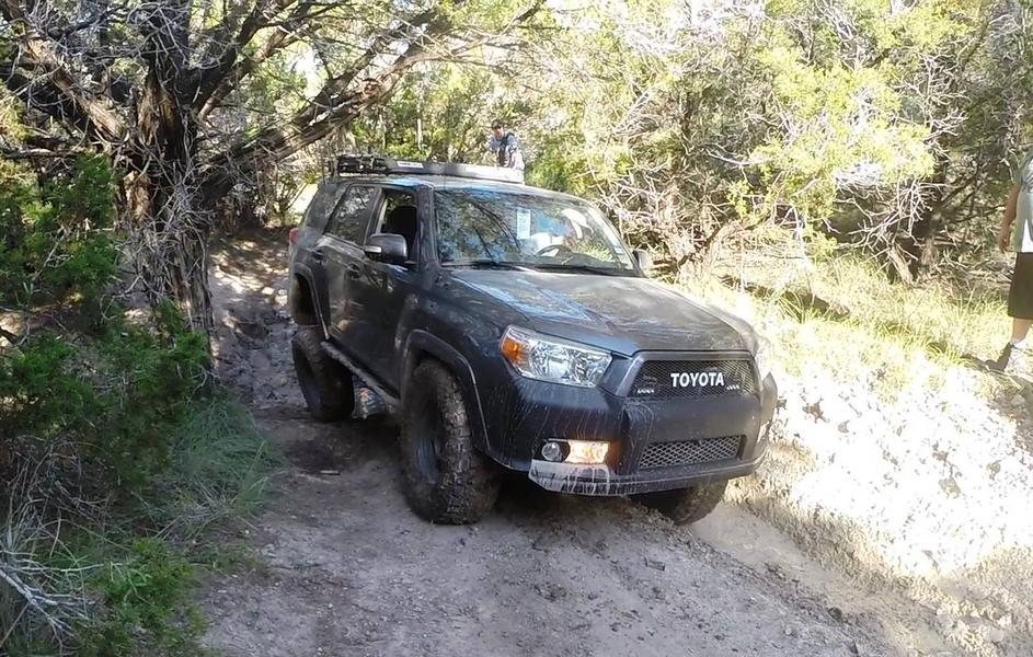

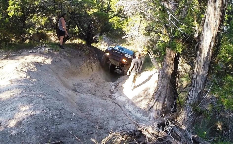

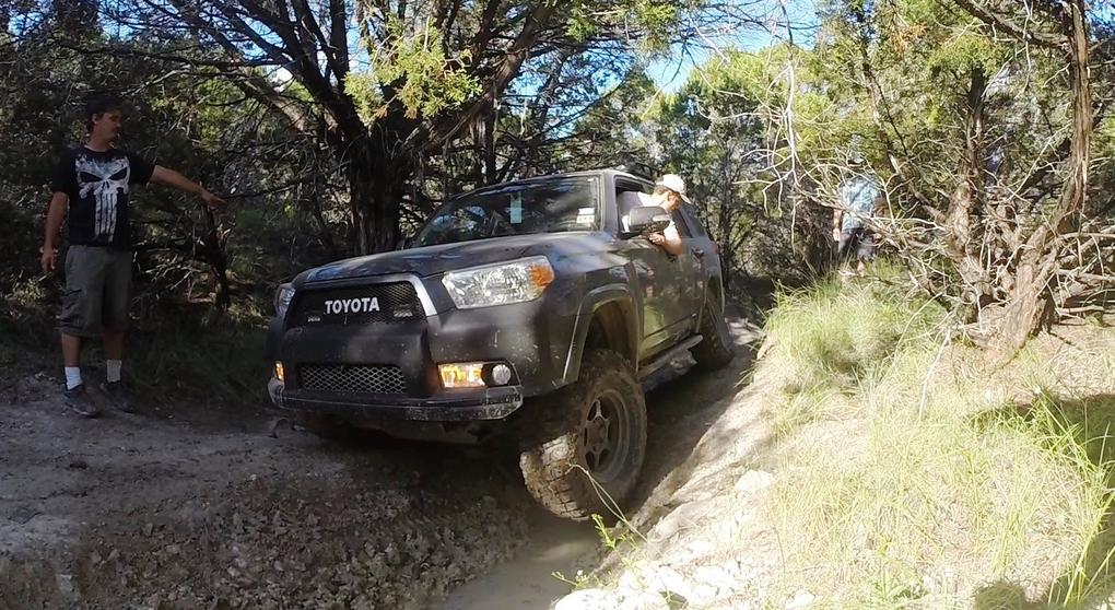

A few action shots. It worked extremely well. The truck is way more capable than me now. MTRs are just amazing.
What trail is that on? I did not see that one yesterday. That last part looks pretty tough. Oh, and I'll second your opinion on MTR's. Yesterday was my first run with mine, and they did great. I am especially impressed that I had no chunking even on that nasty, sharp, broken limestone. My BFG All Terrains chunked on the first trail they ever saw in Moab.
