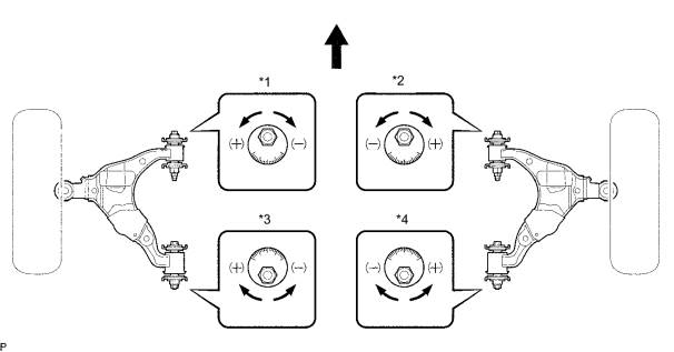

Like other stated. Doubt it is an issue with the UCA. All they do is position the ball further back than stock (yielding + 2 caster angle by default). The adjustments the tech can make is moving the lower ball around via the front and rear cams.

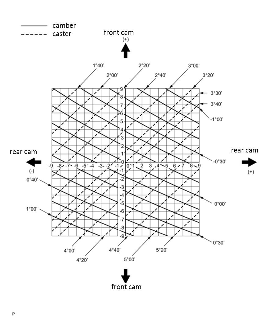

I've never had the opportunity to adjust one myself, but it seems to be a little tricky since you can't move it forward and aft in a straight line, so attempting to add caster also impacts camber. I pulled and modified the attached images from the repair manual to explain the settings. Maybe showing this to the tech would help hit your target. This is obviously not the exact numbers... but it should help determine where to go with each cam. The bottom right corner would be the place to start and then dial back until camber got acceptable.

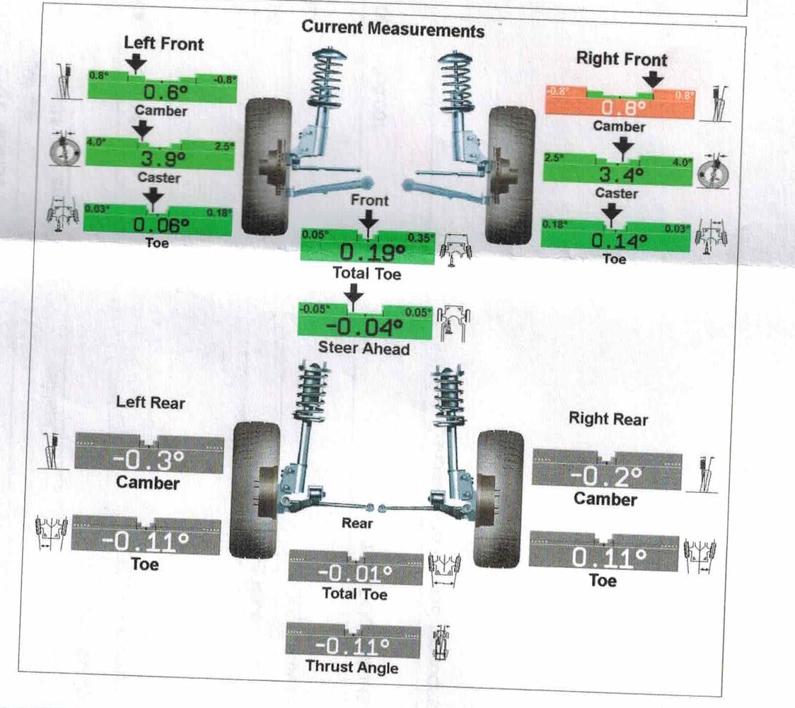

I had my GF take it to another Firestone since I got the lifetime deal. Here are the current specs, he said the caster and toe were set to counteract road crown, which Vegas does have a fair amount of on most streets. Do these look ok, or should I keep trying? I am still at work and have not had a chance to drive it yet.
Looks close enough. The camber on the right side is a tad high ( I would personally sacrifice some caster on both sides to get that down a bit), but not a huge deal.
There is no perfect answer.
If it drives fine, don't worry about it.
Don't over analyze it.. What matters is how it drives and tire wear. This should not be a big problem. I would keep an eye on the passenger outer tire edge for uneven wear. And yes, the ideal alignment does depend on the local road crown.
