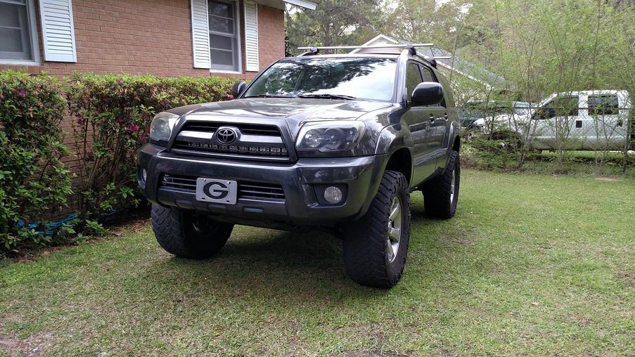

Great build! Love the new shoes looks awesome :thumb3: God you guys are killing me on here, I want 35's so bad but i keep telling myself i'm going to do the right thing and wait until my current tires wear down but you guys are making extremely difficult to do:decision:
Your rig looks great! I settled on 32's not too long ago because it was a little more practical than putting some more lift on it and doing some minor body work but you kinda make me wish I had gone 35's! lol

Lift wise is hard to say because I got tired of the harsh ride of the FJ/Bilstein @ max combo, I tore out the FJ's and put my stocks back in but couldn't stand the loss in lift and still crap ride. Approx #'s = stock coil/Bilstein max 36 1/2 to 36 3/4, FJ/Bilstein max 37 1/2ish, FJ/Bilstien 0 w/ spindles 38 1/4 to 38 1/2, I am running 32" tires. Besides ride quality which is huge, you gain ground clearance because the hubs mount lower it pushes everything up.

Thanks, that's some good info. I just measured mine out at 40 1/4. That's on FJs with what I believe to be a 2" spacer (maybe 1.5") and 1" BL on 35s.

You will probably be pushing close to 42 1/2 to 43 with spindles and no spacer, you have 1 1/2 more clearance on your 3" bigger tires and you have 1" over me in body lift.

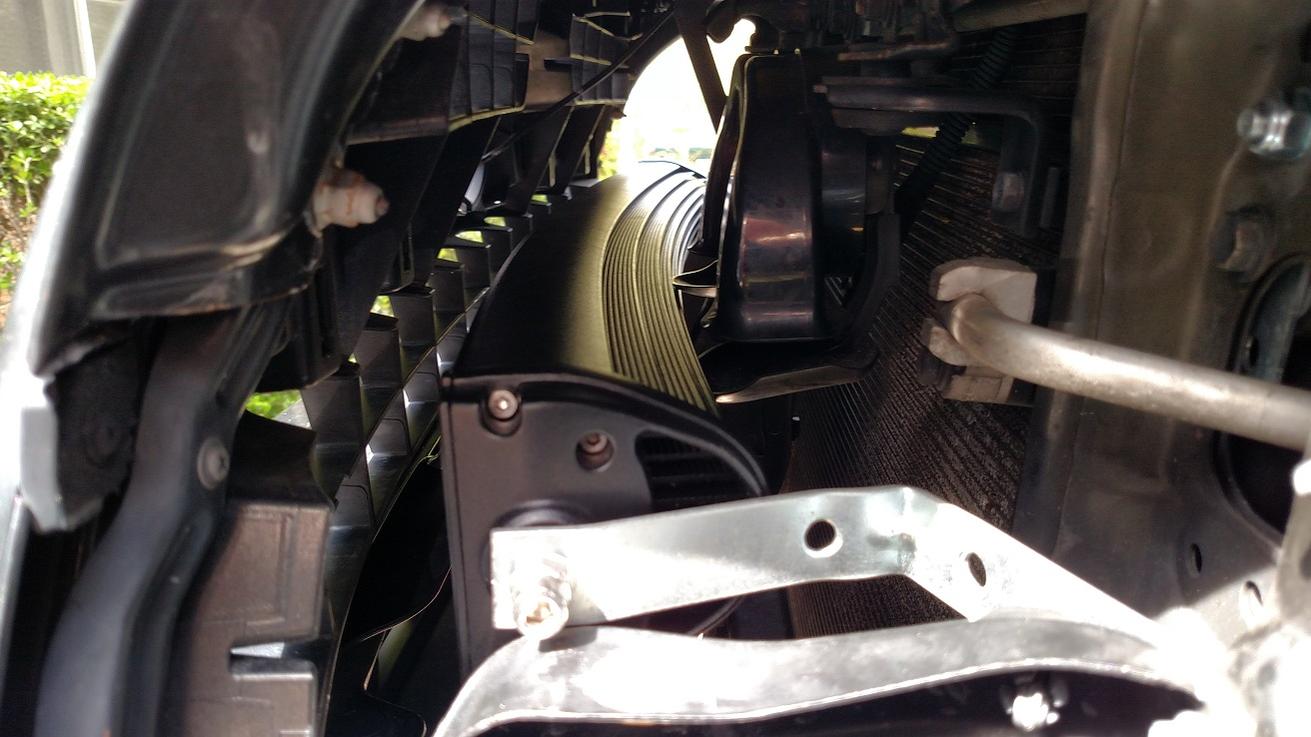

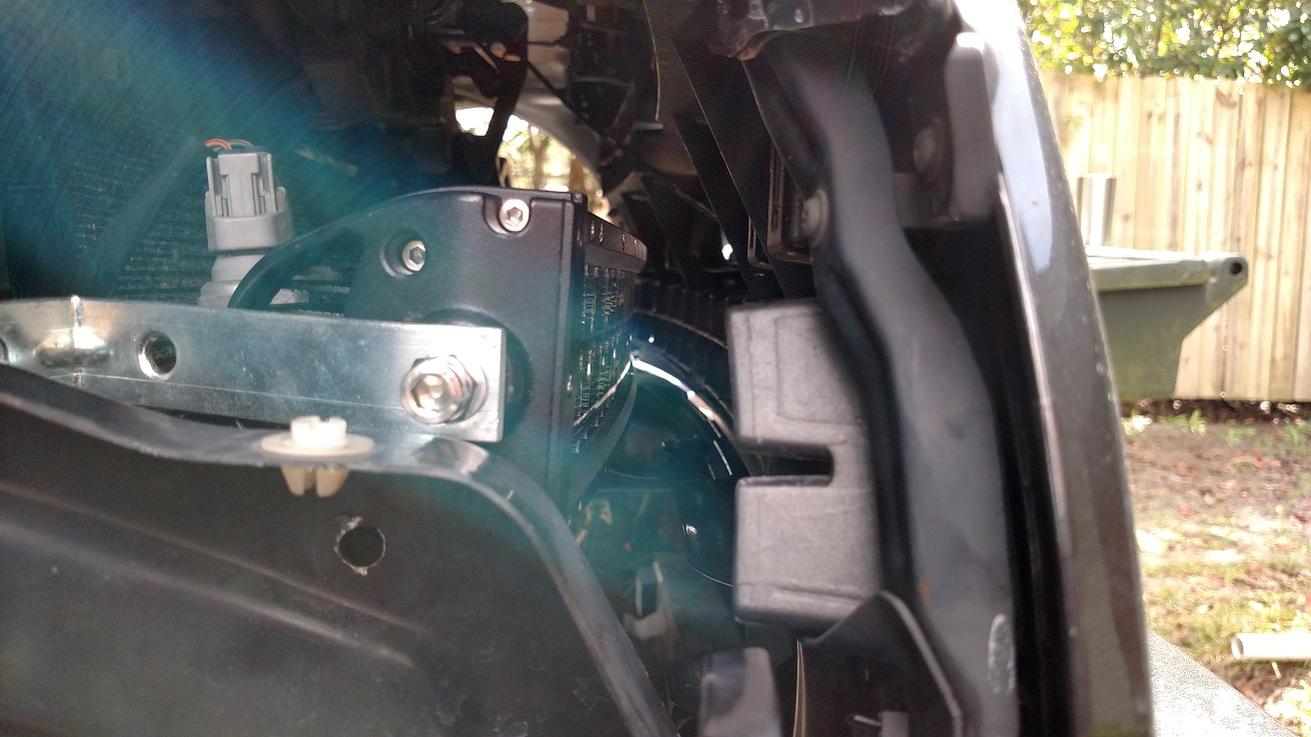

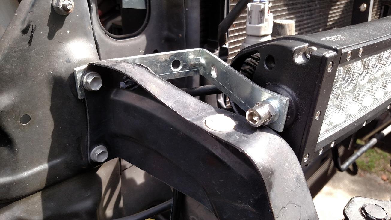

Cheapskate upper grill light bar mount

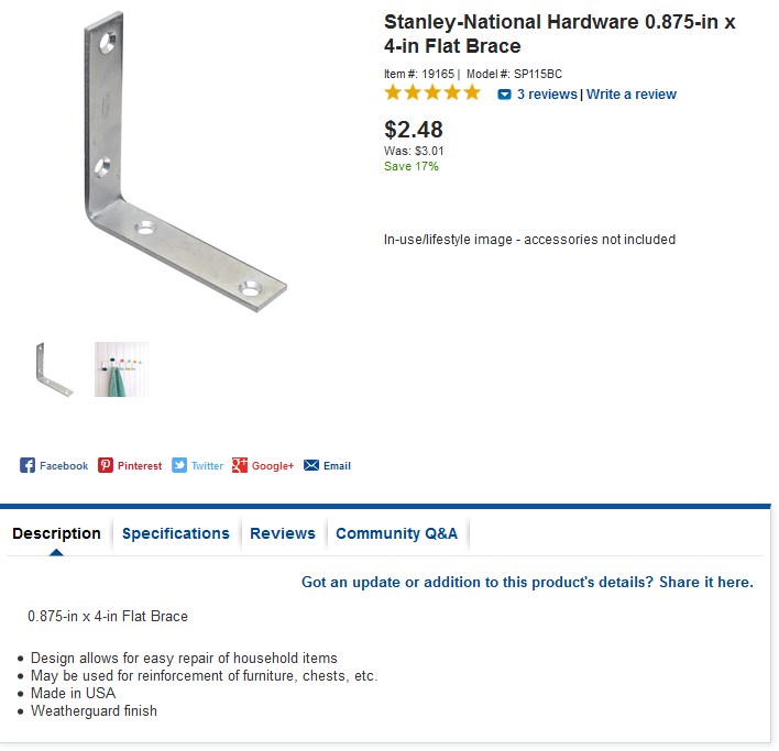

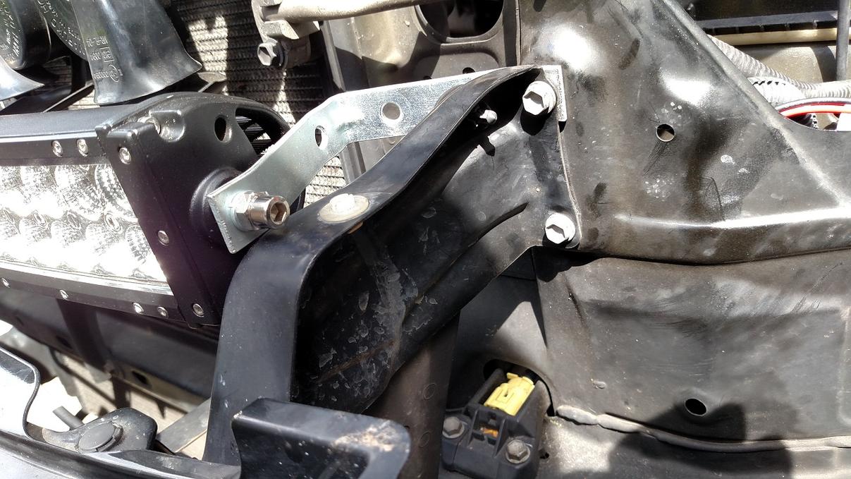

I've only seen one other person do this on a 4th Gen and he had a Satoshi grill. I like to do things a little different if I can, and I'm cheap/broke, so this is what I came up with. You'll need two L-brackets from Lowe's or HD. Total cost of mount: ~$5
If you have a bench vise, this will take a little trial and error. If you don't, it may take a little more. The first bracket took about 20 minutes to get right, the second took about one minute.
You will use two bolts on the bumper reinforcement and the two bolts that came with your light bar (if you got the type with the end mounts).
My light bar was listed as being 35", but without the supplied side mounts, it's around 32".

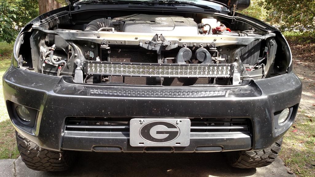

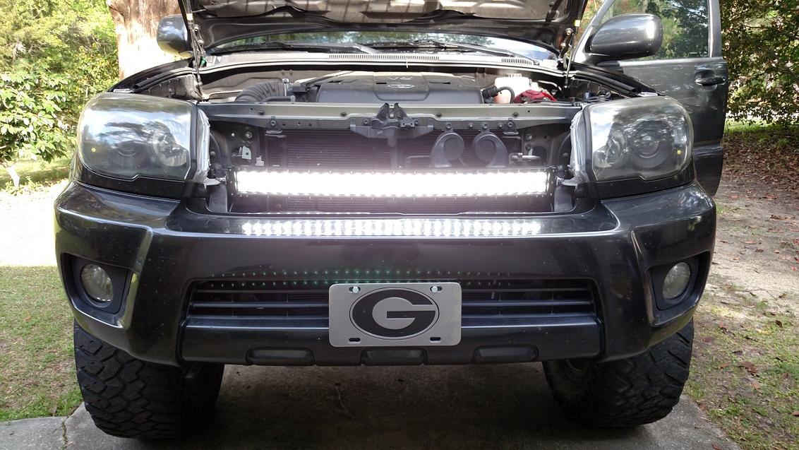

With the headlights out and the hood shut and latched.

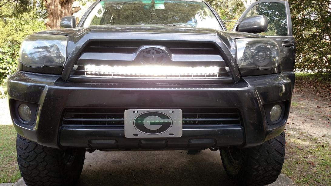

Mounted up

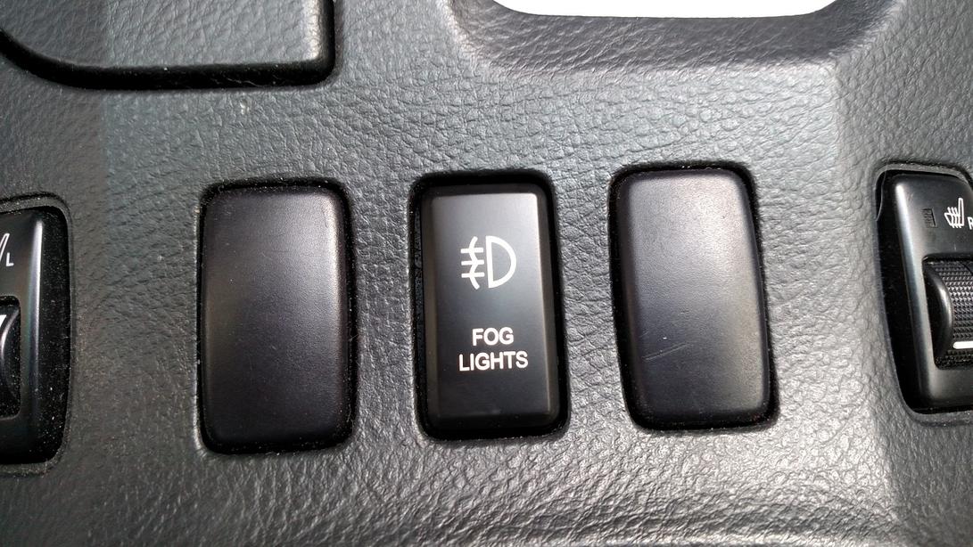

Slick low profile switch so that your idiot friends (we all have them) don't immediately know how to turn it on. "Stealth" all the way around.

Oh yeah, you will have to re-engineer the hood latch pull handle. I'm still working on that. For now, I just have it poking through the Toyota hole. I've got some ideas so stay tuned.
