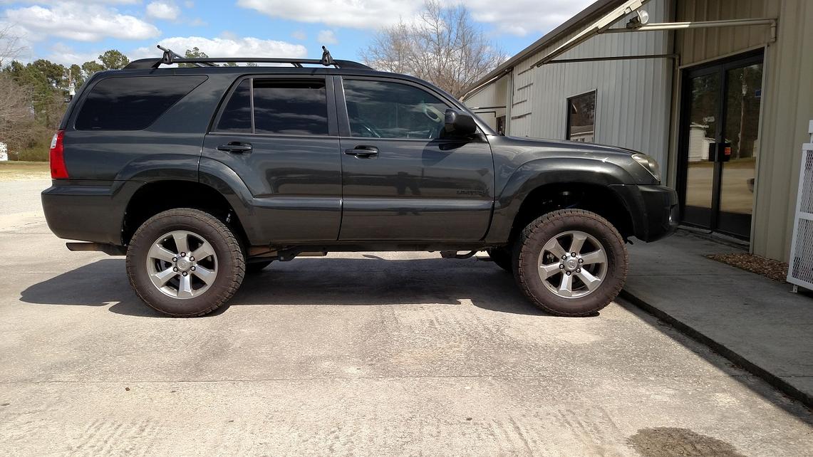

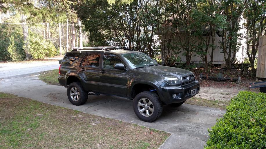

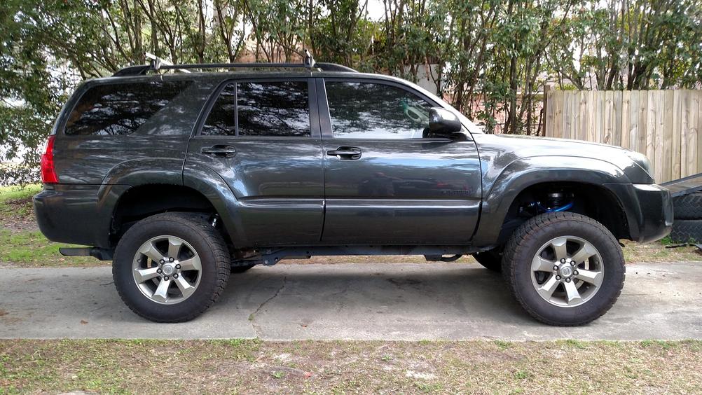

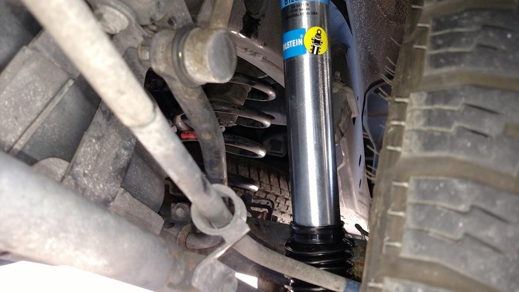

Recently got the rear spacers back in and replaced the rear shocks with 5100s. The stance has leveled out almost perfectly. Hoping the rain will hold off tomorrow so that I can get the BL on and get some bigger shoes put on Monday.

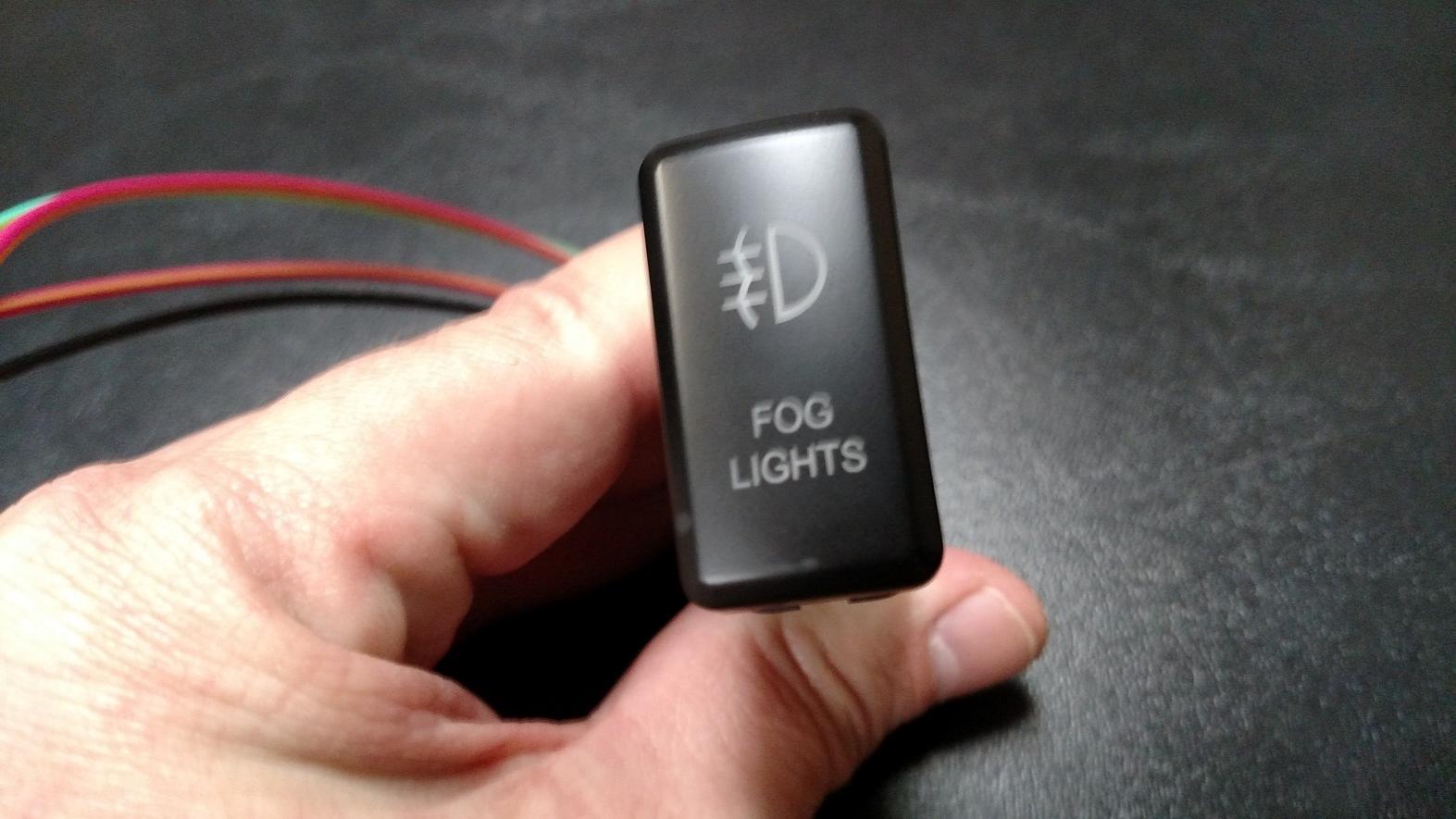

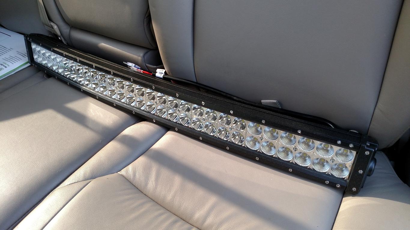

Also picked up this guy. Hoping to figure out a somewhat "stealth" location to go along with the subtle control switch. :spy:

With that Toytec spacer lift, Do there instructions state to leave the Isolator piece between the spacer and coils.
I know when I did a Revtek spacer lift, it stated to remove the isolator!
You might want to research that.
I didn't even think about it. The spacers I'm using were already on the FJ coils I bought used. I thought that the Toytecs were the ones that go on top, so I was going to use both. But the Toytecs were the same as the ones already on the coils. I just looked at the paperwork that came with them and there are no instructions, just warranty info. I'll have to look up the instructions online I suppose. Thanks for the heads up! :yo:
No problem there Sir. When you have the spacer that goes on top are top hat spacers, they will usually give you double the lift of the thickness of the spacer. Ones that you are using above the springs are preload spacers, not so much of a drastic lift increase for there size.
Just check out what you have and what's supposed to come with it for amount of lift also.
Revtek came with a preload and 3/8" top hat spacers for a full 3" lift.

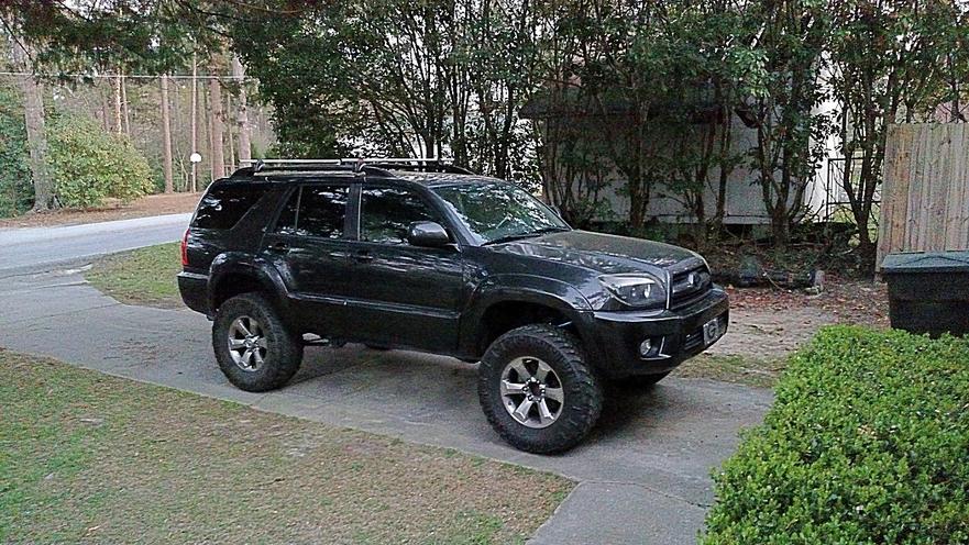

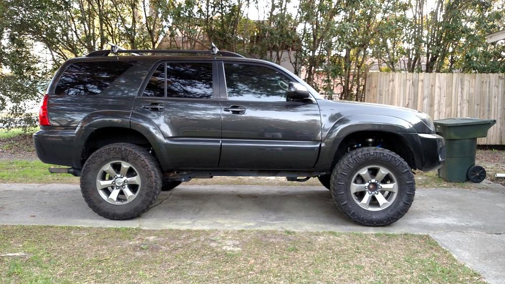

Finished up the body lift yesterday. Not much change, but hopefully enough room for some bigger shoes.....
Please try to excuse Mother Nature's yellow paint job. The pollen count is through the roof around here right now! :painkiller:

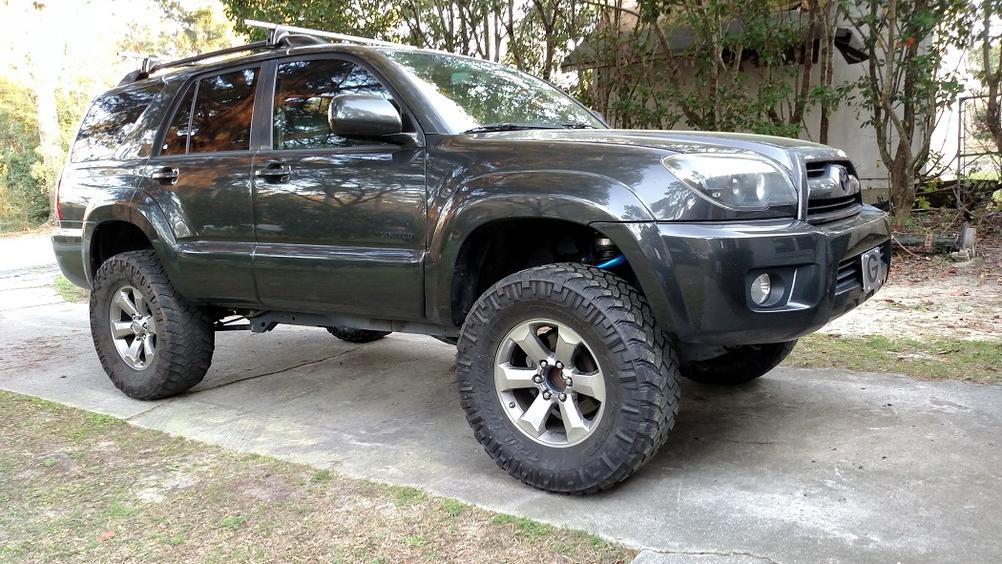

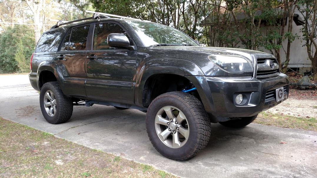

35x12.50R18 Nitto Terra Grappler MTs
So the guys at the shop "dropped" one of my center caps and it busted. They've ordered me another one, so I can't really complain. Anyway, here they are, almost as dirty as my truck. I still have some fender work to do, but they aren't scrubbing pulling out of the driveway :wow2: I don't really do any off roading to speak of. Mostly a DD with trips to the coast/beach thrown in here and there. I paid $150 for all four tires, so I couldn't pass them up.
