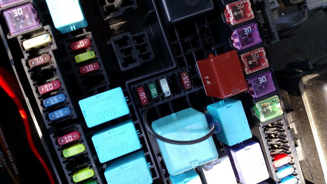

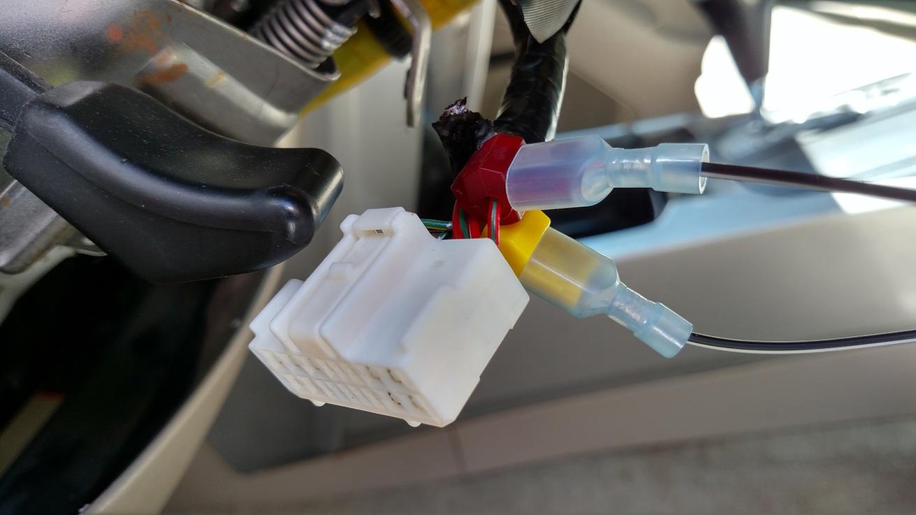

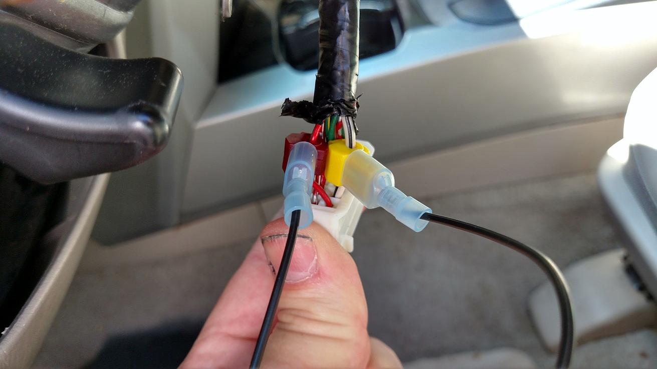

I just cut this switch off and used the other one. The only wire that needs to come through the firewall is the white one. You can tap into the fuse panel for switch power in the cab. I got switch ground off the cigarette lighter and illumination off the seat heater plug. I think it was one of the end wires on the harness.
The relay is prewired so you just need power and ground in the engine bay.

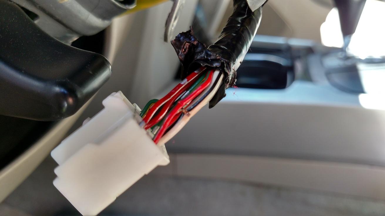

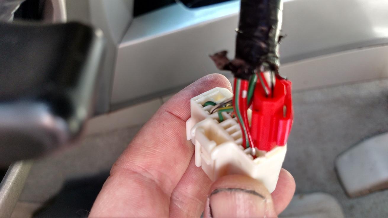

Fog light mod
Stage 1 & stage 2.
As you can see in pic #2 & #3, I don't recommend using this type of connection. The first wire is much larger than the second so it's difficult to get a good bite on both wires.

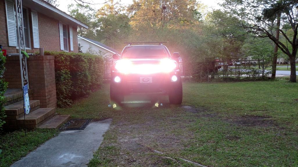

Not much to see during the day, but when the sun starts to drop.....

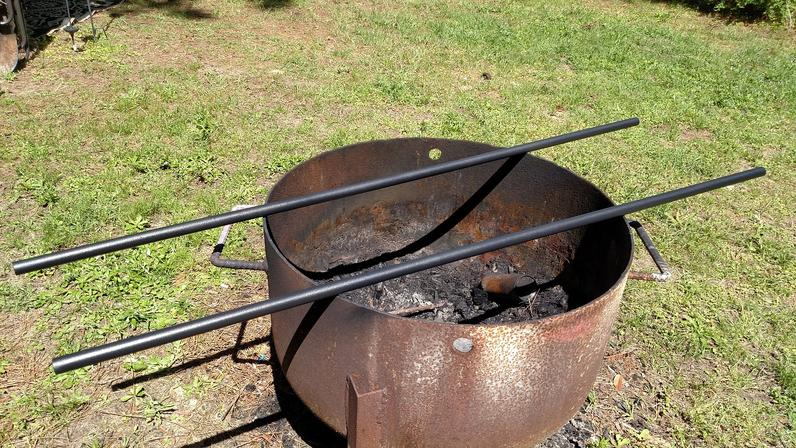

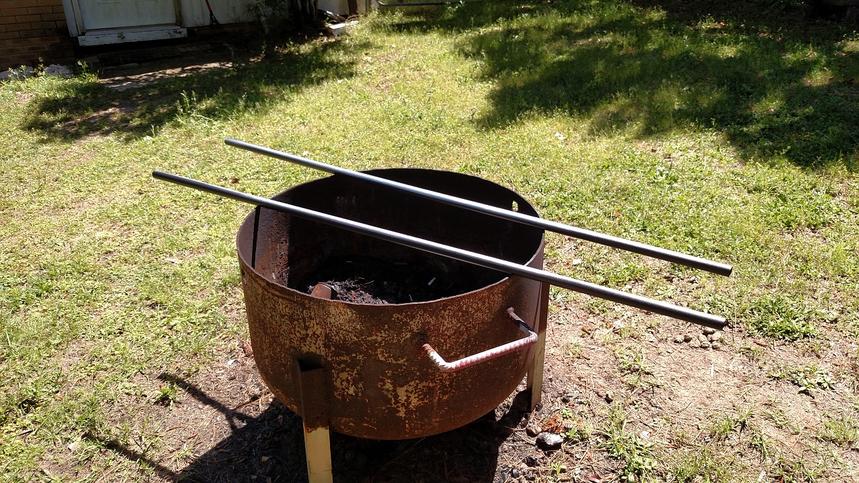

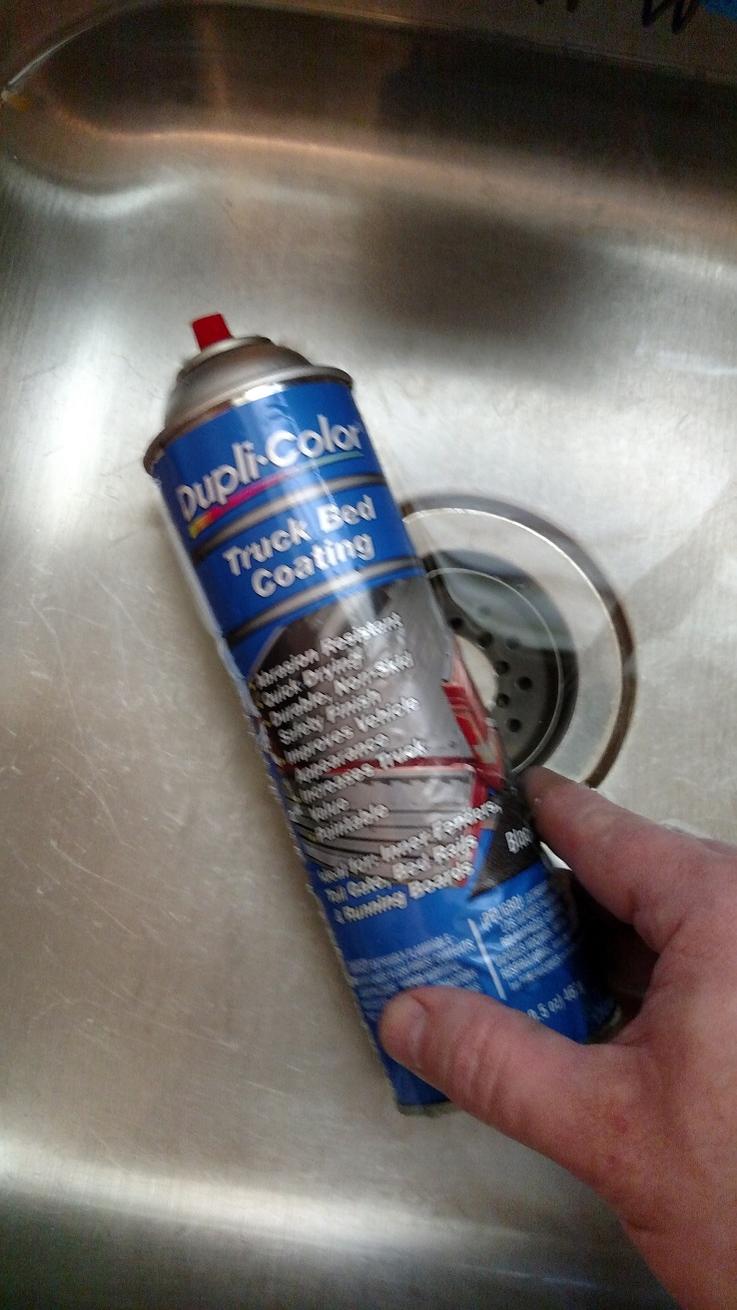

Bed liner on my conduit crossbars
This stuff is not impressive.

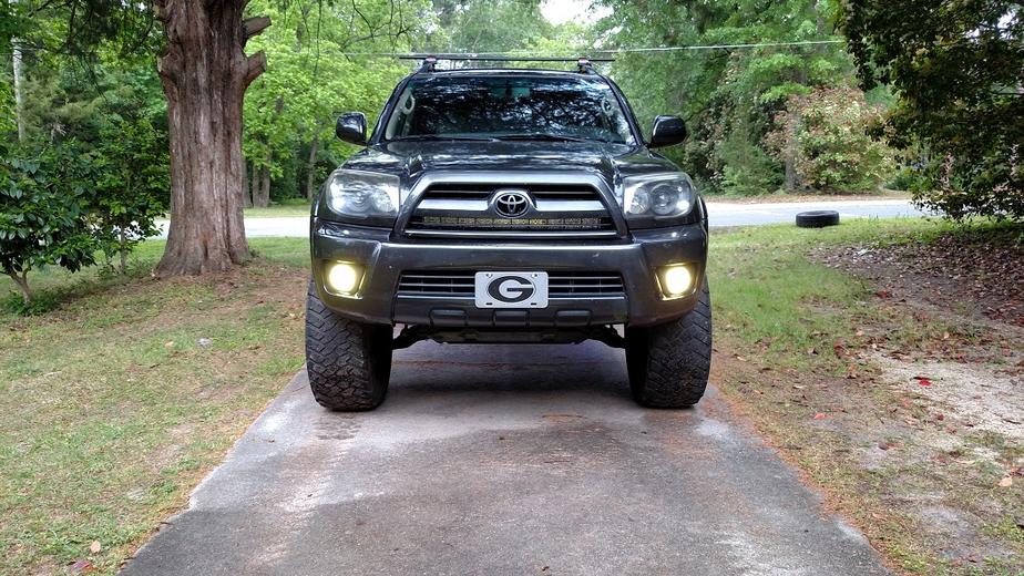

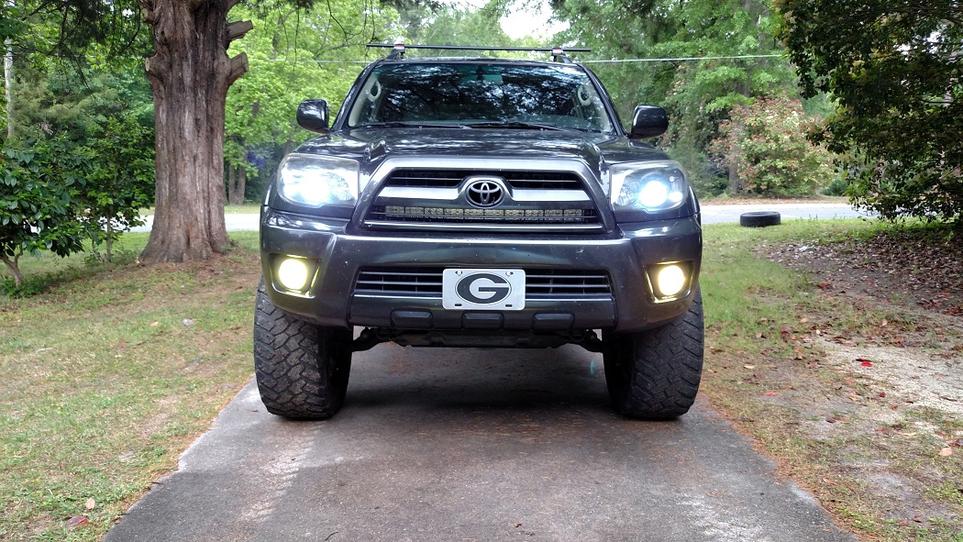

Six day work weeks haven't been kind to the Runner. Did manage to swap out the fogs from 6000k to 3000k. They don't really look all that yellow from the front, but the output is very noticeably yellow. Although, it's hard to get good pics in the dark.... :photo:
