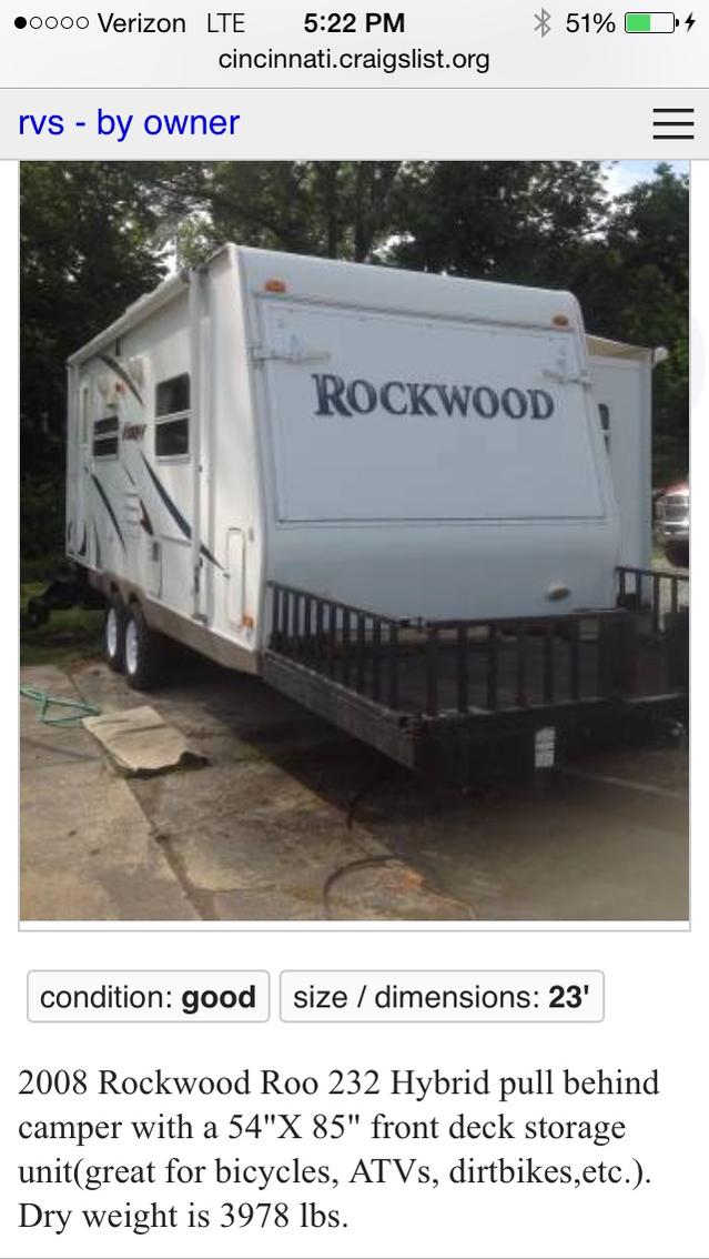

Hi guys. Just looking for your opinions on towing a 2008 Rockwood roo 232 camper with my 2010 trail. It's for sale locally and in my price range. Plus it has taller ceilings which is good because I'm 6'6".
The seller says dry weight is 3978 lbs. sounds like it might be pushing the limits but I've never owned a camper. Obviously I would have to be very mindful of loading it, etc. but do you think it's too heavy?
Most trips would be within an hour or so of southwest ohio.

I'm part owner of a very similar 2011 Roo and just went through the same deliberation, but after some number crunching it became apparent that the GVW is a bit much for the 4Runner to tow safely.

3900lbs dry, easily add 800lbs of water and gear, then add a bunch more weight in that excessively large storage area right on the tongue and you have a recipe to be way over 500lb tongue weight and 5000lb overall weight.

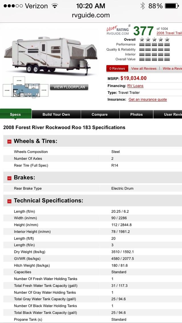

The 2008 roo 183 also for sale locally looks like it's about 500lbs lighter dry. Rv guide has it listed at 3510. Also doesn't have the front storage deck. Think that is enough of a cushion?
I personally think that you could pull that fine if you keep weight in mind and add a few of the accessories listed above. My brother-in-law pulls this with his FJ and he has no problems:

The 232...no way! It would be too tempting to throw something on that front deck.
The small one would be perfect weight-wise.
