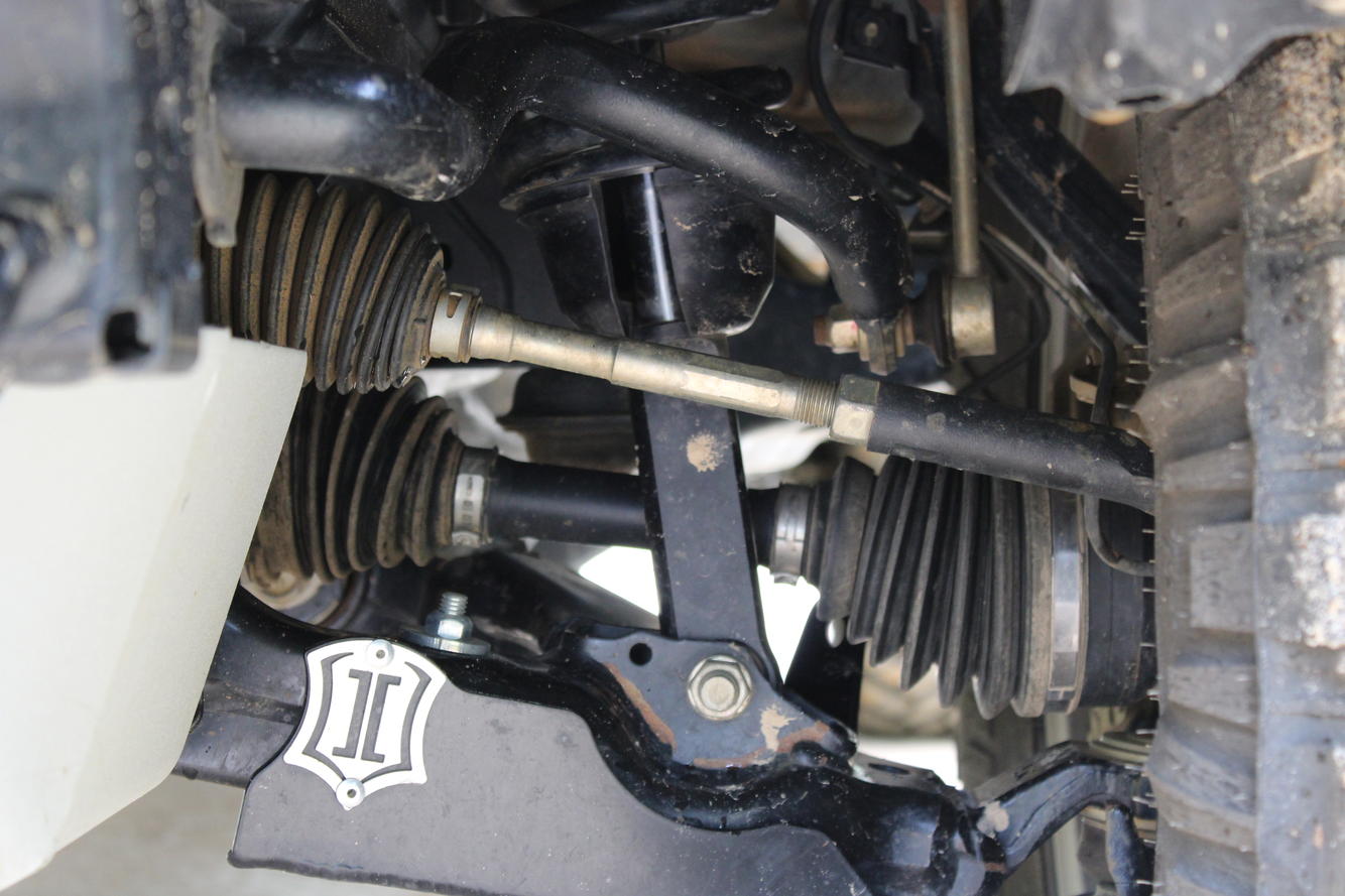

I'll show you mine if you show me yours! Also, post up some hub-to-fender measurements if you don't mind.

heres mine. you can stand to crank them up another 1/2 inch it looks like

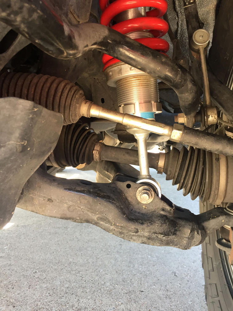

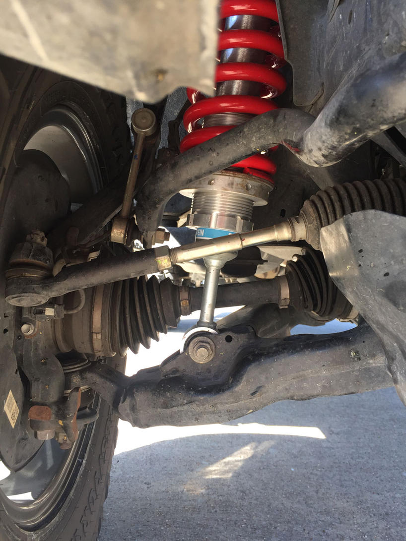

First timer here and not to resurrect and old thread, but I'm a little concerned with my CV angles as well. I just installed a Toytect Ultimate 3" with LR UCA's. I performed pre and post lift measurements for reference.
These measurements are from the middle of the hub to the bottom of the outer plastic fender well trim.
Front: before/after
Driver: 20.5"/23.25"
Passenger: 20.5"/23.125"
Rear: before/after
Driver: 22"/24"
Passenger: 22"/24"
I will try to post pics of my CV angles as well.
What do you guys think about my lift measurements and the angles it caused. Also, is it common to have the two coilovers look so different in regards to how much each one is adjusted?
Thanks

You are fine. The coils are often adjusted differently to level it out side to side....
What this man said. My passenger side coilover is about 1/3rd an inch of pre-load, and my driver side is like 1.5" because of the lean.

Myself I wouldn't be comfortable with those CV angles. Your measurements seem reasonable, but I had 2.5" lift on the '07 with the Boss kit and the CV angles were not near that bad. I dropped it down to 2" because I kept the stock UCA's and while the alignment was in specs it was too floaty.

If [MENTION=106176]wfo9[/MENTION] & [MENTION=124732]LawnDart[/MENTION] said you are fine, I wouldn't worry about it. I am at about the same heighth as you, and it looks good, and rides good. Many have thousands of miles with CV angles like yours or worse...
