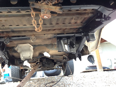

This weekend I got the frame painted up to the front cross-member. It doesn't look amazing but it's good enough for now. I mostly did it to by me some time from the rust until I can take the frame in to be sandblasted and powder-coated.

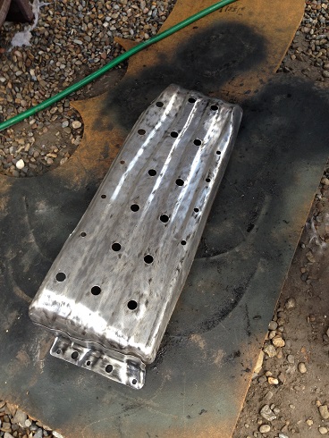

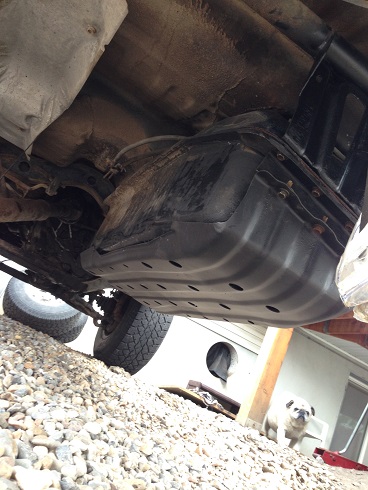

I cleaned the tank as best as I could and undercoated the tank cover. I got it back in place today.

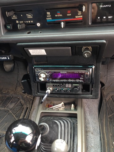

My Uniden 520xl finally got here so I installed that as well as wired the coax cable to the rear passenger side. When I get my bumper done I'll have the antenna mounted to it. I was originally planning on mounting the CB in place of the ashtray, but I decided I use the ashtray and I don't use the pocket under the deck at all so I went with that.

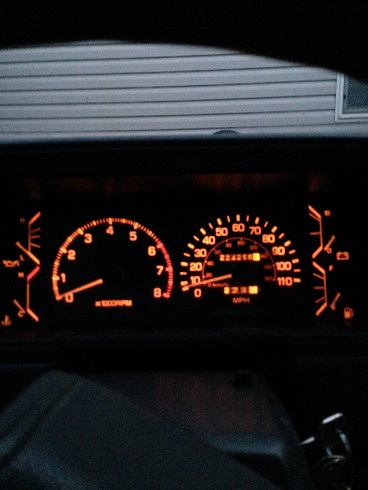

While I had the dash out I put some amber bulbs in gauge cluster. I think I like the look so I'll need to get some for the climate control and clinometer.

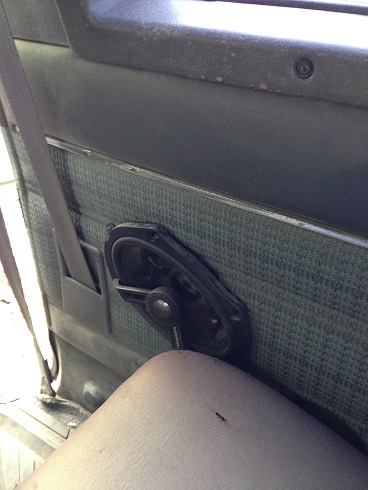

Also I finally got a picture of my rear speaker placement.

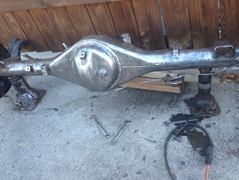

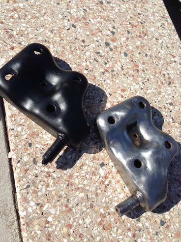

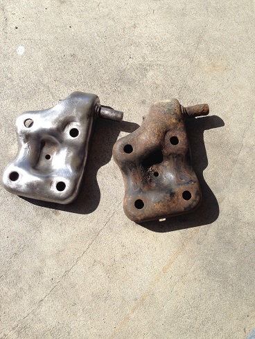

I don't have much to do because I'm waiting on shocks and springs this November, but today I wire wheeled my shock/U-bolt mounts and undercoated them. The look brand new!

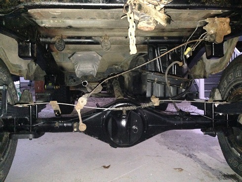

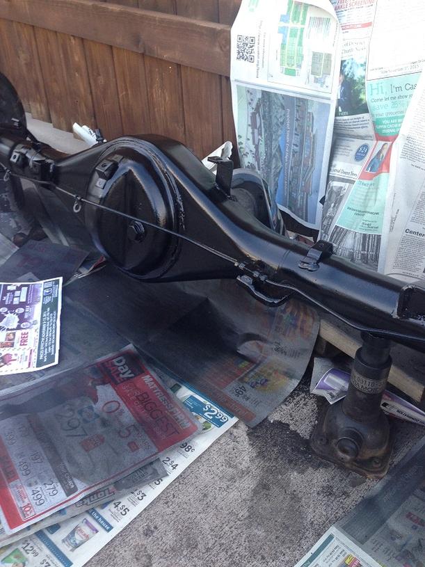

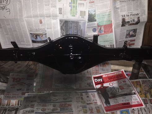

I painted my axle this past weekend. It was pretty dark by the time I threw on the last coat so I'll have to get a better picture later.

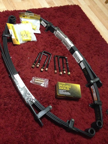

Goodies came in the mail today :)

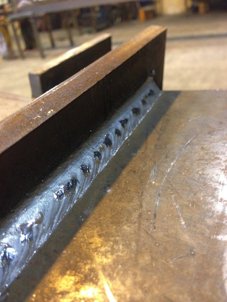

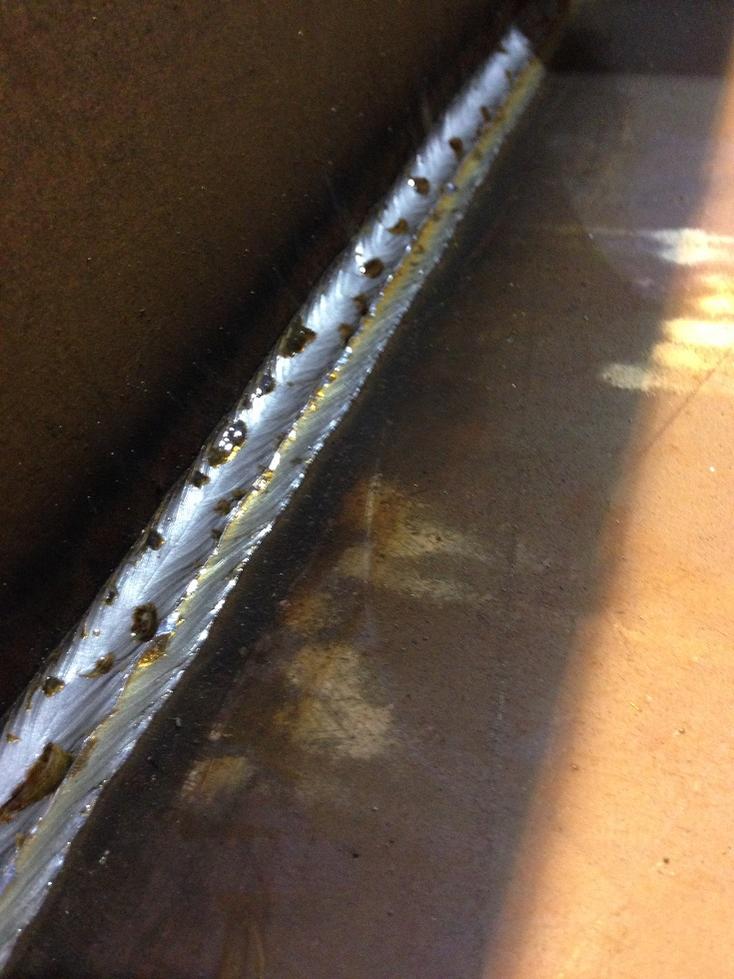

Getting some nice beads down at work. Practice makes perfect. First is 5/16 other is 3/8

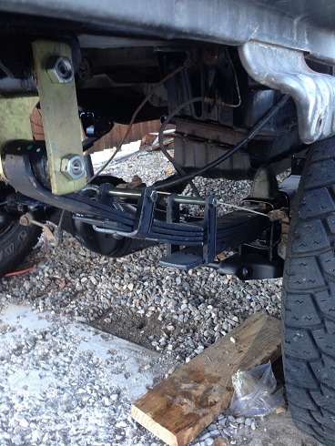

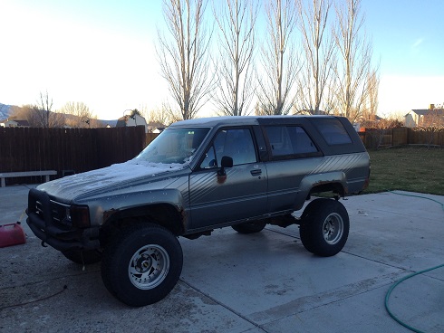

Look at what I did last weekend! A bit more lift than I was expecting.. Hopefully it settles
