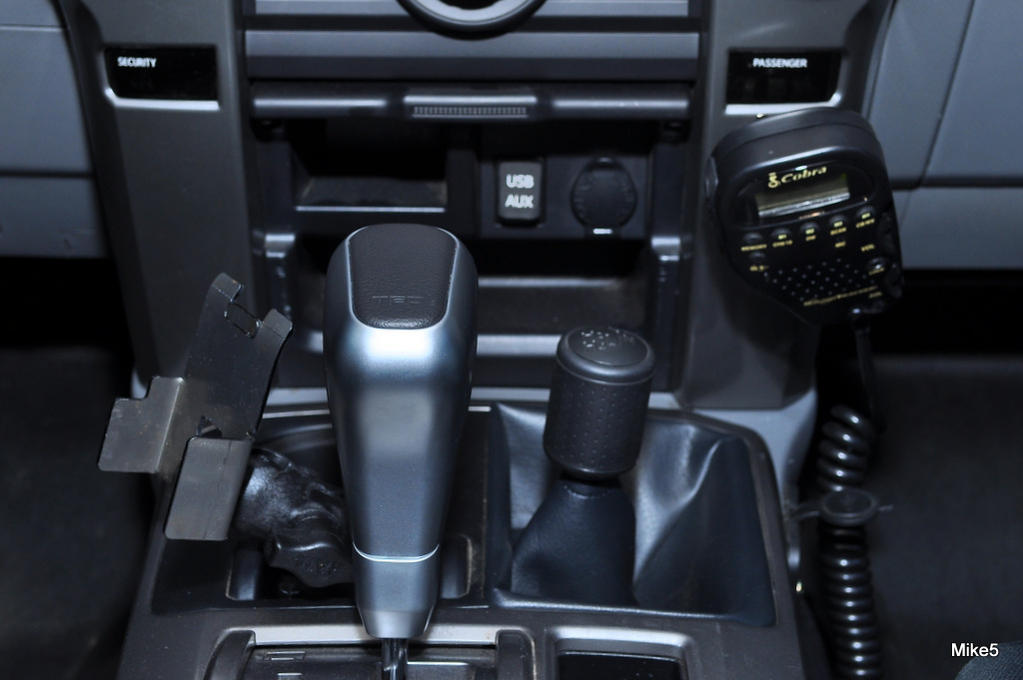

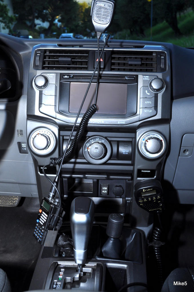

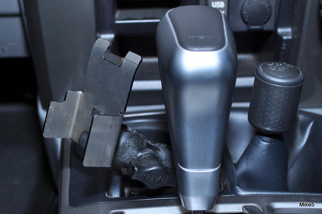

OK, so I got the Cobra 75 to replace my Uniden 510. I liked the 510 a lot but it was inconvenient in the center console storage area (even with a remote on/off switch and an ext speaker), and it was obtrusive in the top pocket of the console by the cupholders.
Since I have some idea of what I'm doing and since I've been dicking with radios in every car I've ever owned, I felt confident enough in the 75 despite the one guy on earth who apparently thinks it's a piece of shit posting not to buy it in this thread.
I'm still waiting on a Motorola mic clip to arrive from Ebay, because I hate your typical CB mic clip; but once that arrives I'll finish up the install of the handset to the top left corner of the glove box, next to my Ham mic.
Until then, here's some pictures of the install to maybe help those of you who asked about it.
I opted to go straight to battery, mainly because I already had wiring in place from the Uniden install which ran from battery to console. Antenna wiring was in place already, as well, running the same path since my antenna is on the hood.
Connection to battery. Red / black with the opaque fuse holders is the factory wiring for my Icom ham. The yellow and brown with the black "blob" is the CB wiring; the blob is a homemade fuse holder made from two female spade connectors electrically insulated from each other and the tape is around it to secure the 7.5A ATO fuse.
Wiring and antenna cables for both radios (6 wires in total) running through the firewall. For reference, if you were in the driver's seat with your left foot on an imaginary clutch pedal, this hole would be 6 inches above your left toes. There is enough room in the existing rubber to make a small slice and feed in a large connector - a PL259 goes through no problem. You could opt to wrap these wires with split tubing but I see no need to do so.
This is the underside of the slip on 'trunk' mount for the antenna that I am using on the hood. The black wire in center is the coax for the antenna, the black wire on right is a ground. You can see that I removed one set screw and replaced it with a bolt, then added a nut under the bolt to separately secure the ground wire. The other end of the ground wire goes to... ground. It is attached to an existing bolt hole on the chassis. The hood is sort of electrically insulated from the chassis because of nylon bushings and the like. There is some connection but not reliable enough to call it a ground, so if you don't run a separate ground like I did you'll have poor SWR.
This is the guts of the Cobra 75. I mounted it in a recess by the passenger seat rear bracket closest to the center of the truck. I used 'hook' velcro on the bottom and just tucked it into the recess and pressed it to the carpet. Bam. Installed. The antenna coax and power wires run under the console and to battery. I know in an above post I said I would install it under the fascia of the console / cupholder area... but what can I say, I'm lazy, and this was close to the already laid power and antenna coax. It's concealed when the seat is slid back (shown slid fully forward). I also kept all the factory wiring in place because I tend to swap things out a lot, and this way the wiring is not cut, making the unit returnable or resalable.
I am installing the mic on the passenger side of the dash, and to run it there I am going under the passenger side of the console, between the bottom of the console and the carpeting. In order to do this, I had to 'unwind' some of the mic cable to make it straight. The way to do this is to unspool it and tape or wire tie it to a piece of wire coat hanger, then let it sit in the sun for a while to form it 'straight'. It's not pretty, but it will be out of sight anyway. By doing this, you basically get a longer cord that can be used to tuck away out of sight, maximizing the amount of stretch that the exposed portion of the cord has.
This is a temporary mock up; once my Motorola mic clip arrives I will build a slim double mic hanger that will mount using the existing bolt holes from my Ham mic, so as to keep from drilling yet more holes....sigh...

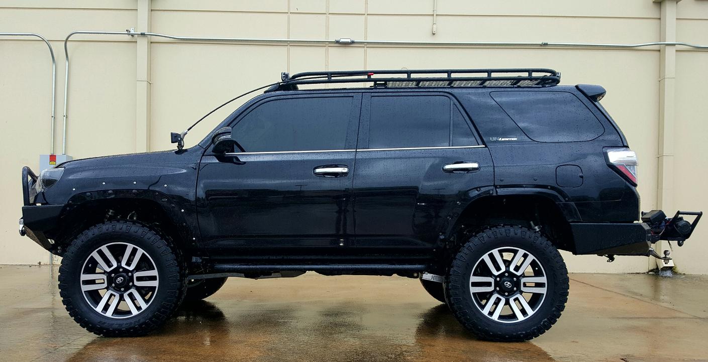

Here is how I am running my CB antennas. This is just a test to see how it works. But if it ends up being the way I run them off road, there is an added benefit of the Firestiks keeping brush off of my windshield.

Damn, yours is the first later 5th gen Limited I've seen that didn't make me throw up in my mouth. Badass!
Do you have a link to the mount you attached to your hood? And also, A pics with the antenna installed?
Closest antenna is CB. Farthest is my 5/8 wave VHF antenna. Both are around 49" before tuning.
I'm not in love with the dual antenna look, reminds me of these hillbillies with two fat Firestiks poking out the back of their bed, but it's functional and the black color kind of blends it.

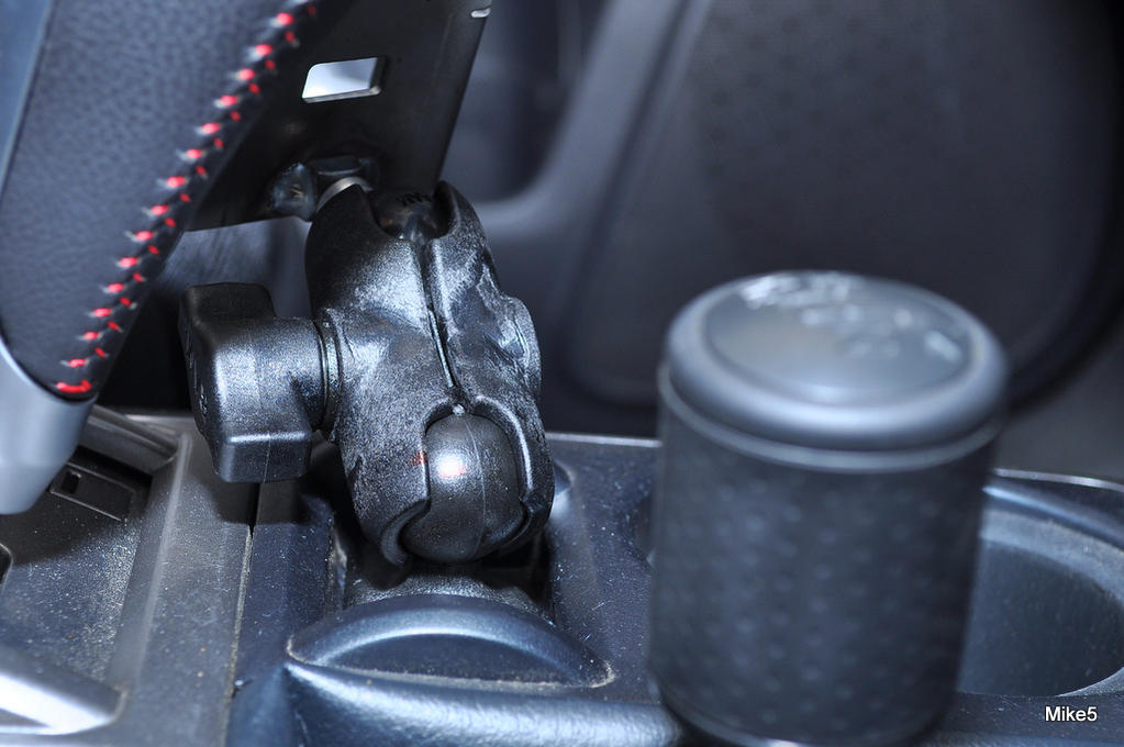

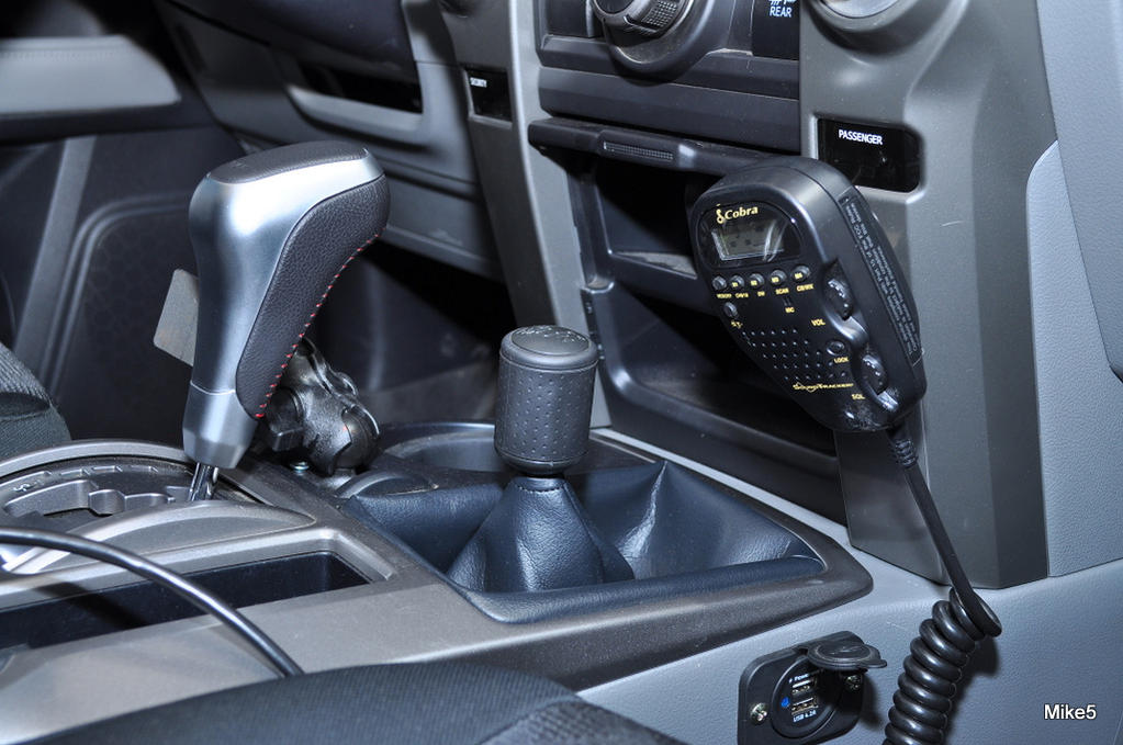

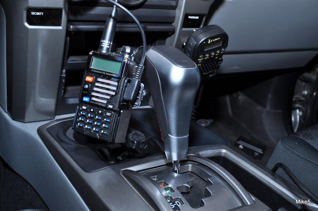

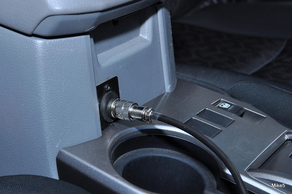

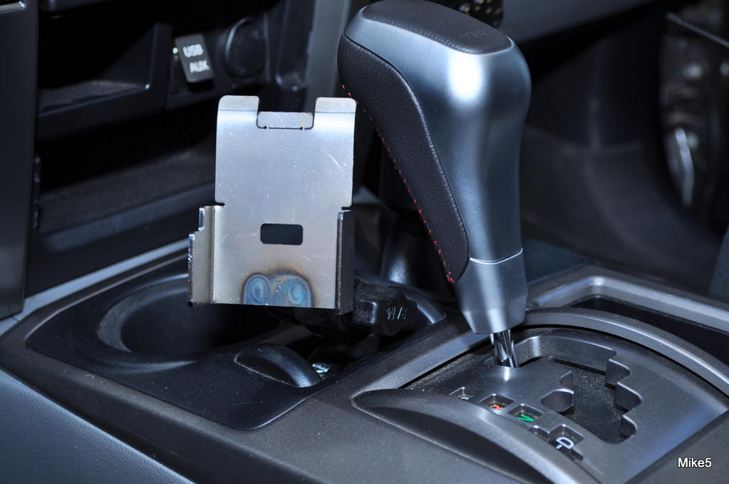

Here's my current setup. Both setup for HAM with and CB. Don't need anything crazy. Just need my cupholders:-)
Antenna pix on next reply.

Just so you know, your HAM loses more than 25db of signal just by having the antenna in the vehicle. Way less than ideal.
