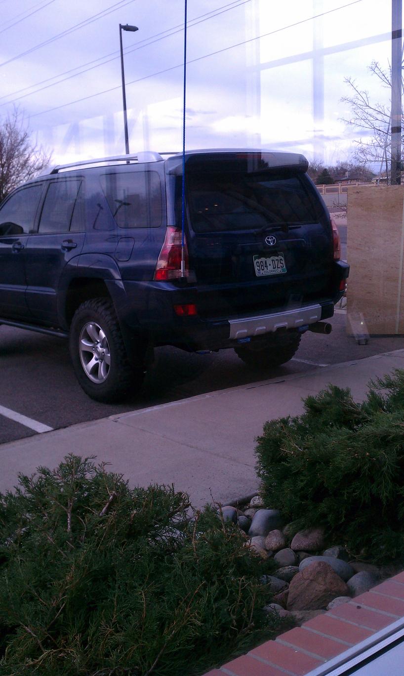

don't know if I went to big
it's more than a foot above the roof line lol
will this be a problem on the trail :thanks:

Looks like that 4runner is electrically powered from the overhead powerlines- like those old school bumper cars.
I hope you got a quick disconnect crashman! Hahaha. Good God that should be GREAT on the highway, assuming you choose the route with no bridges under 20 feet :lookout:
He probably has a 1:1 SWR or zero movement on the meter... he's got quite an antenna on there! :). Excellent TX and RX, too.
