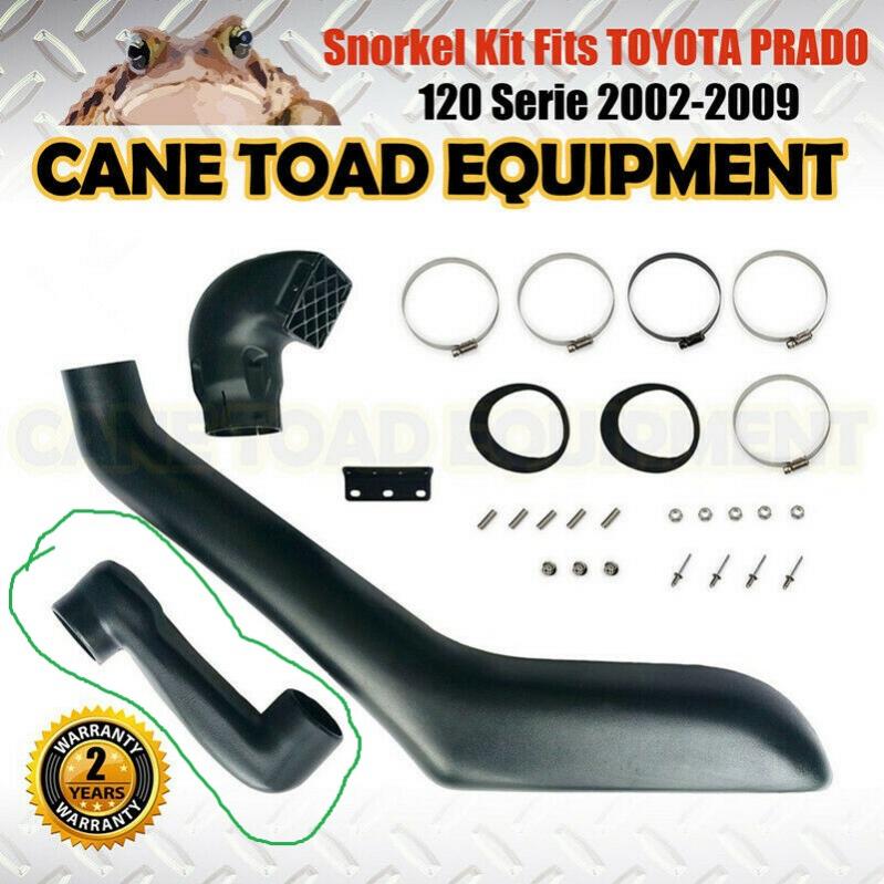

yeah, it makes sense, however, i didnt see the part circled in green in your write up. itd in my package, and am a lil confused where it goes.

I did not use this part, i bought aluminium short pipe for better flow and 2 more 90 degree flex silicone hoses.
