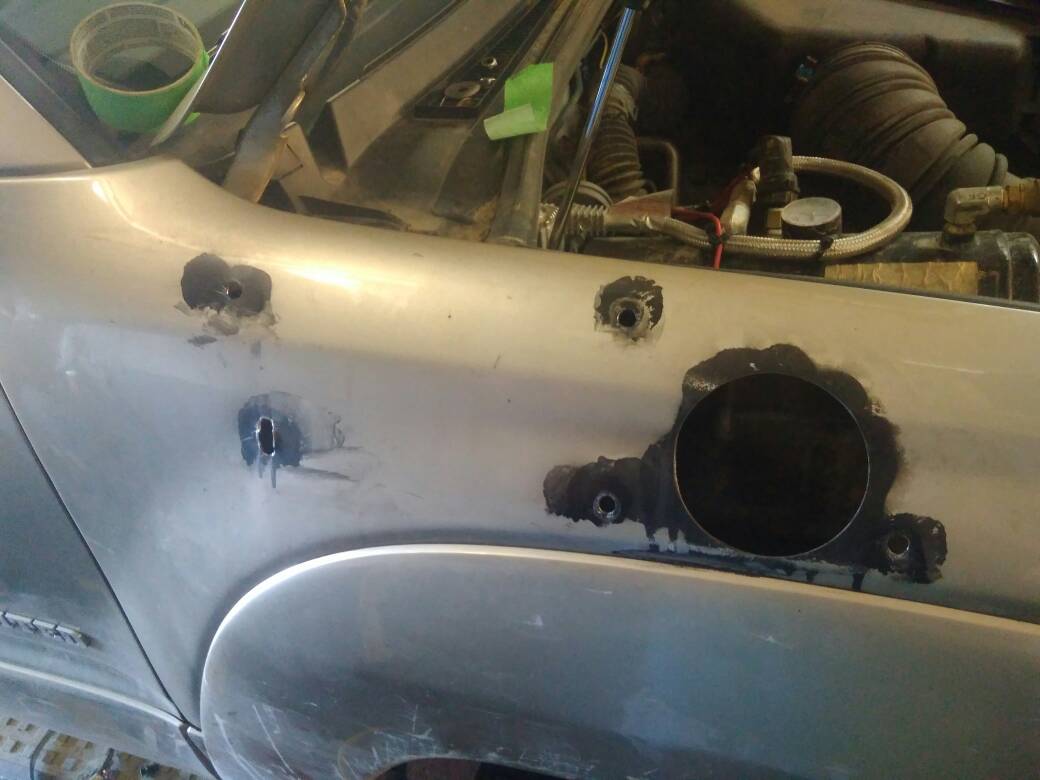

That's how fender looks like after cutting a rust proofing. Afterwards I will spray lots of anti rust oil also just to be safe.

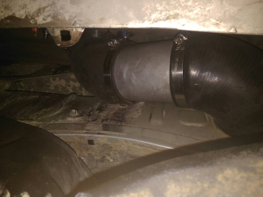

This is custom 3.5 inch pipe and 2 90" elbow flex hoses instead of squeeshed original pipe that comes with a kit. Should breath better i think.

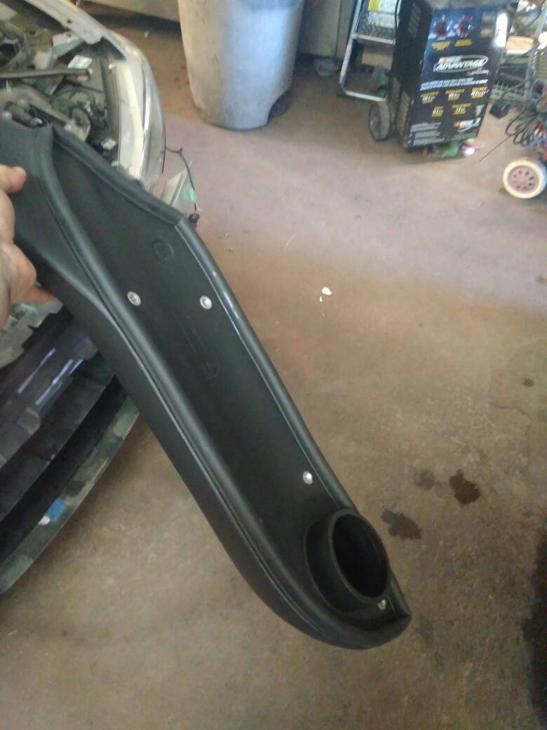

I had to grind off some plastic at the upper section that leans on a-pillar, otherwise the bottom wont sit flush on a fender even with rubber seal. Pipe is very thick so its not a big deal to grind it.
Sent from my Redmi 4 using Tapatalk
