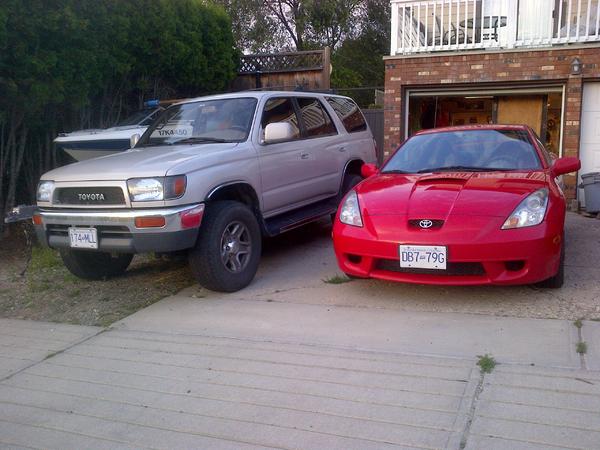

A pic of the soon to be "classic" yotas. The Celica turned 15 years old this month! Why can't Toyota make cars and trucks like these anymore!
Love the pic! I own a 98 SR5 4X4 V6 Auto Desert Dune and I just bought a Red 2001 Celica GT 5spd(with 70K miles)as my DD.
I was looking for a GTS, but when this one popped up, I couldn't pass it up, really its in amazing condition--- garage kept and it only spent one Winter on the road...wow!

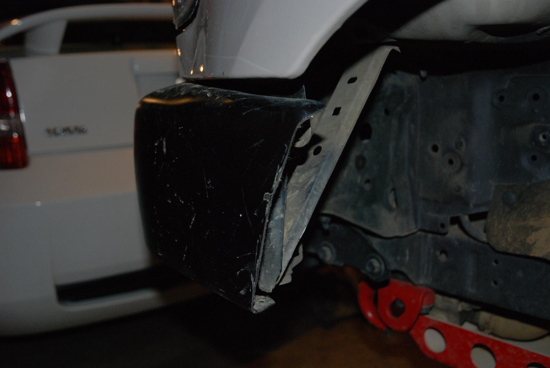

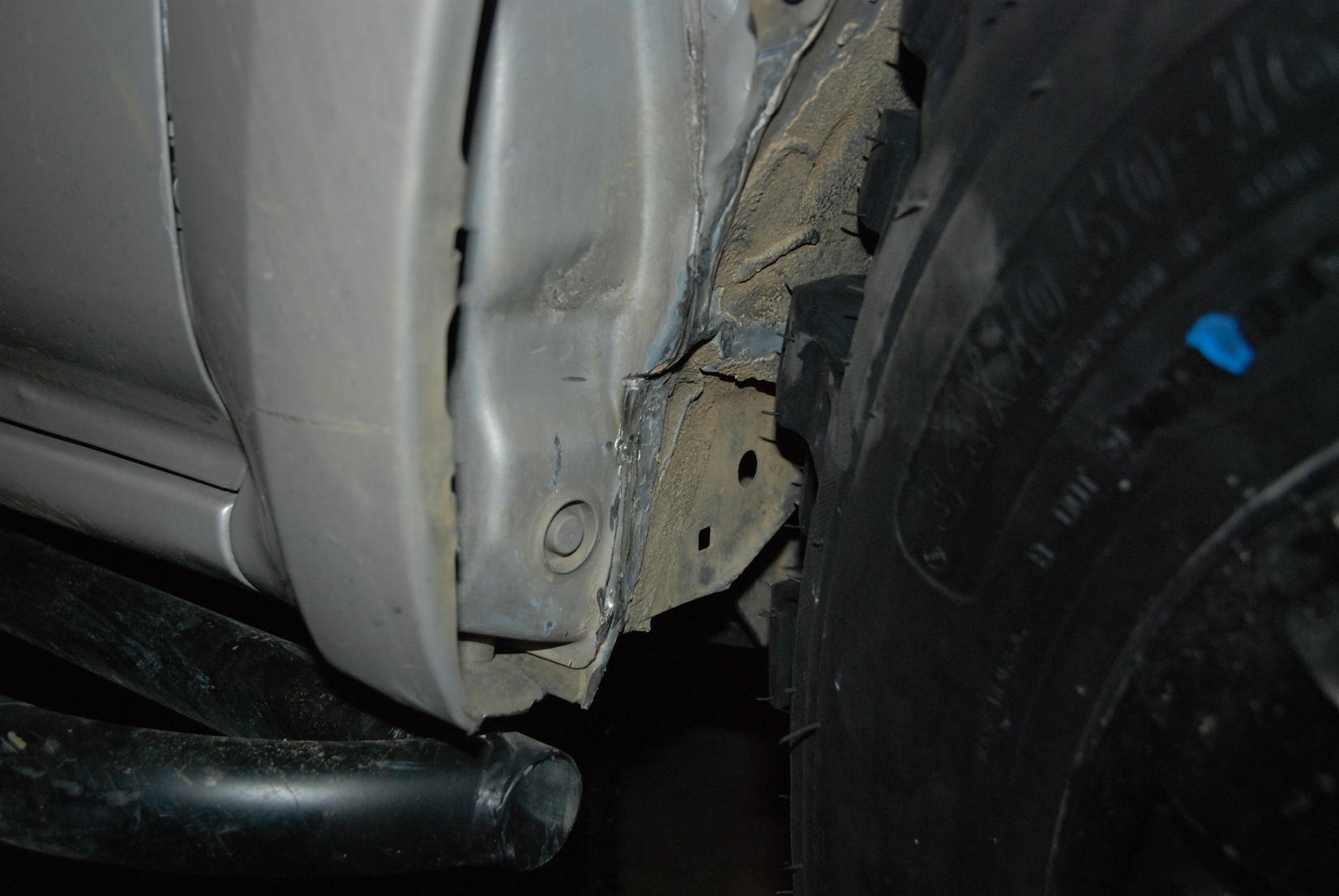

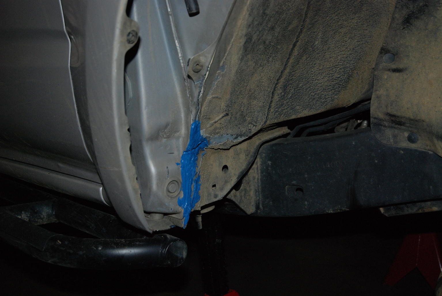

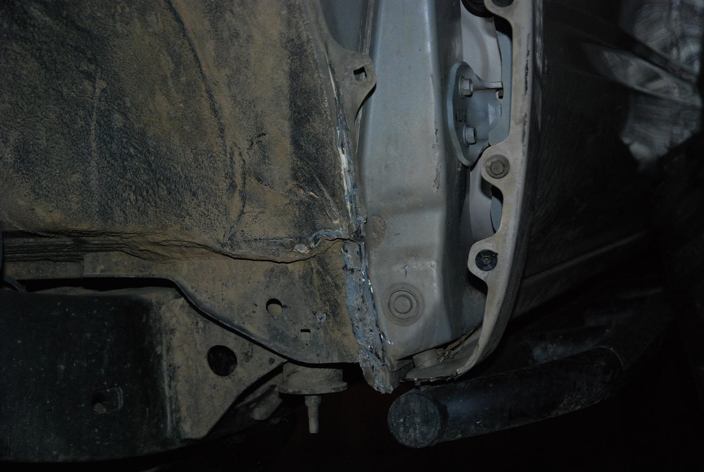

I don't think I ever posted these pictures... they are of my pinch weld cut/ pound
Passenger side
Driver's
Had to cut the driver's side bumper about 1/2" because it was bent in from some fender bender many years ago.

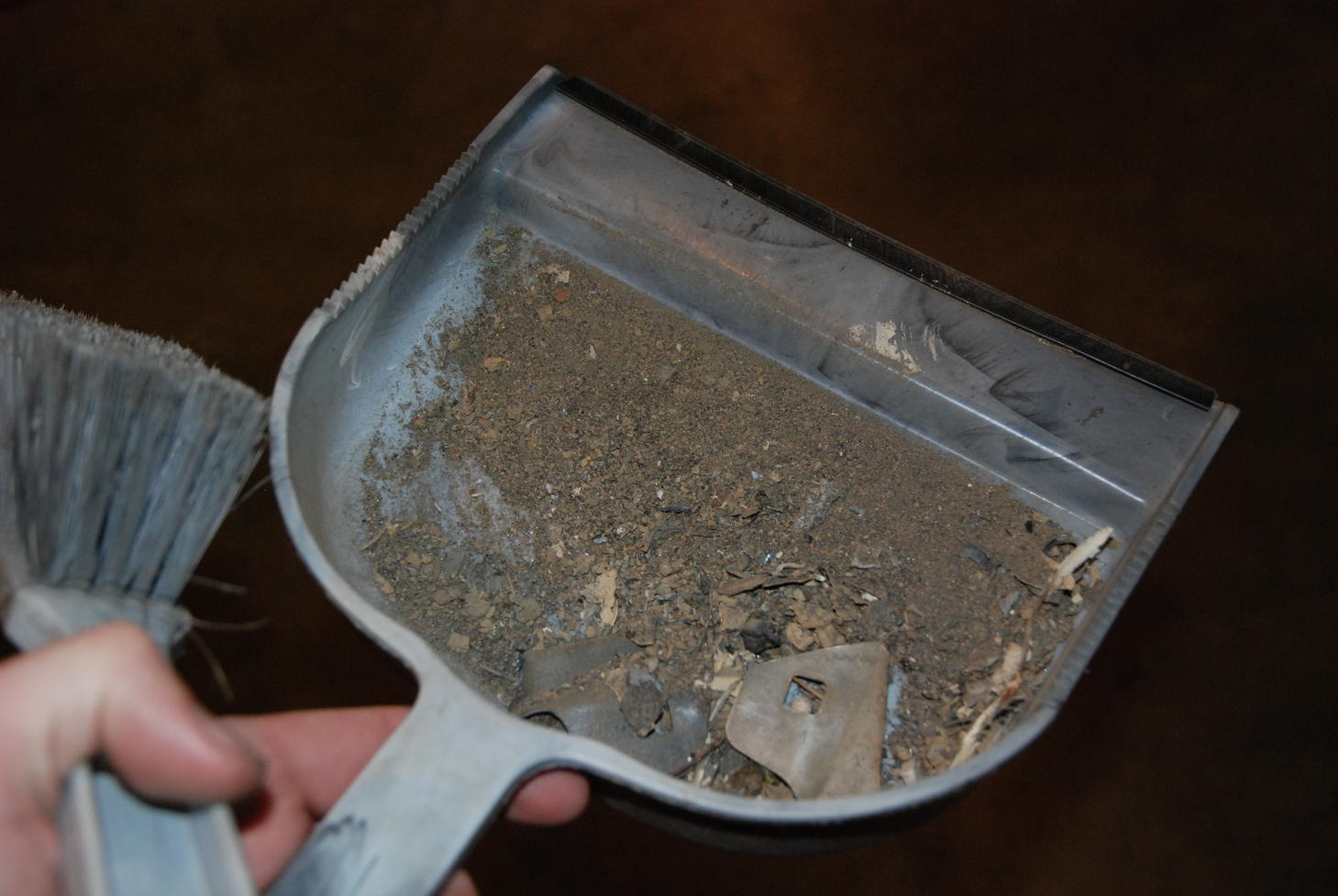

All the junk off the floor

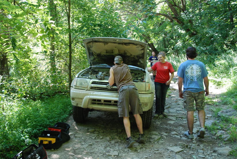

Here's Tara going up trail 11 after me. This is where I got stuck last year and I made it this time!
Then , her alternator crapped out.... but good 'ol chuckles carries a spare alternator!
#rescueRunner
