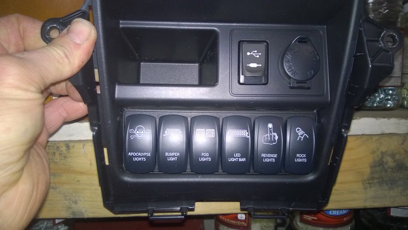

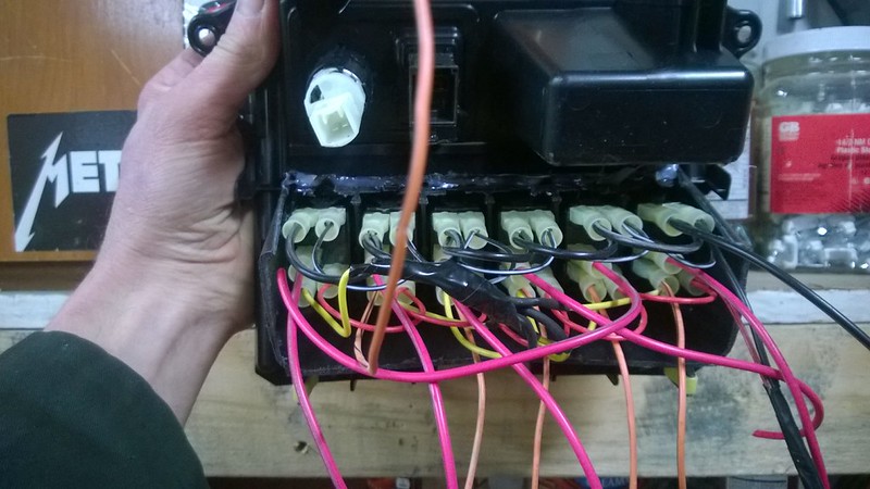

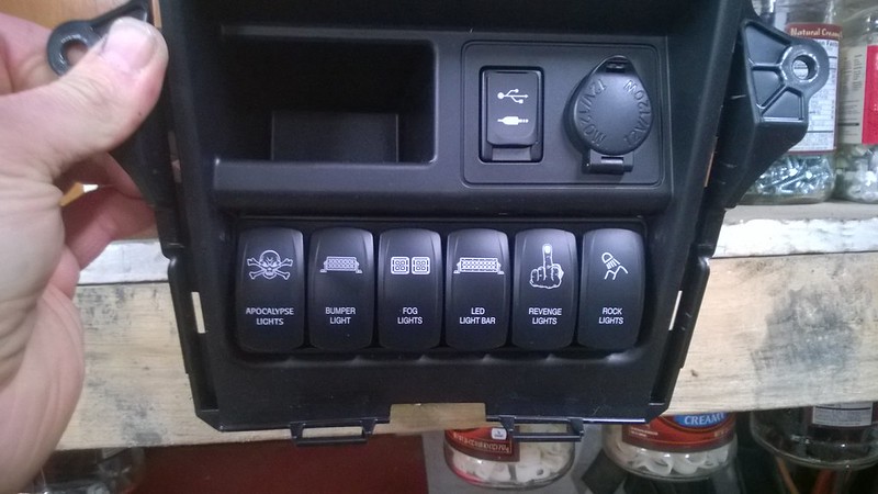

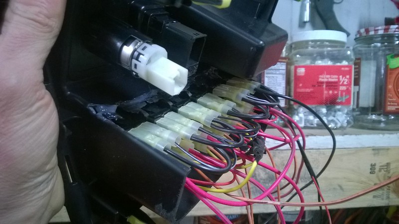

I've been getting a lot of PM's regarding how I hooked up the switches so I figured I would provide a brief explanation. I cannot take credit for this install but I have a friend that I have known for years who is the absolute ONLY one I trust to touch any of my cars. He is a true genius when it comes to this stuff and he never ceases to amaze me with what he comes up with. In any regard he wrote this explanation up for me so I am passing it along.
FWD:
Yes, I did cut out the back of the factory pocket to fit all the wires. The Apocalypse light switch powers all the relays at once. I diode isolated them all so as to prevent backfeeding when a single switch is used. Basically taking the output of the Apoc switch and splitting it 5 ways w/ diodes, and running these wires to the relay triggers of remaining light switches.
As for the light switch bracket, this is what was used Amazon.com : Blue Sea Systems Contura 6 Position Switch Mounting Panel : Boating Electrical Equipment : Sports & Outdoors. I filed down the edges so it would fit inside the opening where the pocket was. I screwed this into the dash from the inside where the switches snap in, and also used hot glue from the backside to make sure it would not come loose.
Cool just what i thought. though I think that black hot glue may help with the finish a bit and perhaps some felt before putting in the switches would help with the fit and finish in the end. I know some people use a fiberglass type product called cats hair or something of the sort for doing this exact type of thing.
The switch connections could be soldered as well instead of using quick connectors then using some type of harness to unhook when removing the panel from the vehicle. In the end it may prevent unwanted electrical issues in the future.
Using the diodes to prevent feedback was a great idea.I like this idea instead of using an extra relay to control all of the switches. I do think that I may end up skipping this as I will need the extra location for my dual battery isolation. It was well thought out and well done. I appreciate you sharing and hope to improve upon this when I am able to do my install.

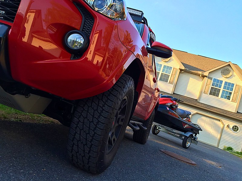

Well its been a while but nothing really new except that the weather finally broke and its time to break out the matching waverunner. The amount of looks I got on the road was pretty awesome. What a perfect match. Now I just have to powdercoat the trailer black and i'll be set. Enjoy!!!
For those who are wondering, its a Yamaha FZS Waverunner 1.8L Supercharged. Its stupid fast, had it up to 75mph. Pretty awesome though.​

Chudiddy, great looking TRDP...and great shot too! This is a really good example of how rich the inferno color is.
Life must have trapped me under a rock for the better part of a year as I just recently learned Toyota even made TRDP 4Runners...sad I know. Now knowing of their existence, I can truly undstand their alure. The orange/black color combination is just sublime.
Your trailer will look great black too...I'd even look at blacking out the rims to match the TRDP even more.
