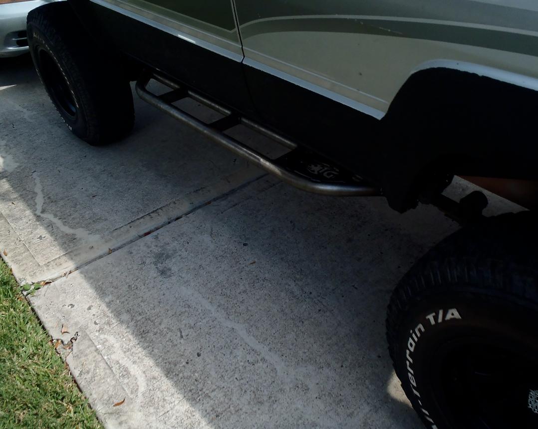

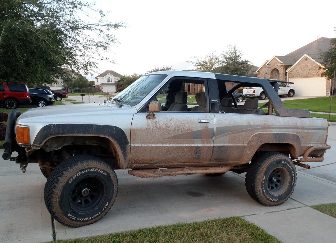

On my trip to Moab in my 89 I commented to Al on the 3rd day that I had not even scraped my sliders. There were a couple of times were I thought for sure they would be scraping along the terrain, but nothing.
Then out of nowhere at about 15mph through a trail that had rocky side I hit my driver side slider so hard that the truck jolted passenger side. Had that simple slider set from Low Range Off Road not been there I am sure I would have never gotten all the damage fixed. As it was, I didn't even have to touch up the POR-15 that I had coated them in.
Point being, get them, use them and be happy that for less than $200 you are saving a huge headache that can come out of nowhere! Welded to the frame is the way to go.
