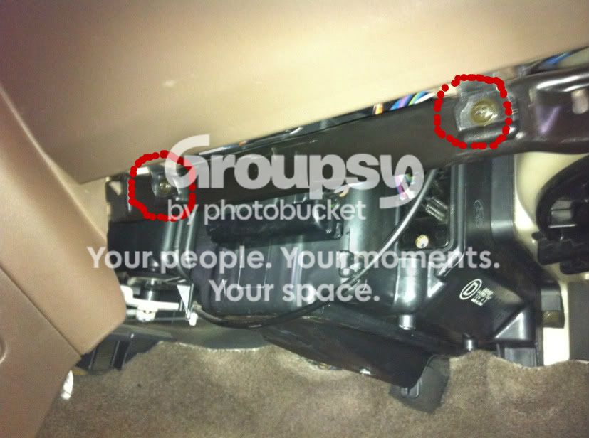

First step is to take out the glove box by removing two screws. Not something you have to do, but it gives bigger guys a little extra room.

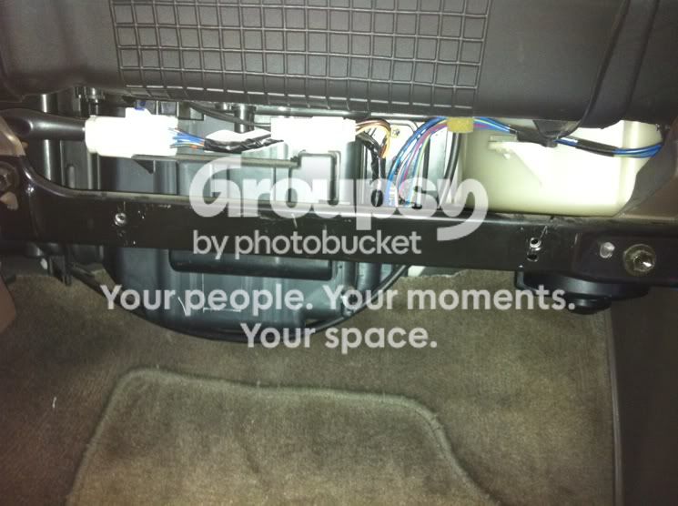

The fan is located behing the support for the glove box.

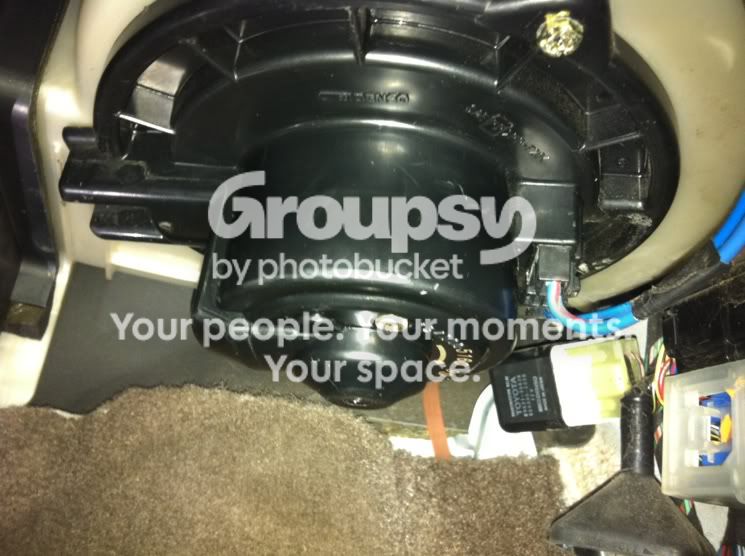

Next step is to remove the three screws that hold the motor/fan. Two are easy, but to get the third, you need to remove the kickpanel molding.
Screw 1
IMG_7482.jpg~original
Screw 2
IMG_1213.jpg~original

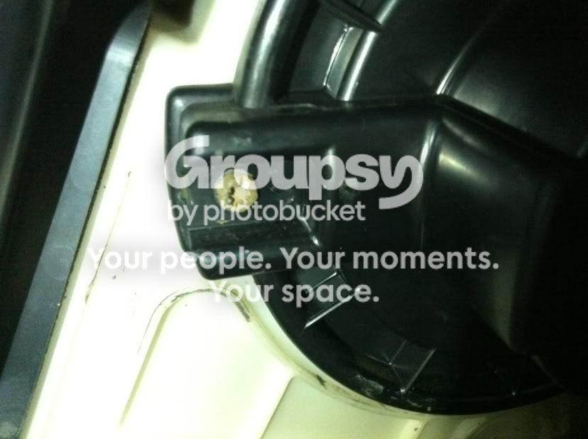

Screw 3...need to remove kick panel to get (or at least make it easier)

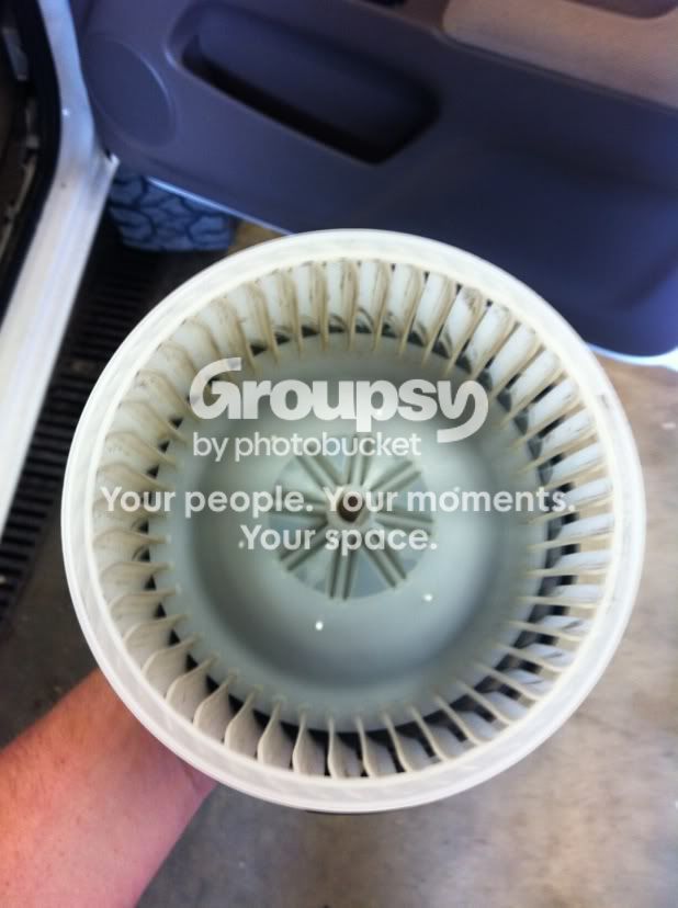

Once the 3 screws are out, the fan should just drop out. Unhook the wiring harness, and clean her up.
Mine was dusty, so I took an attachment on the air compressor and blew it out. Also cleaned out under the fan, then use some dry lithium grease to lube everything up.
All cleaned up
IMG_5730.jpg~original

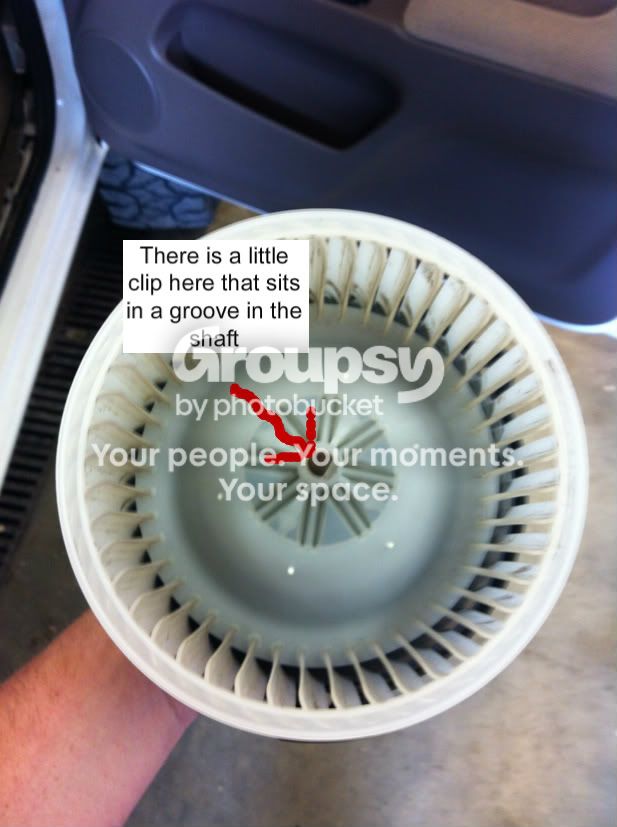

Can someone show how they got the actual fan motor apart? I got it out but couldn't get the thing apart to clan and lube it. There's a clip on there, took that off. But the fan blades wouldn't budge.

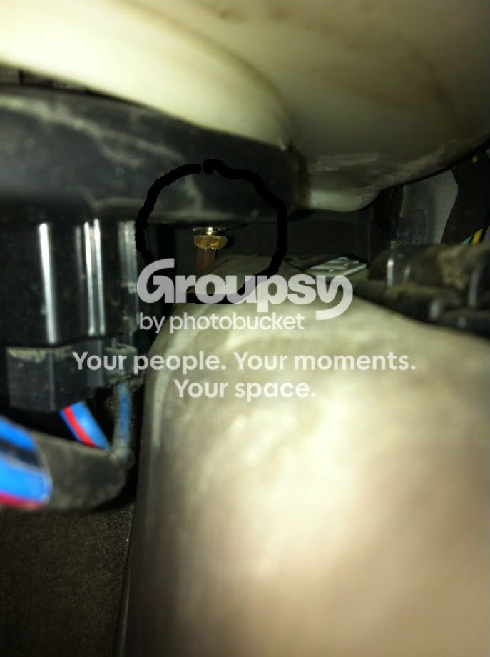

Ya I didn't get mine off either. There looks to be a little piece that clips onto the shaft of the motor. I tried to bend the piece back, but it wouldn't budge. I didn't want to break it, so I left it. I used the straw that comes with the grease to spray up under the fan. May or may not have gotten everything, but had to of helped.
Here is a pic, you can kind of see, but its there...
IMG_5730-1.jpg~original

I removed the blower from my parts truck a couple weeks ago and I couldn't get the fan blades to come off after removing the clip you have the arrow pointing to. I'm going to try again since its just the parts truck anyway and I'll post up if I'm successful.
