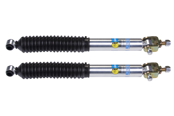

So I have a clunking sound too, and it only comes out when I hit the bump. Now that you've mentioned you didn't have bushings at the top mount of the shocks, I am starting to think that's where the sound is coming from.
1) Will it do any damage if there aren't any bushings? My shocks didn't come with bushings (they are the Bilstein 5125, same as kammando808's in the video, also running Superflexes, if that matters)
Without the top bushing installed, there's room for the shaft to move in the mounting hole when the suspension cycles. So each time you hear that clunk, the shock is slamming against the upper hardware kind of like a slide hammer. I'm no expert, but I'd say that over time that's going to be detrimental to their longevity.
2) If I absolutely need to have bushings, where can I get them?
Autozone, as much as I hate them, has a pretty good selection of bushings and hats in store.
