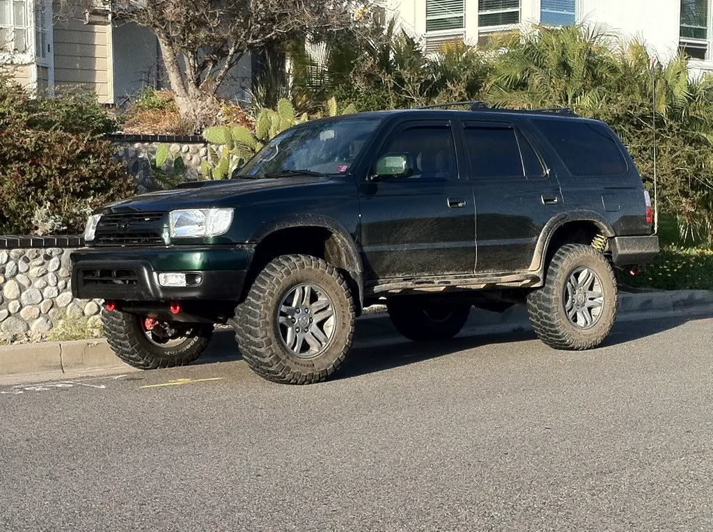

with the tundra backspacing to fit 33"s did you have to get wheel spacers? or is that cause you have the 99 talls and not lift? just curious got the same wheels with 3" and was looking at 33"s :)
Tundra wheels need spacers to run 285's on a 4Runner. I don't have the 99 springs anymore, I have an OME 3" lift. Spacers and you're good :)

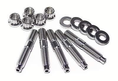

Next up are a set of ARP Intake manifold studs. ARP 400-8013 = ARP 400-8013 - ARP Stainless Steel Accessory Studs - Overview - SummitRacing.com
They're pretty pricey, but from what I've read, totally worth the cost.

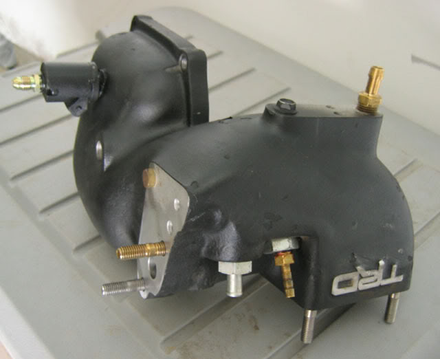

It seems the 5th injector that is currently supplied with the LCE Superchargers is actually fitted into the elbow of the supercharger, as shown here, sticking out on the top left:
I will either have to purchase a new elbow or modify mine to accept a new fifth injector. Modification seems the most economical route.

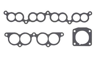

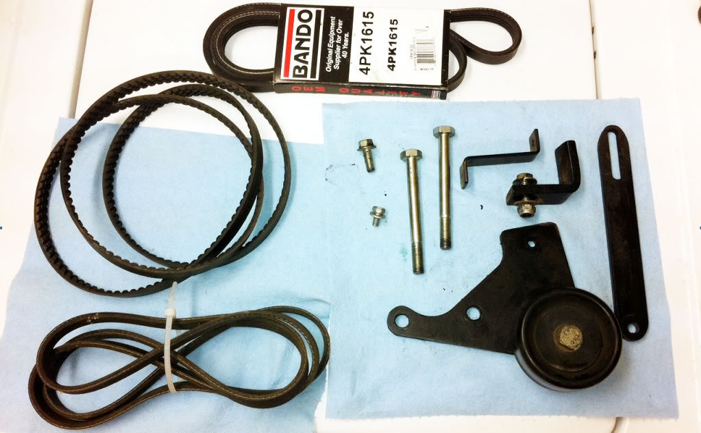

Also, here is what the seller is including with the sale, 2.4/2.5/2.6 pulleys, dynamic tensioner for 2RZ, and UniChip are not pictured. It appears all brackets and power steering pulley bracket, etc, are present. So far, so good! I'll just be picking up the ARP Studs and LCE Teflon gaskets before install. The teflon gaskets are basically isolators that keep heat away from the intake air. By keeping the heat out of the intake manifold, the incoming air is cooler, therefore making more power. I also need a TRD Boost Gauge and pod.
(Picture shown is for illustration purposes only. Actual isolators are white.)

Here's a pic from today :D
