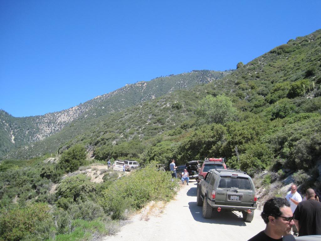

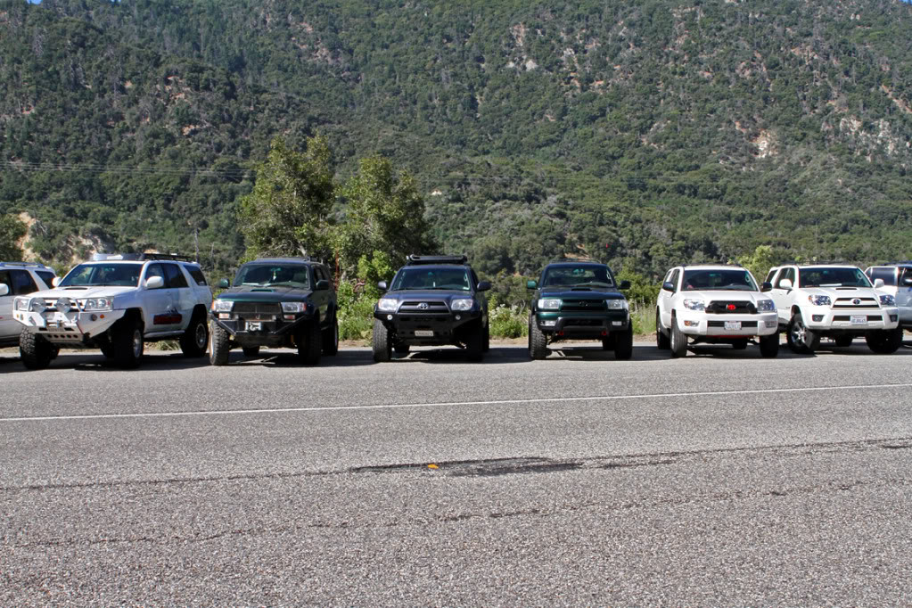

Big Bear meet had a great turn out, 33 rigs!

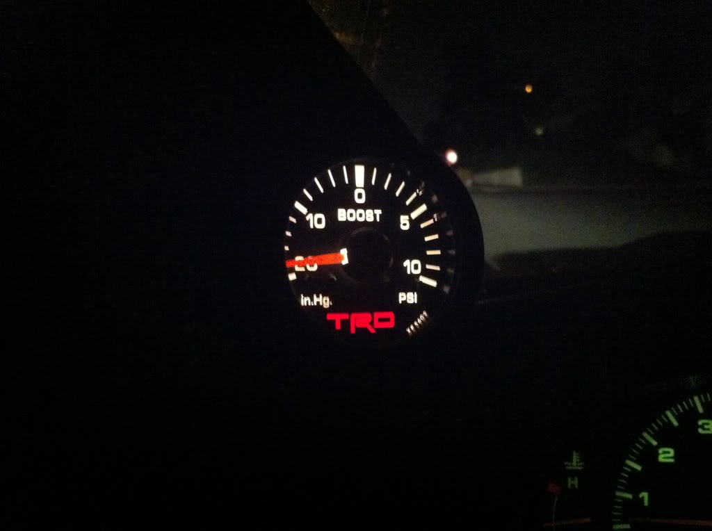

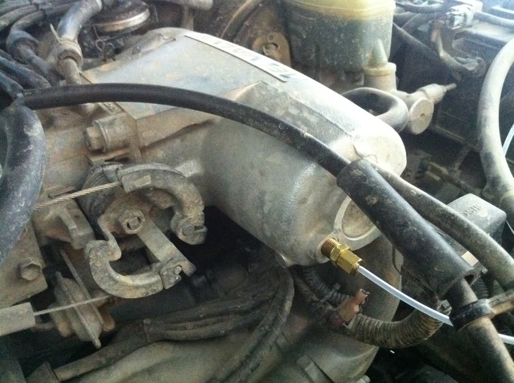

TRD Boost gauge and pod, Thanks A.Wilson013! Ready for that supercharger... though I'll obviously have to find another vacuum line later lol.

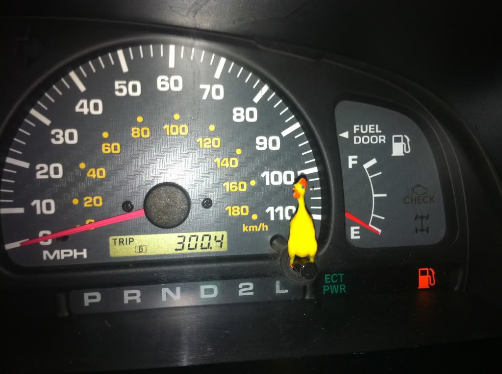

33 inch tires and 4 cylinder and still 300 miles per tank. :thumb3:

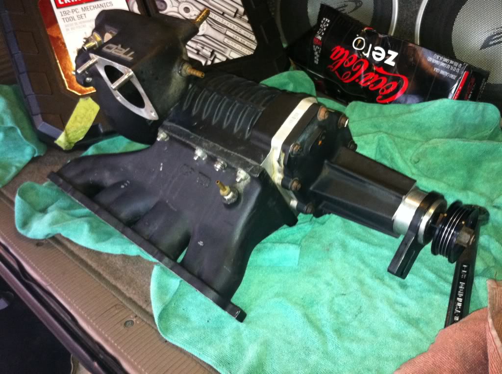

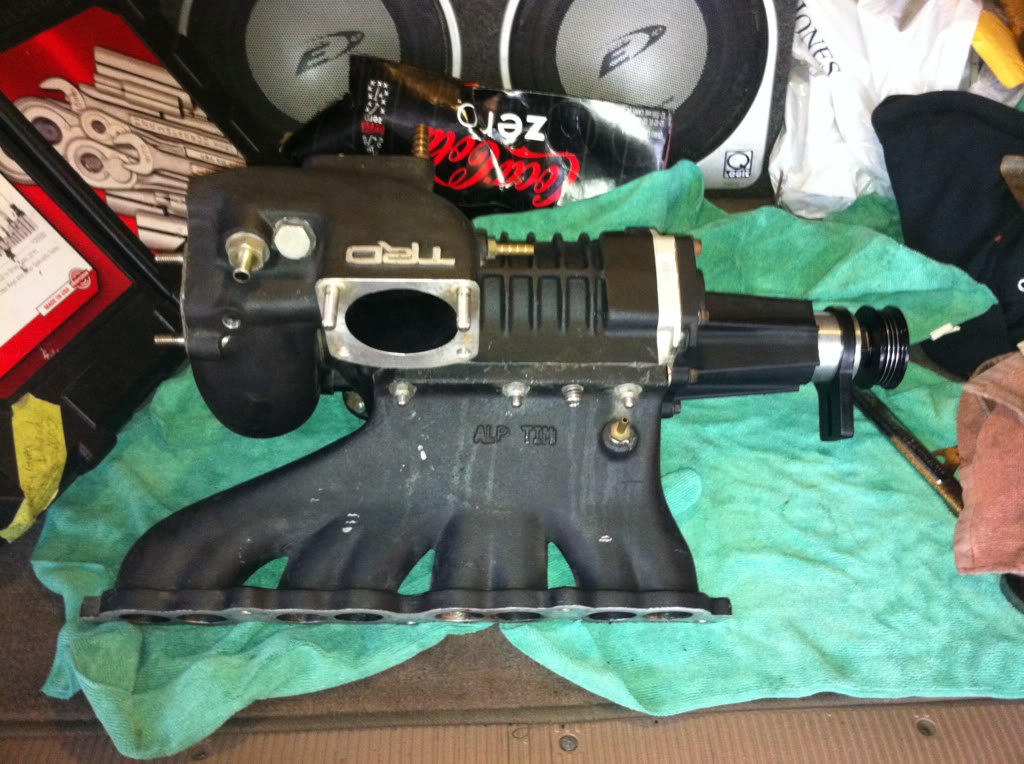

In other news, the UPS man dropped off a hefty package full of happiness and awesome today. Accessories included, not shown.

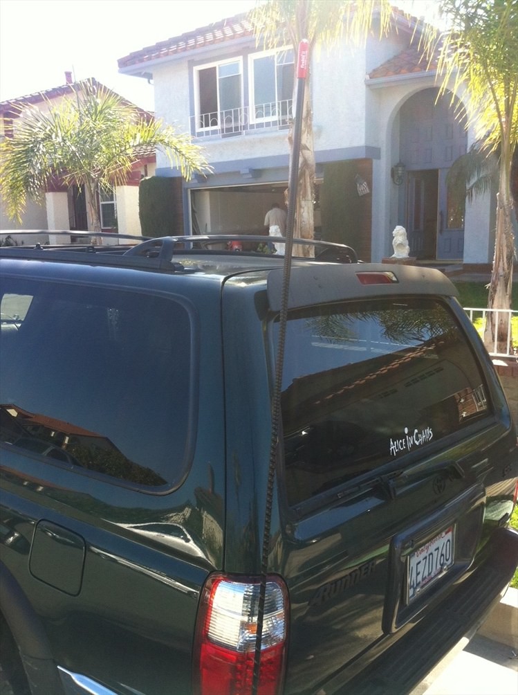

FireStik II.
Waiting for Workman SWR-2t + 3" jumper in mail.

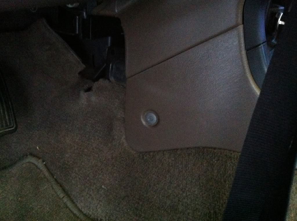

Thanks COB. That answers my question for sure. Last one, how did you wire in the power for the amp? Tap a fuse in the panel behind driver kick panel?
Actually, since I didn't really wanna ghetto rig this, I wired it with an inline fuse to the battery. The speaker isn't too far from the battery anyway, so this was actually a shorter and easier route. I want to get a auxiliary fuse box, but this works well in the meantime.
I am not sure, but I would imagine that the extra power draw from the amplifier might be too high to just tap into an existing fuse... but I am new to wiring. The battery seemed the safest choice for my other electronics.
The driver's kick panel is a bit sketchy, though. I initially installed my CB tapped into the 4WD fuse (ironic... lol), but I didn't like it at all. Instead, to keep the CB from turning on when the vehicle is off, I t-tapped my CB into the radio harness with two male spade connectors. The T-taps were already there from a previous iPod cable installation, which was meant to charge iPhones. I have since changed to a different style that does not charge iPhones and does not require the extra power tap. The CB only comes on with the radio.
Now, you might ask, why wire it to the battery where it will constantly have power? Answer is simple. The amplifier is triggered by an incoming signal (when I talk into the microphone). The amplifier will stay powered for a total of 30 seconds after the signal stops. It then shuts off automatically, so the constant power issue is no problem. The only drawback is that the microphone must be pushed on for about a second before the actual amp turns on, which is actually pretty nice when my friends mess with the microphone when I don't want them to.

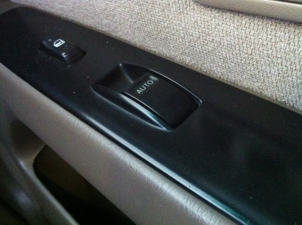

Replaced my passenger's side auto switch. The original somehow broke and became really super sensitive. Swapped in a "new" one from an 01 Sport Edition. Switch only, same bezel.

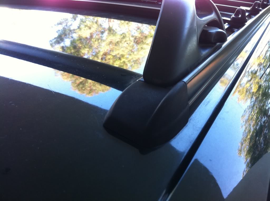

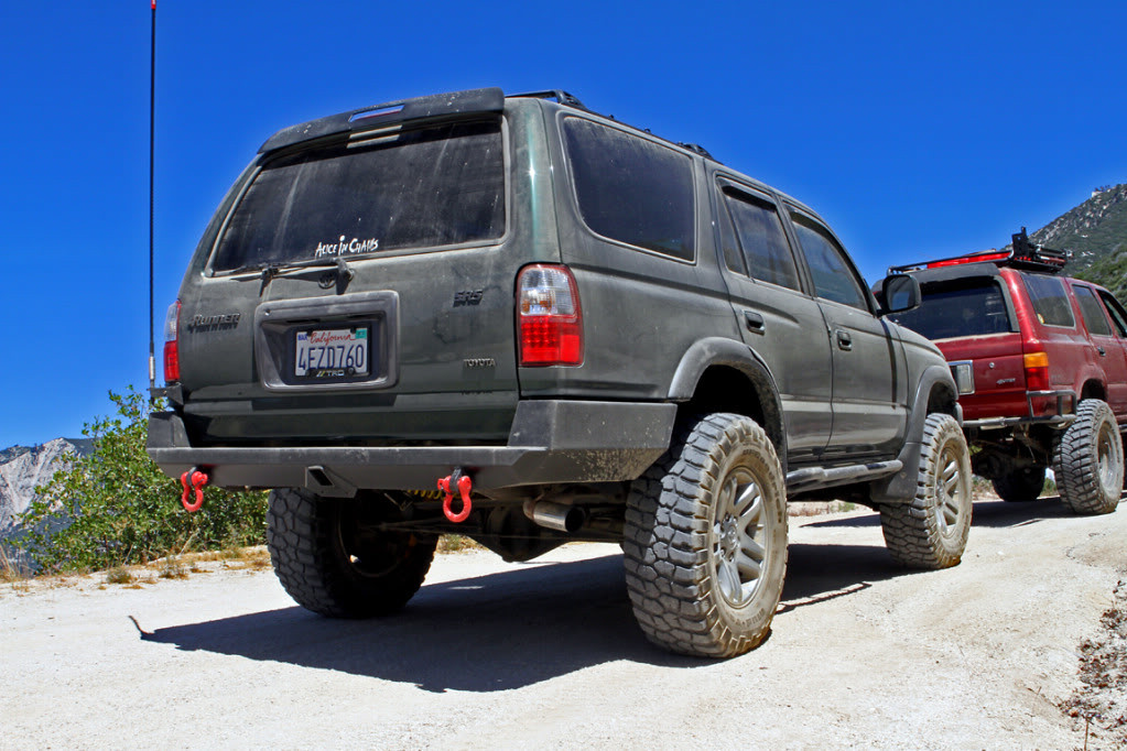

One of my roof rack end caps flew off while on the freeway to buy my steering rack replacement. Finally got a new end cap, from the same donor 01 Sport.

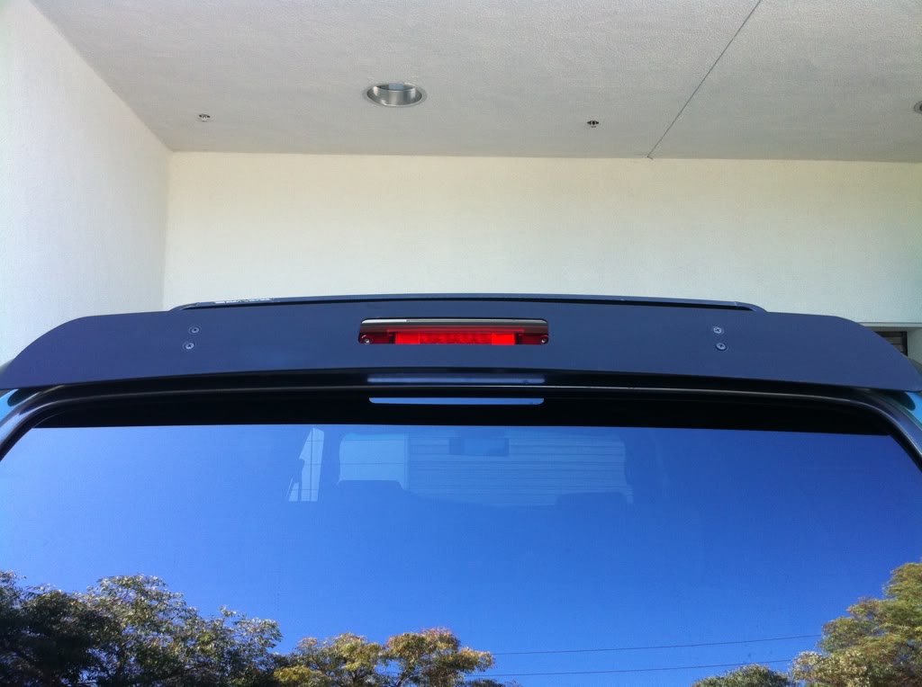

My 4Runner never came with a rear spoiler, running boards, roof rack, tow hitch, or any of that fancy stuff. I bought a used rear spoiler from a junkyard back in 2009. The paint on it wasn't excellent, so I repainted it twice. Since my last paint job, it started fading pretty bad. It was also pretty scratched up (beyond paint work). I decided to swap it out, again from the 01 Sport.

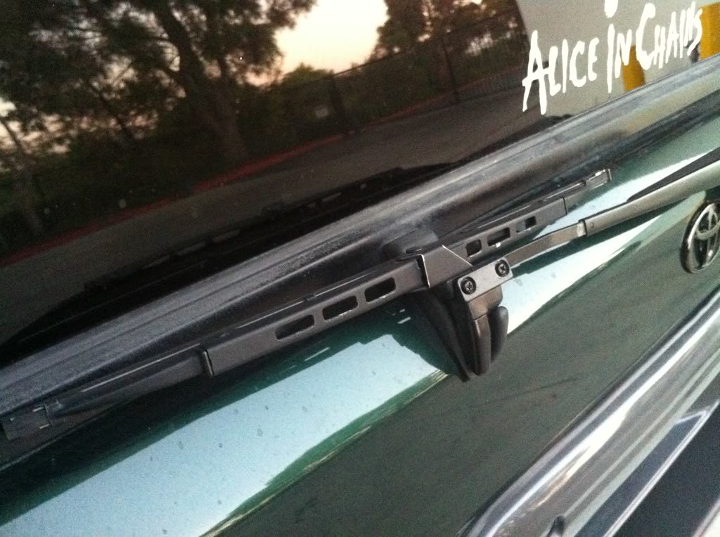

My rear windshield wiper assembly was bent since I got mine, too. I replaced the blade back in 2009, which is when I realized the whole thing was bent. Bending it back didn't help, so I swapped my old wiper for a new one from the same 01 Sport. I went to the Toyota dealer and paid for another insert, though this time, the rear wiper sweeps the whole windshield (which is all I care about)

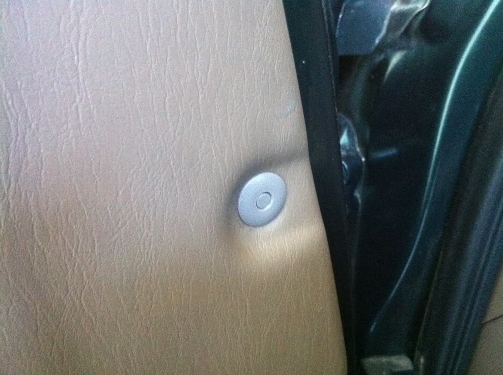

The last, I just snagged a bunch of clips for random stuff like door panels, etc. They don't match the same color, but it's the function I really care about. They prevent a lot of rattling from the door panels. It's sickening when they're not there.
Other randoms include teflon tape for the boost gauge, which is still making noise of leaking at about 7Hg and 3Hg (IDK WTF WHY, it's annoying!)
