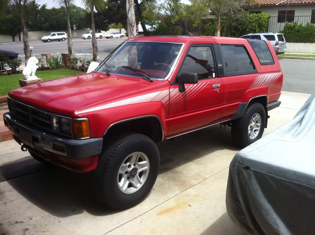

COB's 87 4Runner Turbo
SWEET! I thought I'd pull a C.O.B yesterday, and inquire about a Red 1st Gen I've seen sitting in a Plant Nursery parking lot since the winter. Talked to a family member of the owner, who advised that it really wasn't for sale, but if someone were to give them $3000 - $4000, they'd let it go! I was like, FOGETABOUTIT! LOL! The family member agreed that it was drastically over priced, so we just laughed it off.
I'm gonna keep my eye on it, as it's in decent shape, just needs some minor body work. The Undercarriage looks like mine, all greasy and oiled up, which is a plus around here!

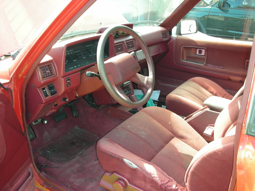

if that red interior doesn't get some ladies...i don't know what else will

Haha, PIMP red interior! Dad was actually pretty excited, he likes old Toyota trucks. He hates seeing a junkyard in the driveway though, lol. It's only a junkyard because that truck was moved out of the garage and into the driveway... stupid pile! :P

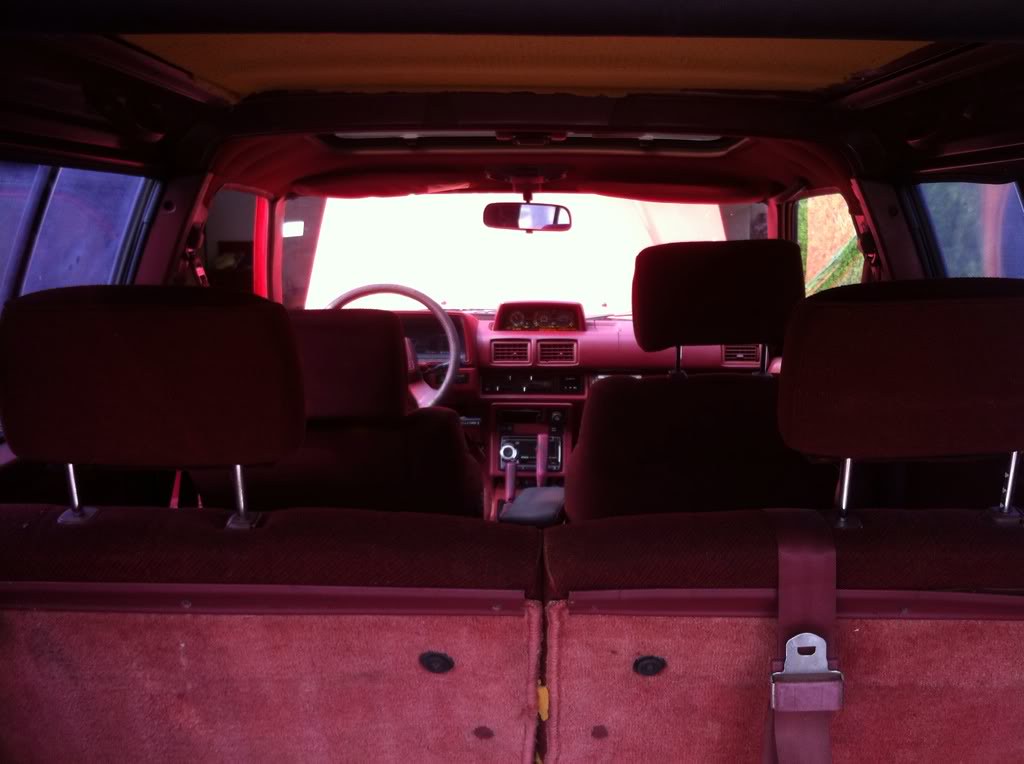

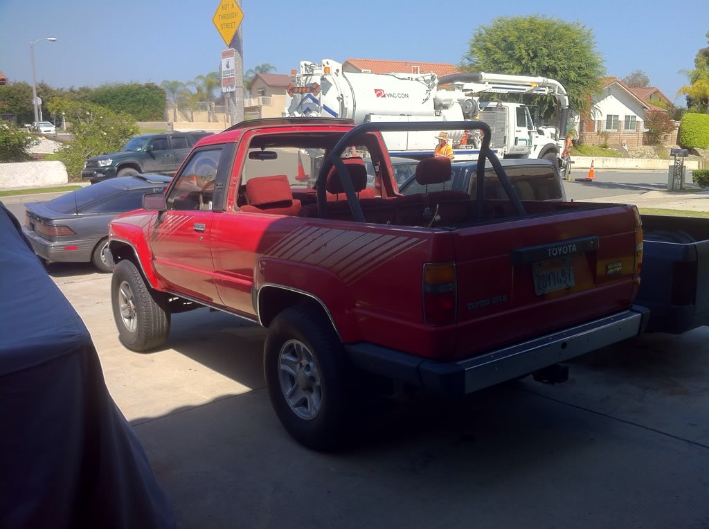

Hehe for fun:

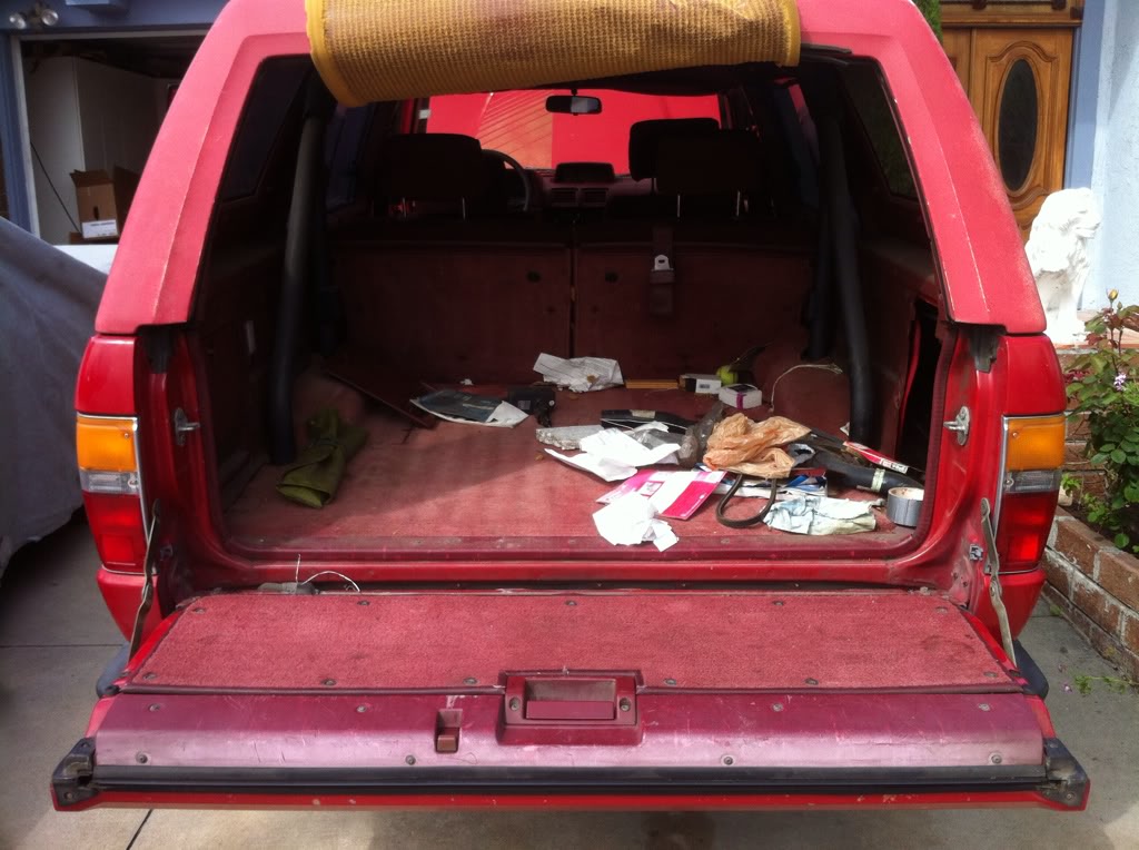

This is about the worst of the interior, the cargo area. The right panel has cracked and broken up. The headliner has peeled off the removable top. Both shouldn't be difficult to fix. The stock jack and tools are there and look pretty untouched. (Forgot to take a pic of the cluster and front seats... will do next time it's light out)

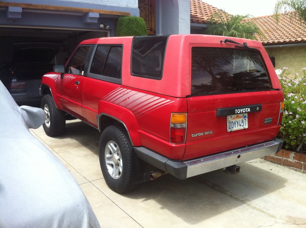

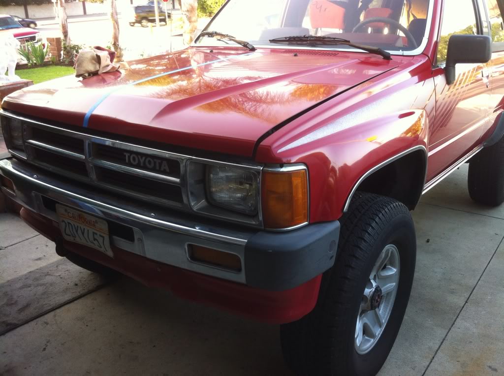

The paint is still looking good. It's been sitting since 2009. Some quick hand polishing:

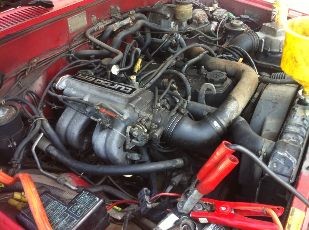

Down to business. Aside from the bad head gasket, the fuel was spoiled and yellow, the oil looked like a really old chocolate shake, and the spark plugs were fouled up. Battery is some ancient Valucraft crap... hello jumper cables.
b5015d48 by cobblewagen, on Flickr
Cylinder 4 had a helicoil.
98dee826 by cobblewagen, on Flickr
Flushed the fuel rail and lines with Shell V-Power. Drained the oil and refilled with fresh Autozone bargain-oil to clean up the rest of the old oil, and a used oil filter that was laying around. Unfortunately, I still can't get the truck to start... Thinking to change the whole cylinder head to eliminate the bad spark plug hole. I took videos of the 4Runner cranking, but they're not really that interesting without a startup... lol
Nice score. After what you've done with your '99, I'm stoked to see where this goes.
ETA - my god that body is cherry.
I took the most perfect video of it's first start. Funny story, even after draining all fuel/coolant/oil and replacing it all, it wouldn't start the whole 3 hours I spent trying to start it. It ended up sitting untouched for about a week, when I decided to randomly give it a go.
The SOB fired right up! In fact, now it fires right up every single time! Mind you, I didn't do one lick of work beyond fluid changes and reattaching the starter.

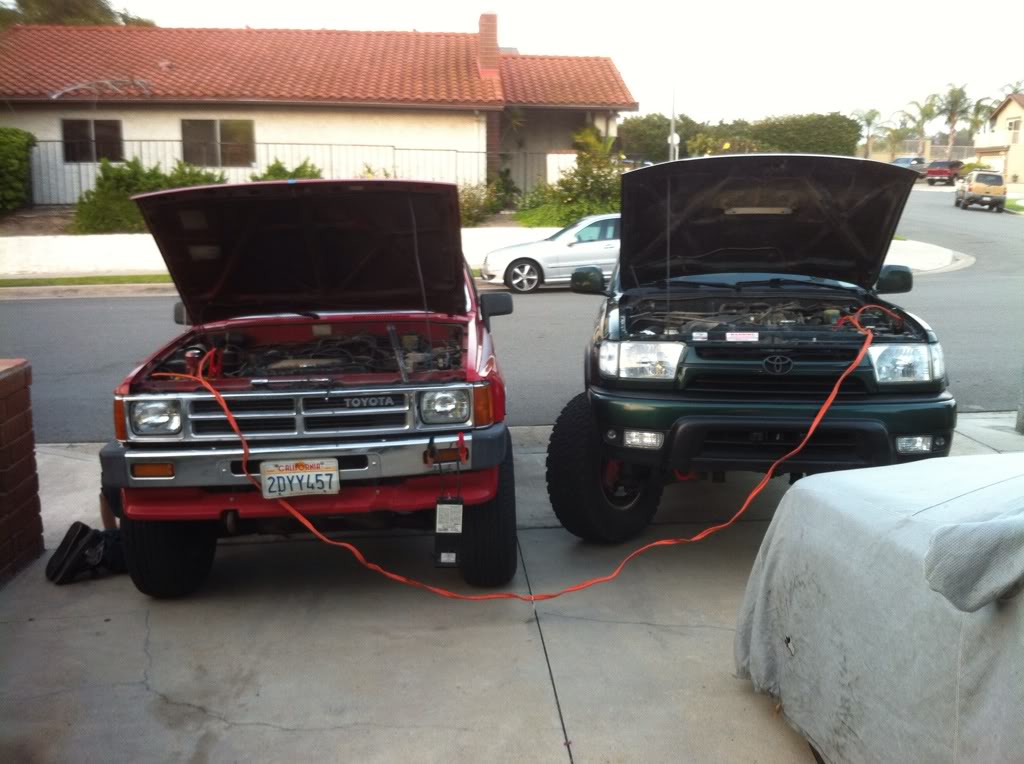

TurboRunner didn't want to start again today. This is a very bipolar truck. Oh well, I have AAA for a reason.
907504f8 by cobblewagen, on Flickr

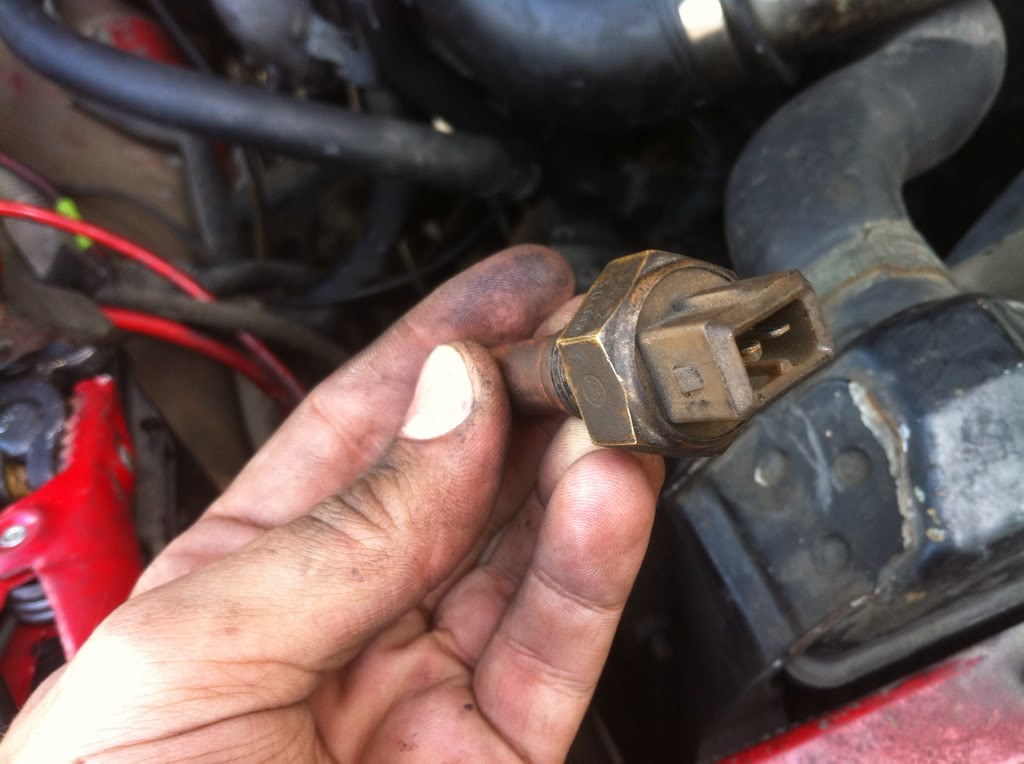

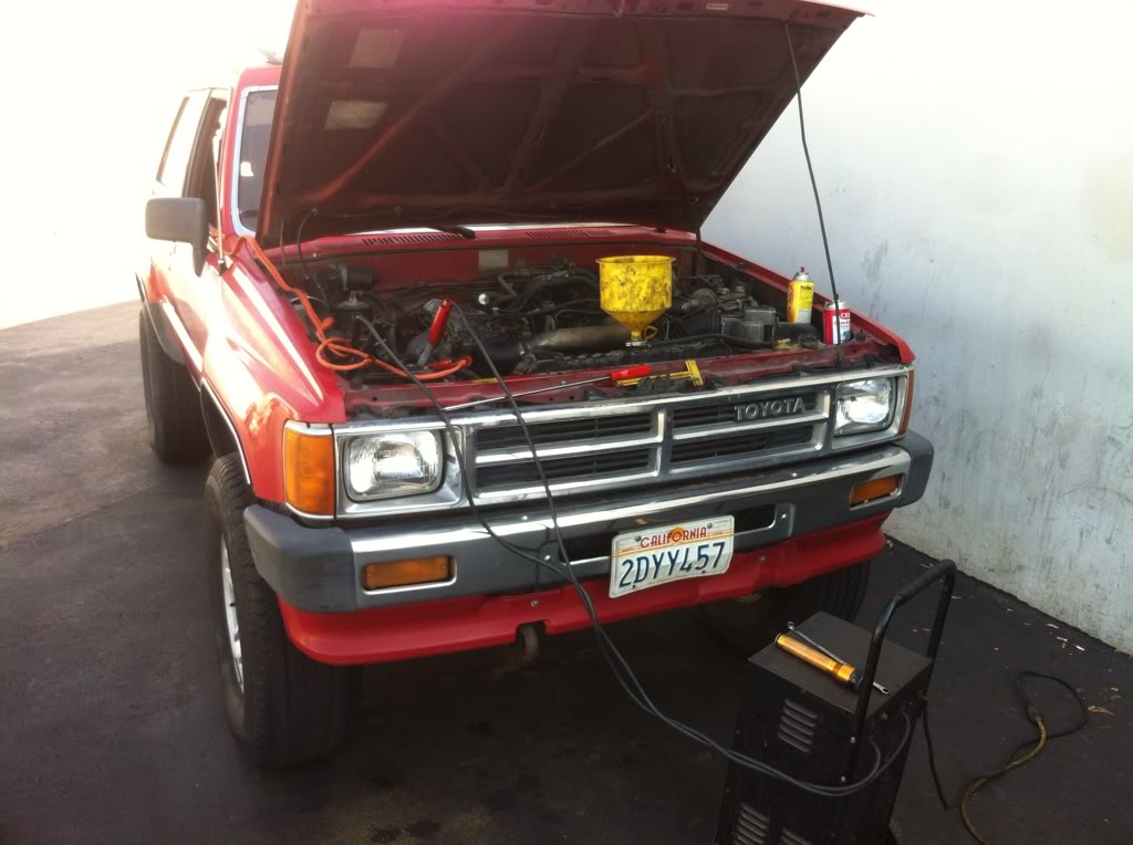

Immediately got to work. For some reason, the truck would crank, fire a few times, and die again.
463907fe by cobblewagen, on Flickr
94cbfc2c by cobblewagen, on Flickr

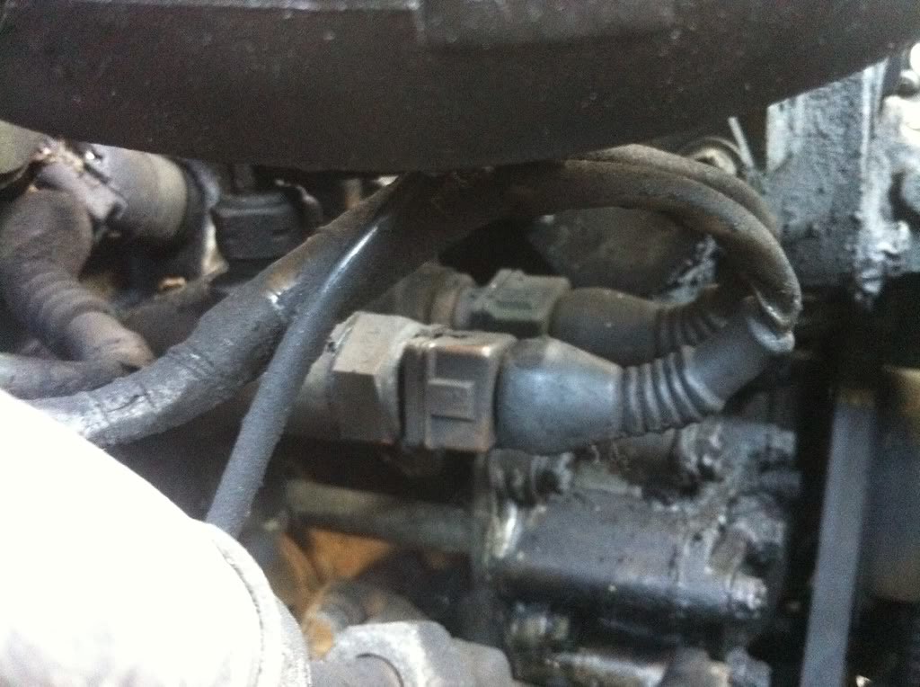

The 22RTE motor uses a cold start injector with a coolant temperature sensor. I changed the sensor with a known good sensor to make sure it was correctly operating. No change.

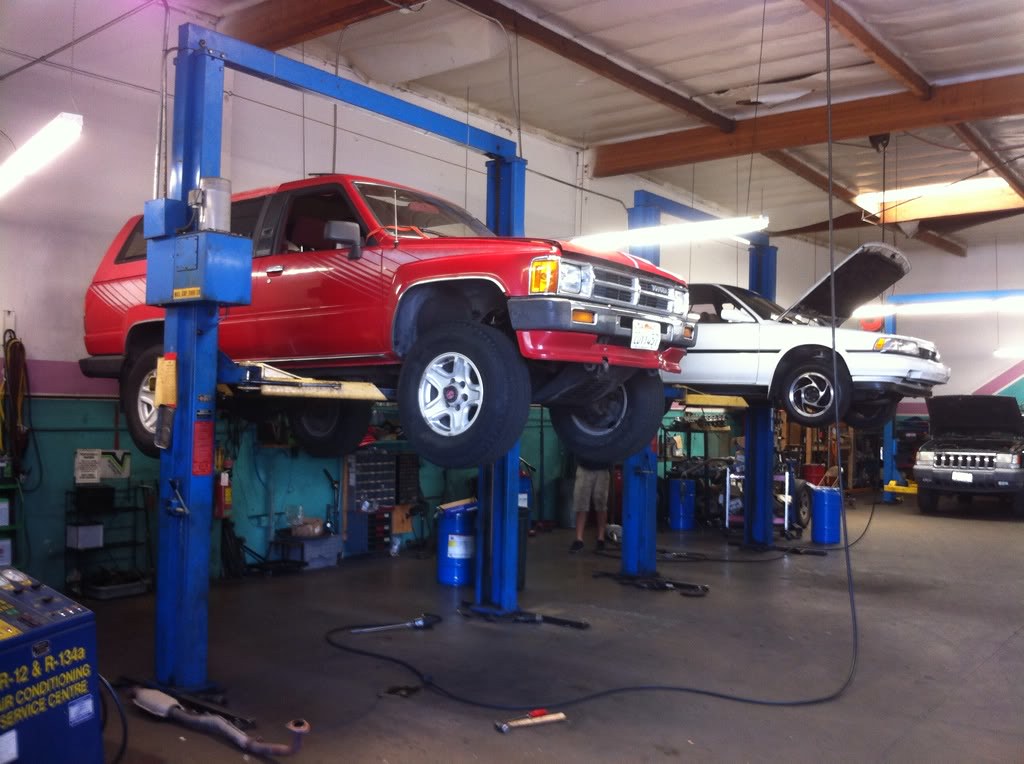

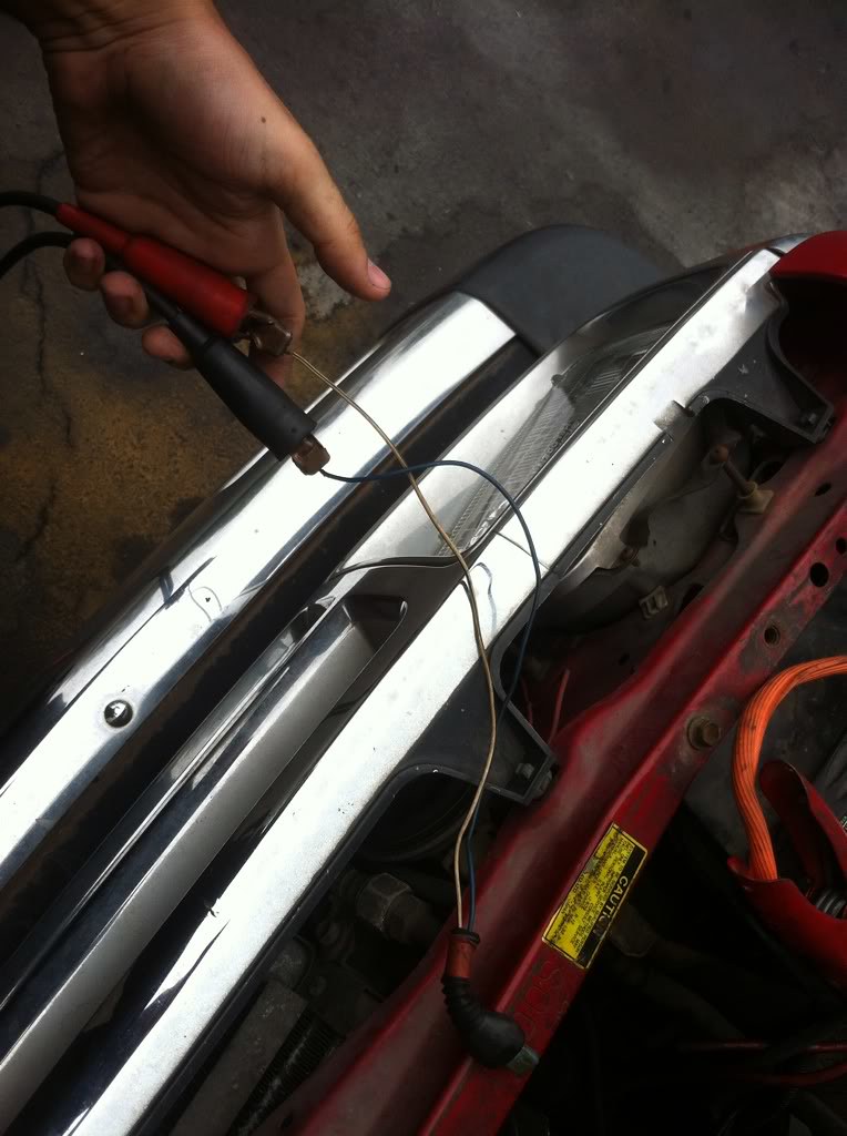

There are no ignition or fuse problems, either... so we moved onto electrical possibilities. We pulled a pinout for a turbo 4Runner off the internet. Using a Vantage diagnostic scanner (the same one I used to test continuity for wires during my 4WD conversion), we checked fuel injection signals from the ECU. Signals were fine at initial start and then stopped as the engine died.
Now, here's another reason why the perfect mechanic is really a godsend. This guy has a 1985 solid axle Toyota pickup that he's converted to a completely OEM 5-speed and turbo. This guy knows his stuff. It's about this time when John asks me for the part number of my ECU, 89661-35050. He never ceases to amaze me... he hands me the keys to his 85 and tells me to test my ECU in his truck. Sure enough, ECU 89661-35050 with the dismantler's vehicle details "1986 4Runner 4x4 Auto Turbo."
339bf1f7 by cobblewagen, on Flickr
2dffa75e by cobblewagen, on Flickr
If my phone didn't start acting up again, I'd have had a short video of it driving into the shop under it's own power. Too bad, my phone sucks. So, now I've just gotta find myself one of these ECU's. I may have found one for $100 in Maine at a dismantler.
The engines main problems: bad head gasket = low compression in cylinder one, rod knock, helicoiled spark plug hole cylinder 4. Engine hardly creates enough vacuum, often dies during automatic gear changes. Lots of white smoke.

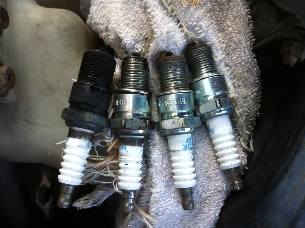

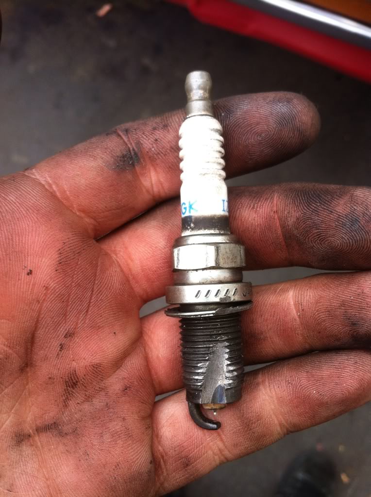

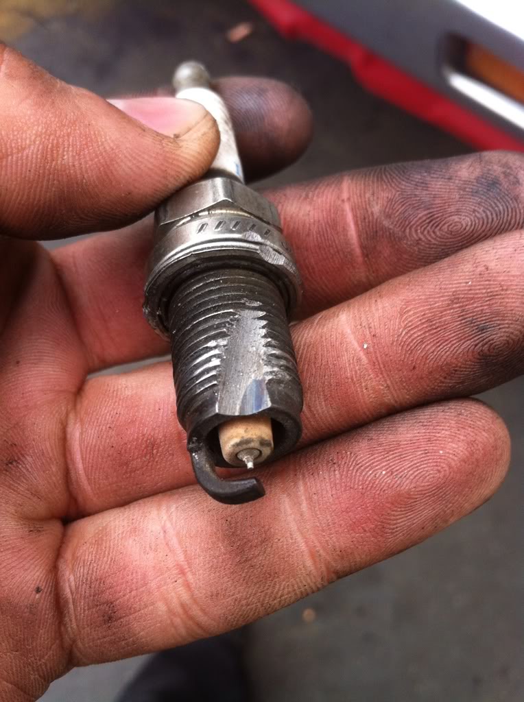

Cylinder 1-3 spark plug holes have seen better days. The threads are mostly crossthreaded and jagged, it should not take excessive force to unscrew a spark plug. Another one of John's toys: Self tapping spark plug. All 3 non-helicoiled holes are smooth as butter now. As far as the helicoiled plug, lots and lots of loctite so I can remove the plug from the helicoil itself. Head is pretty screwed up lol.

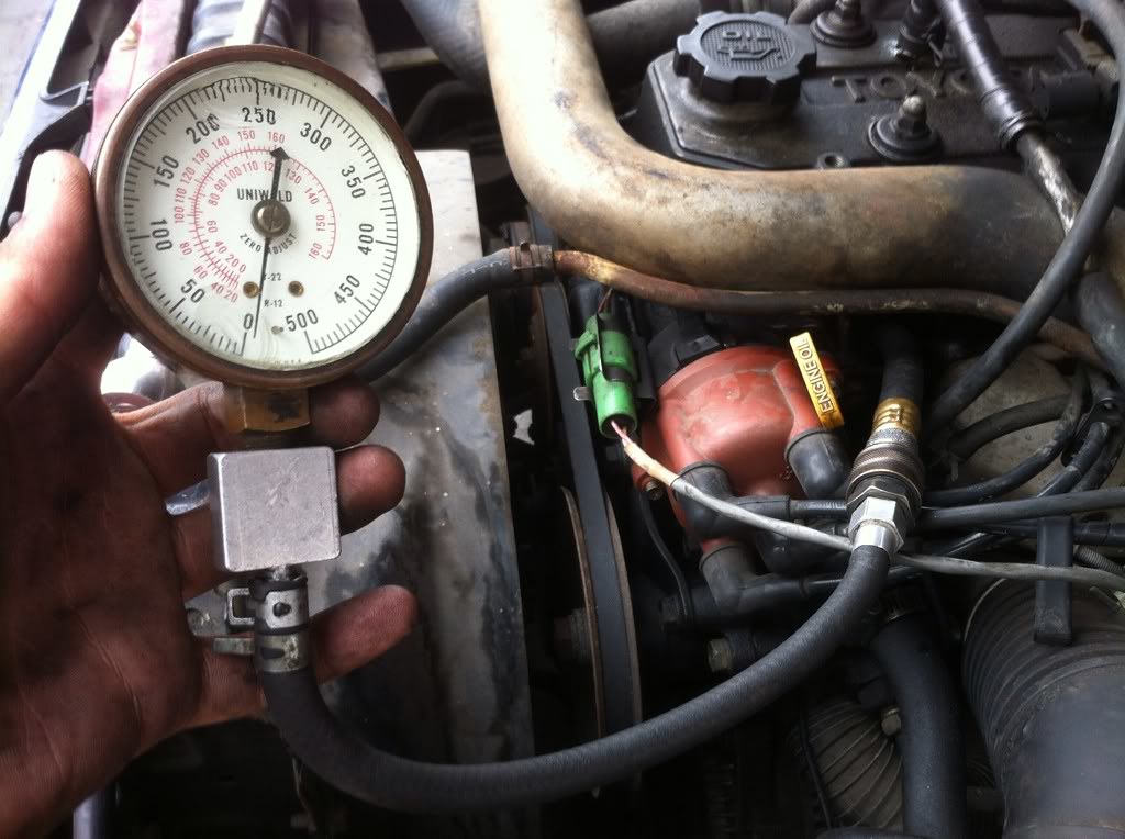

Compression tests: Cylinder 1 and 3 have very low compression. The other two have good compression.

It appears this is the first time she's ever been topless. I also find it very cool that there's one bolt for the top that has a switch in the bolthole to toggle the back window power.

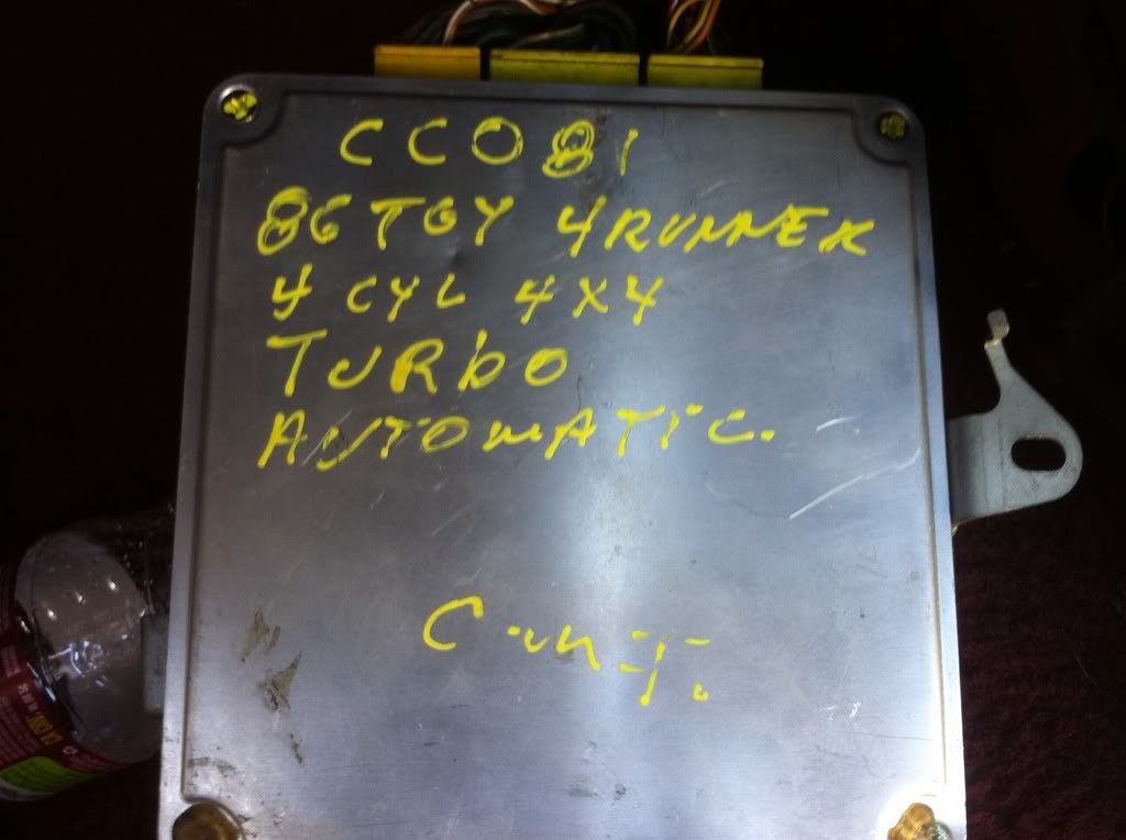

Just a random update. I have been speaking with many junkyards trying to locate an ECU for this truck at a reasonable cost.
I found one in Ellsworth, ME, and if they can confirm it's the right part number, I'll be able to drive the truck again.
