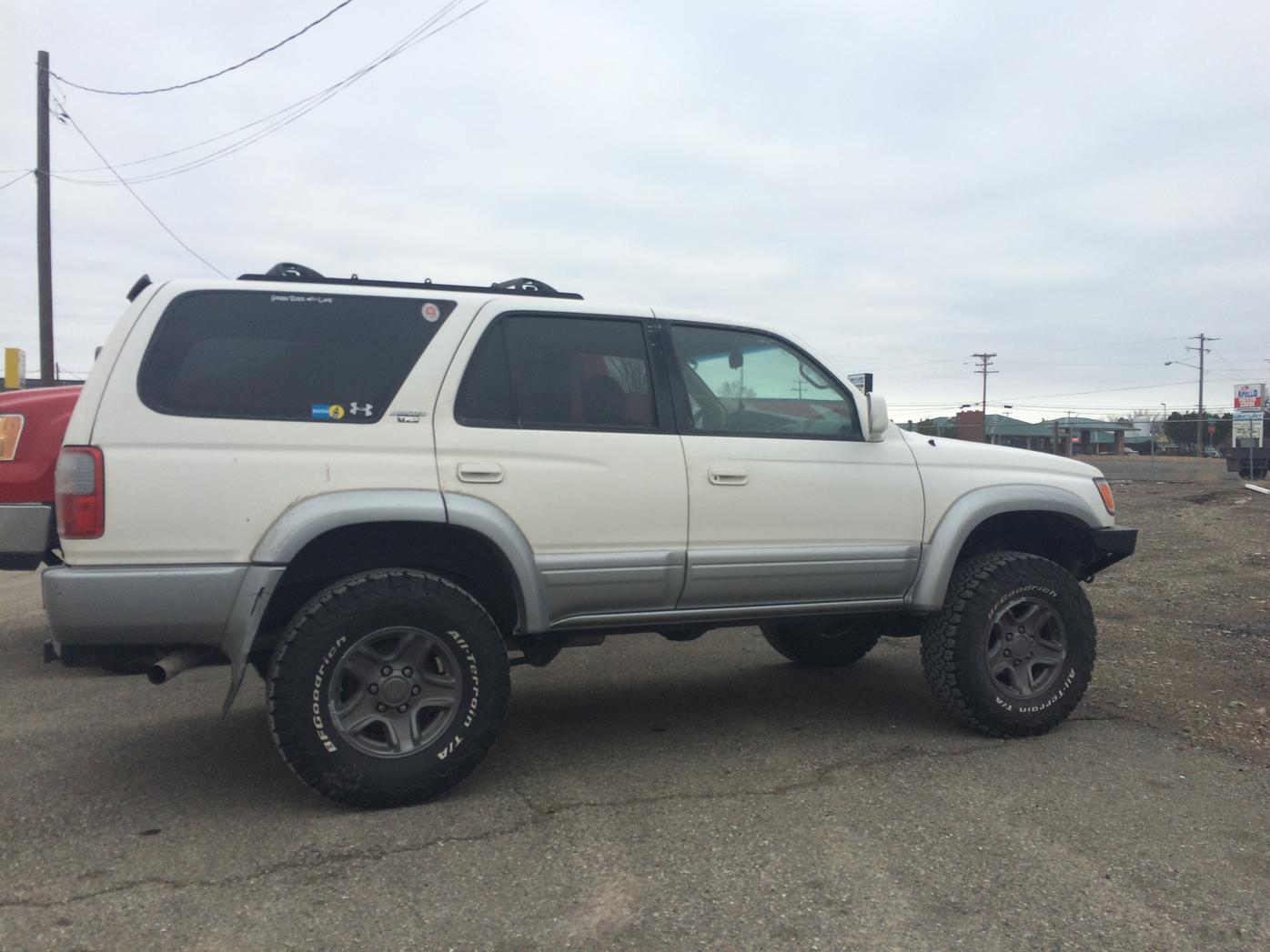

I have Tacoma Bilstein with 881 on front (second notch) and 890s back. I got 2.5 up front and 2 3/4 in the rear. That's with my plate bumper on as well.
