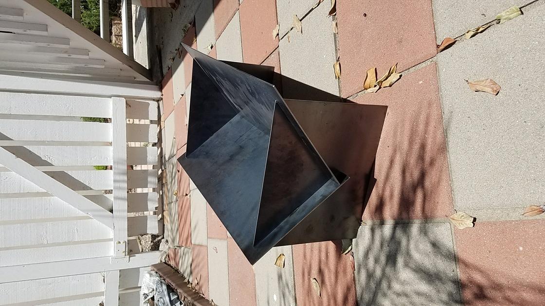

OK to DIY on this, I'm not handy but did it anyway
I first saw something similar over 2 years ago, prior to Fold A Flame coming out. The design seems to be popular in Australia, but could not find a company selling it in the USA.
Somebody in Australia had posted a design/specs of their DIY version, using carbon steel, and I gave it a try. Used a carbon blade on my circular saw for the main cuts, and cleaned it up with an angle grinder.
1/8" carbon steel, 26" long, 11" high. Yes, it WILL rust. I don't care, it was $70 worth of steel and is covered in soot all the time :) Stainless steel would have been $150, and harder to cut.
Since I took this picture, I've also drilled a bunch of 1/3" holes in both ends to enhance air flow/make a cleaner burn.
I have been looking for a cheapo grill grate to put on top for cooking purposes, but mainly I built this for trips to Anza borrego where you can't have a fire right on the desert floor.
Even at 1/8" thick, the firewood burns hot enough to create a very slight warp, so I'm not sure I would trust a thinner gauge of steel.
Not responsible for any fires or lost fingers that result in DIY!
sorry for the sideways pic.
