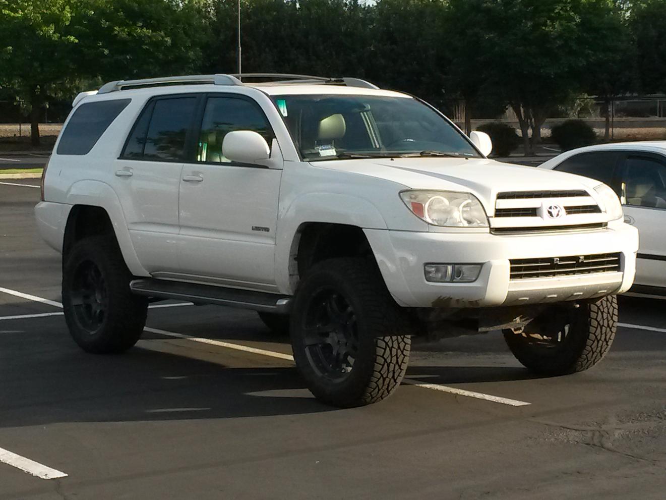

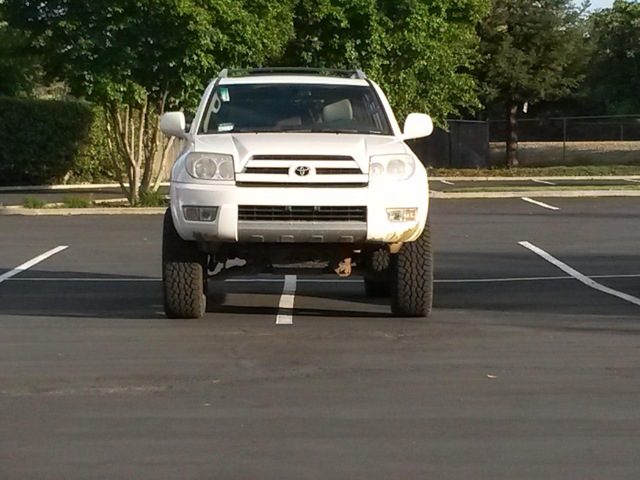

You seemed to get a lot more lift out of the rear springs then most. I was surprised to see your truck so level with the 1.75 setting up front and nothing extra out back. I think most people would end up with negative rack with that setup. IMO, Fulltiltboogie's ride has a little bit of negative rack.
I agree I would expect to need an additional spacer to get truly level. I will be doing 1" in a week or two here to get a slightly positive rake.

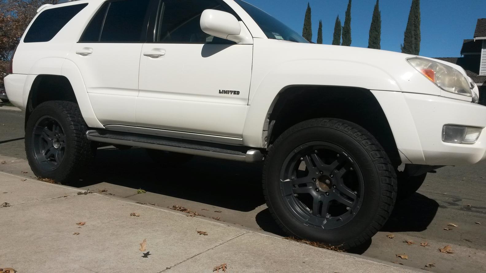

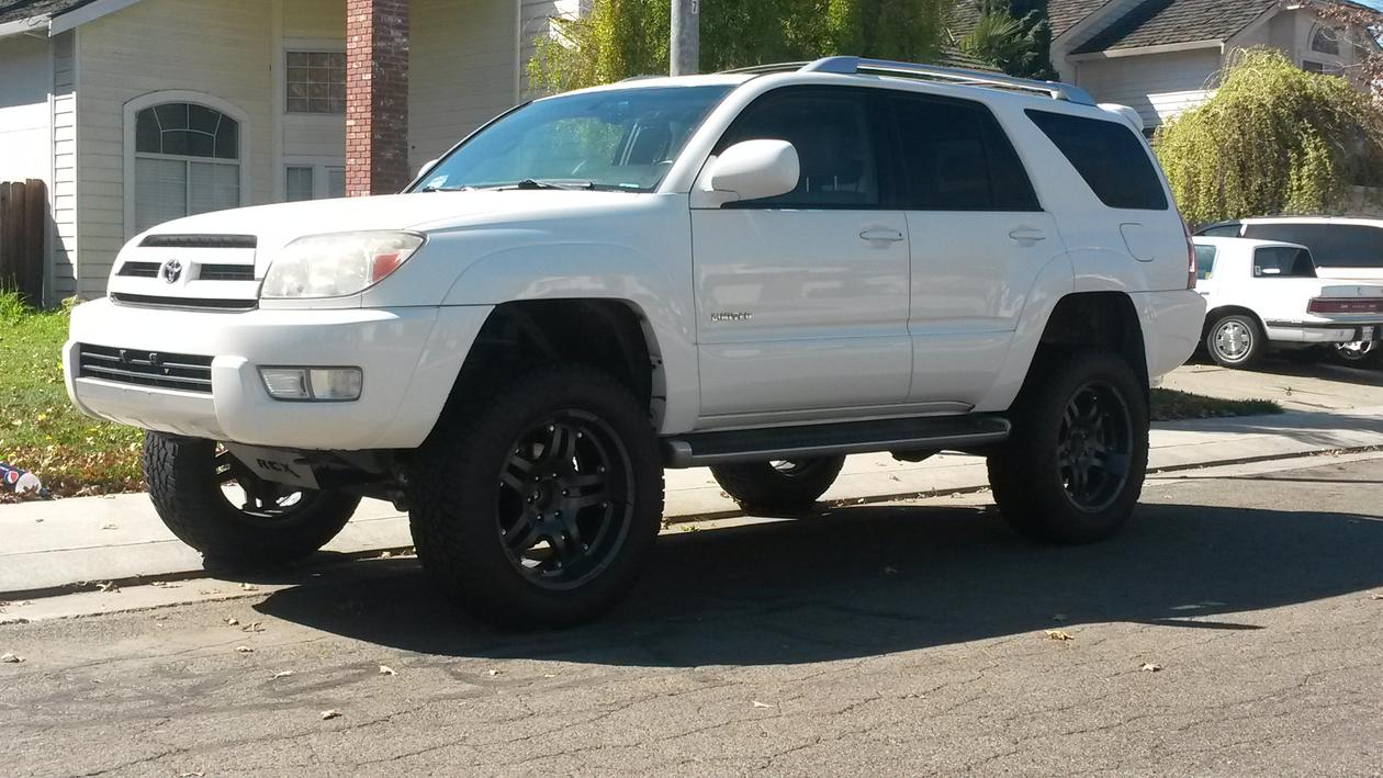

I know a few of us have been considering FJ springs\5100 combo with the front set to 1.75 and a 1" spacer in the rear but weren't sure how that would look? So I went through the tire & lift thread and found 2 examples of that exact combo...
First paweliania's ride (which is a V8 model)... http://www.toyota-4runner.org/4th-gen-t4rs/51742-lift-tire-central-pics-post-em-up-52.html#post1348723
and then theliman's (V6 model I believe)... http://www.toyota-4runner.org/4th-gen-t4rs/51742-lift-tire-central-pics-post-em-up-62.html#post1498074
I PM'ed theliman and asked him about the settling and he informed me it settled perfectly and provided me with this updated pic...
20131118_130121_zps992e0f54.jpg~original
He also informed me that with the 265/70-17 tires and spridertrax, he did have a little bit of rubbing up from but that moving the inner liner forward resolved it.
I think that looks pretty close to perfect for my needs so I think that's the way I'm going. Already have the springs, just have to order the billies and find a 1" spacer for the rear

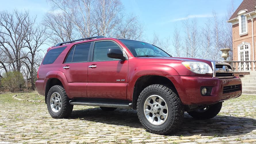

FJ Lift Installed! 2007 SR5 V8! Salsa Red
Picked up this 2007 SR5 4runner last week with 92,000. FJ lift is now installed and I am loving it. 5100's at 2.5" in the front with 2014 FJ Springs (used springs but only 4000 miles). Rear has 5100's with 1.5" Daystar Spacer. Sits really nice, rides great. Not overly huge which was a concern I had.
Wheels are used FJ Wheels with 255/75/17 Cooper Discoverer ST Maxx.
Just and FYI and something I had a hard time finding when I was searching the forum prior to lifting. All the FJ strut parts are interchangeable with the 4th gen 4runners (Top Plate, Rubber, etc). I wanted to use the newer pieces from the front FJ struts I bought (seller did not want to disasseble and just give me the springs so I paid an extra $20 for the full struts with all components). They all fit perfectly.
Super happy with the Results!
